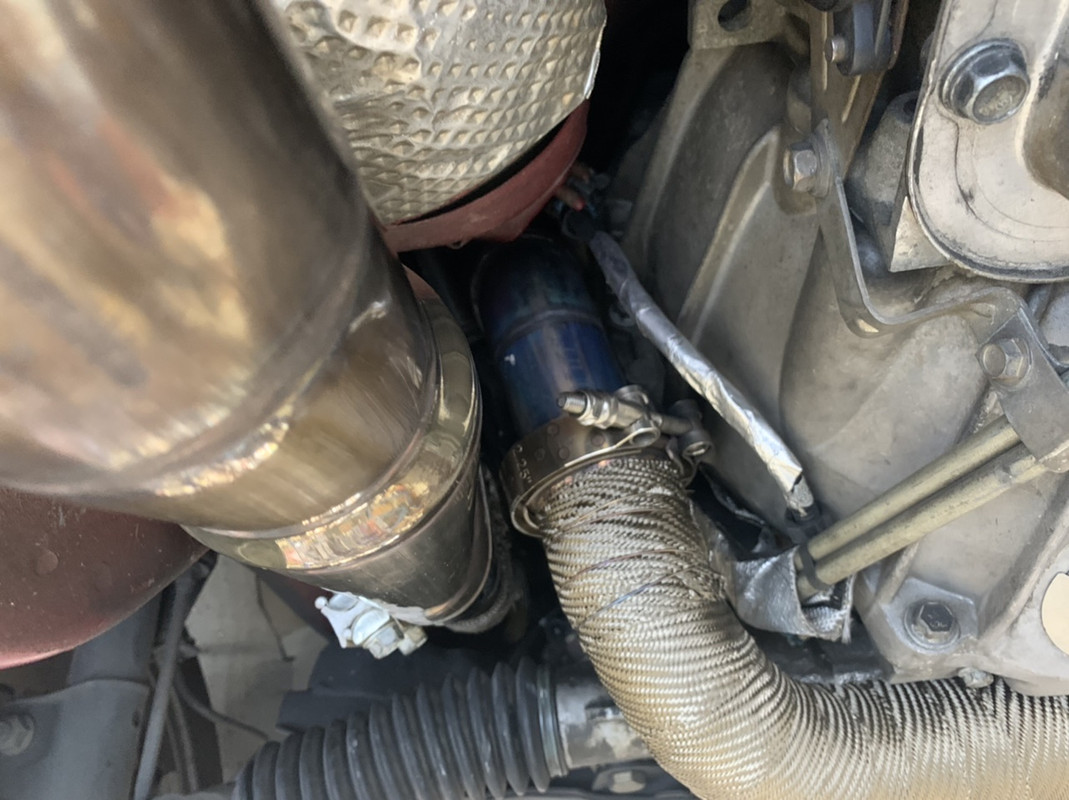

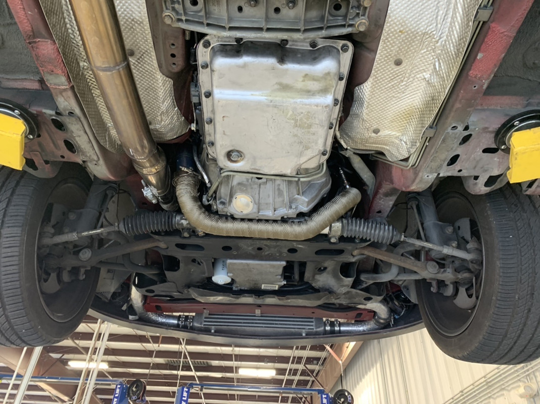

I have no slip joint in mine. V band on one side, factory ball socket joint on the other. Two flex joints broke in short order. I eliminated flex joints and never looked back. I've had no problems since and i've removed the whole thing and put it back on with no issues. I took it off last weekend to wrap it and it wenr back one no issues. I dont think id use a slip joint because I wouldnt want to have a leak and lose boost potential.

Like dis....took these just for you Doug

I think some people over think things. I did when I put a flex joint in. Listening to the internets. Then I found out for myself that **** don’t hold up. That **** didn’t last a month. Now with the solid crossover it’s been on there over a year. And I drive this car a lot. I took the crossover off last weekend and wrapped it. No cracks no stress. Nothing.
ive removed my hot side And inspected it. I used 1/8 sch40 stainless. Looked perfect. I think people have cracking problems when they place components in the wrong places and makes it have more stress that it normally would. Maybe in the future I’ll have a problem, if I do, I have a welding machine. I said that when I built it. And the only problems I had were the flex breaking and a v band clamp breaking. The V band breaking was my own lazy/rushing fault. I positioned the joint too close to the block and the v band wouldn’t seat on the flange correctly. I moved it and now it’s good.
