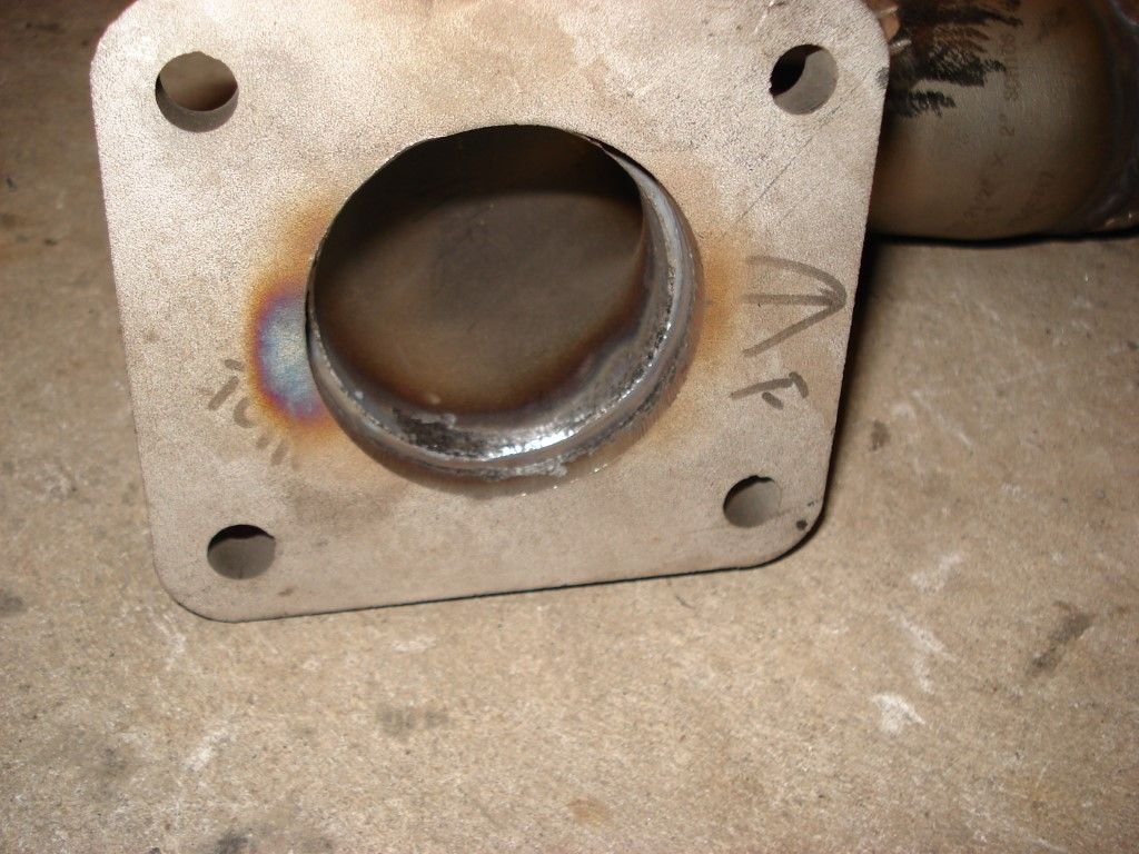

Yup, hotside is all SCH10 stuff, got tired of my old hotside being too low and too cluttered.
Lots of this stuff
