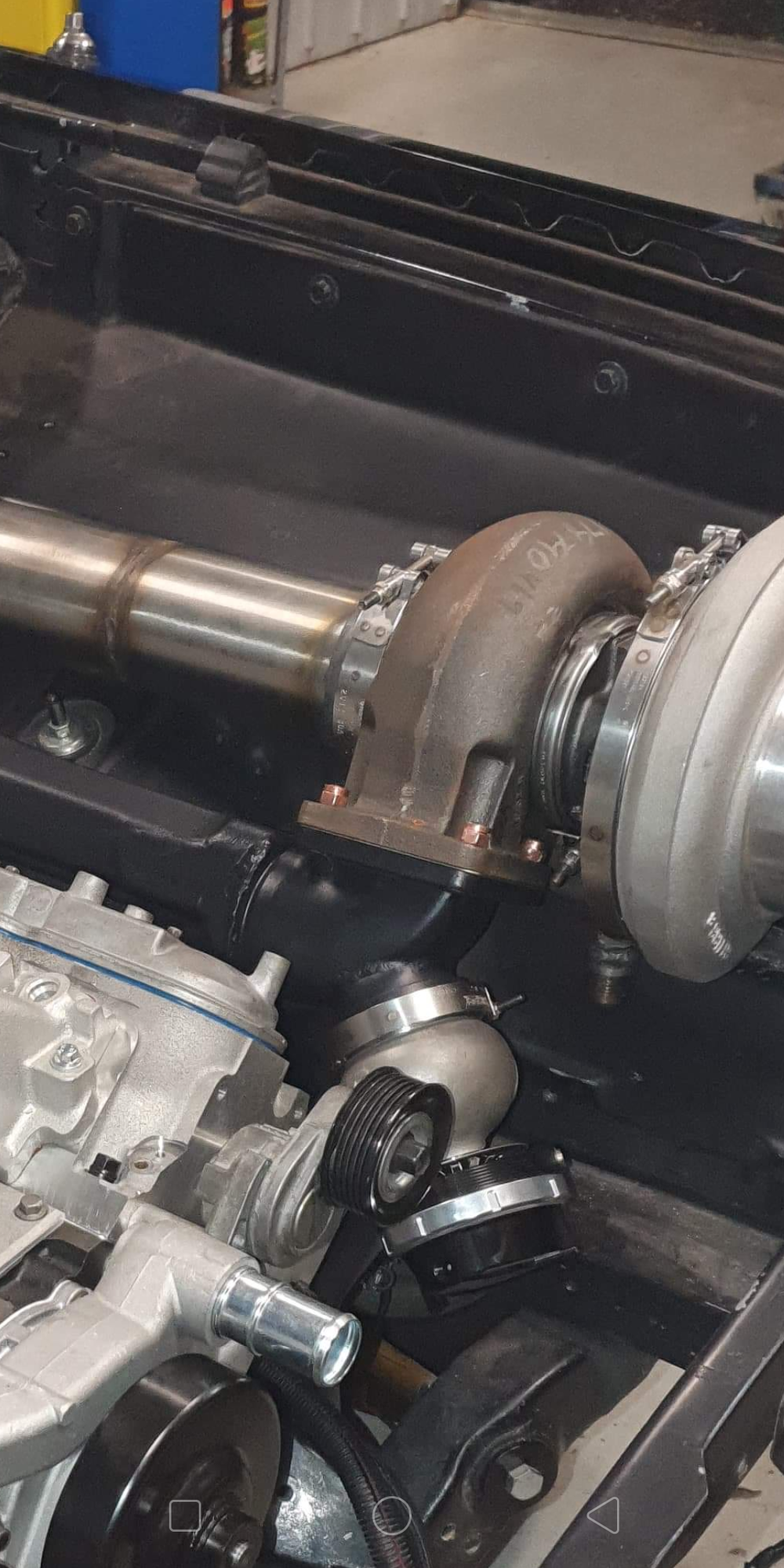

Old Jul 7, 2020 | 04:36 PM
lscamaro234's Avatar
Joined: Feb 2019
Posts: 157
Shows gate etc

You have the fire ring in right?
Old Jul 7, 2020 | 05:00 PM
Joined: Feb 2019
Posts: 157
Just a guess but is that the ring around the valve in the wastegate ? Then yes
Old Jul 7, 2020 | 05:19 PM
ddnspider's Avatar
Posts: 14,628
Likes: 1,778
From: FL
Correct.

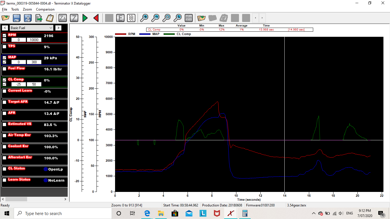

Ok so I have plugged the BOV , and ran gate direct to manifold.
@ 5800rpm
9psi boost gauge
ecu measured 9.4 on my data log
11.0afr
19* time
looks like it fell off but could just be a delay after taking foot off pedal..
I put some eboost control into that 30/100 to the solenoid and got 9.1psi on the gauge
Old Jul 8, 2020 | 05:43 AM
Joined: Feb 2019
Posts: 157
would this def be the problem ?
