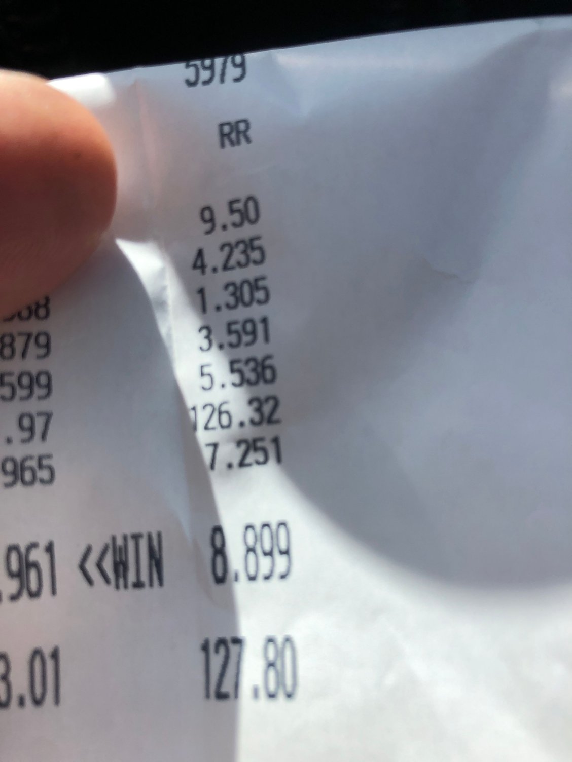

Went a new PR on mtn .. bandimere speedway 7500-8000 DA..
engine combo 4.8 stock block and crank aftermarket piston and rods , stock 863 heads not ported with spring upgrade, ls2 intake, cast 76mm and air to air ..
car is 1980 zephyr complete stock suspension no coil overs .. 3430 lbs on a 235 radial. Set up for 1/8 mile I run limited 235.
here is slip from the day and vIdeo from the race a month before.

Nice runs! And on a 235, impressive. When you say stock suspension, how stock? Aftermarket arms? Tubular K? Adjustable control arm mounts? Sure doesn't leave like a stocker, lol

has after market control arms all stock mounting points .. after market single
adjustable front struts .. double Adjustable rear shocks .. but no coil overs in rear . Springs still on the control arms in rear . Tubular K member .

Works great! Got to the mid 1.50's 60 foot on completely stock suspension before problems started. The adjustability of the shocks/struts looks like it helps. Well done.

im taking to Vegas next month for SCSN hope to go low 1.20s 60’ same chassis and tire just on that stickyickie and 5000’ better air

That sir is very impressive
