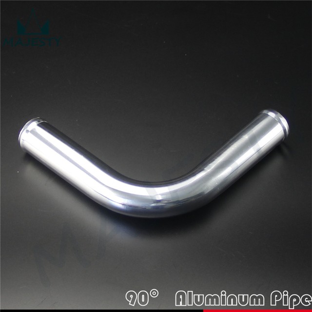

Why not just get a aluminum 90 and just weld the 90 on the end of the radiator outlet then hook the hose to that. Seems like it would be easier then re-engineering a whole hose or chancing a wrap fix.

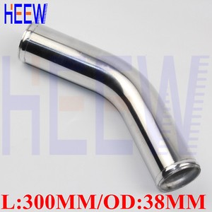

Can you buy a 6-12" piece and clamp it in place wher eit passes by the turbo? Something like this? I thought the ID was 1.5? Look up 38mm alum bends on ebay. Tons of options.
