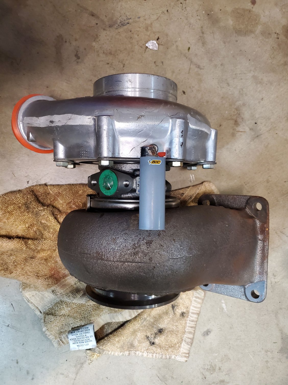

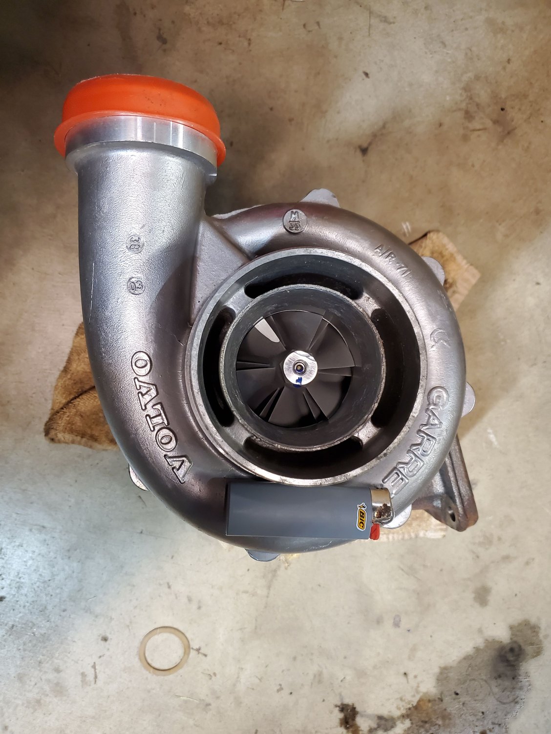

That is a werid turbo. It appears to be off a diesel truck. That is a big exhaust housing but the actual turbine wheel is small. What are you overall goals for power/ET, etc? It will spool well IMO and would be fun on the 5.3 in a street car. Probably make 700 rwhp but I think you will run into back pressure issue due to small turbine. The compressor wheel isn't anyhting special at all either. If you're looking for a fast spooling 700-750 max RWHP turbo I think it could get you there on 325". I wouldn't even attempt to put it on a 365" 6.0 personally.
If you're wanting a turbo to run on both a 5.3 and 6.0 that would not be my choice. I would get a VS or Borg S475 or S480 for that.

Thats what I figured but wanted to ask. Since my homemade hotside will have a t6 flange I can upgrade to a bigger turbo when the 6.0 gets built and goes in.
The turbo is for a 12 liter diesel Volvo. Its brand new though. Picked it up cheap.
I'm thinking 600hp to the wheels is going to be pushing traction issues with the t bucket. We'll find out. I've got 15x10" wheels for the rear, just need some good tires. The completed car will be between 1500-1800lbs.

Here's 2 pictures of my Wuhan War Whistle

I think you'll be fine. The later spool will give you a chance for traction. but if you do want faster spool you could look for a smaller 1.10 AR turbine housing off of a Detroit 60 11 liter engine or a t4 housing off of a Detroit 50 4 cylinder, they usually came in city busses. It was basically a 60 series with 2 cylinders cut off. They both ran gt4294 turbos in those so the turbine will fit easy. Gt42 turbine housings new are cost prohibitive. You could be a whole turbo for the price.

'd bet its around a 600hp turbo 5.3 or 6.0 doesn't matter. 75mm turbine is decent IMO. It will run out of compressor first.
Should spool fine IMO. Its like the small S475 with an a 65mm compressor. I'd use 2" piping from each manifold to a divided T6 flange. 38mm gate on each bank. Should be good to go!
1800lbs is light! My 27 T with a 200lb driver and ALUM 5.3 full of fluids oil etc will be about 2300lbs. That's with a uncut cab, 9" and glide.
