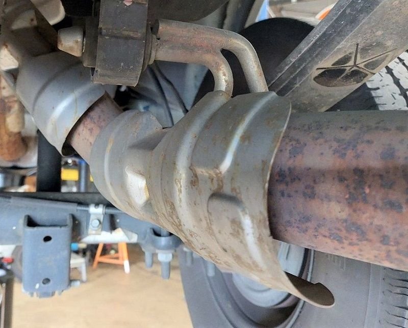

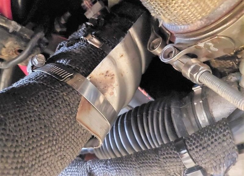

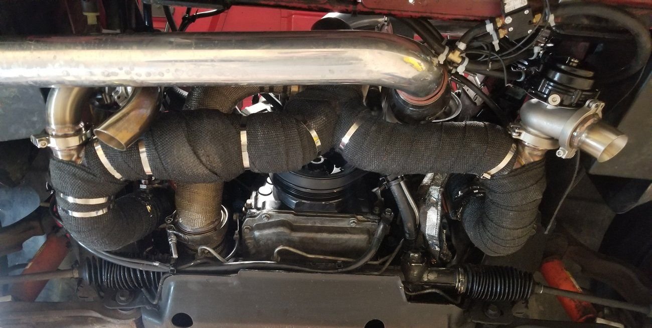

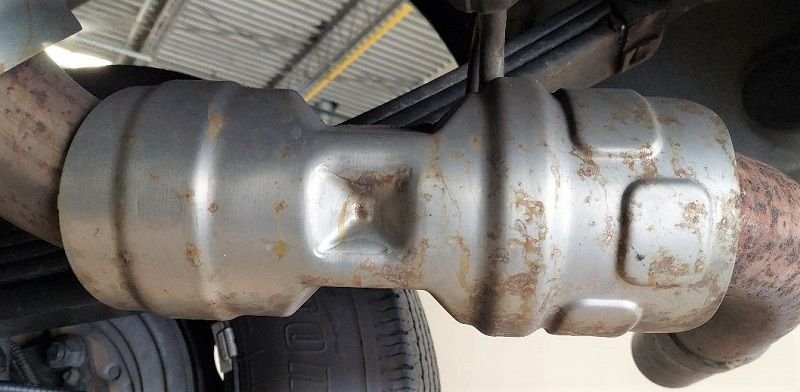

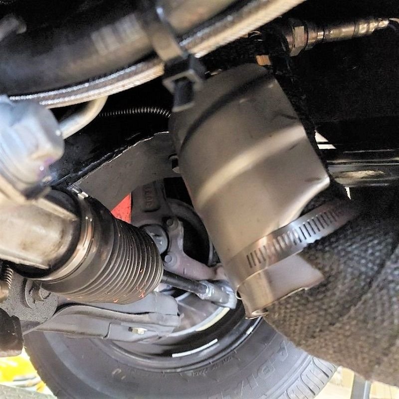

Just to update...
I am a fleet mechanic, and saw what I thought would make a perfect donor heat shield on one of our Chevy Express vans...
They are spot welded onto the tailpipe and I had one that had broken loose, in a spot that didn't really appear to do anything anyway, lol.
Removed it, cut it in half, and clamped one onto each of my downpipes, near my brand new steering rack's "bellows"...It looks like my downpipe, is still close enough to cause heat damage again, so still need to address that, either by converting to a downpipe "dump" further forward and away from the rack, or add another heat shield...
But should help a lot for now...
1st two pics are the heat shield still on the "donor".
3rd pic is driver side crossover, just below manifold flange.
4th pic is passenger side crossover, also just below the flange to pipe connection...
