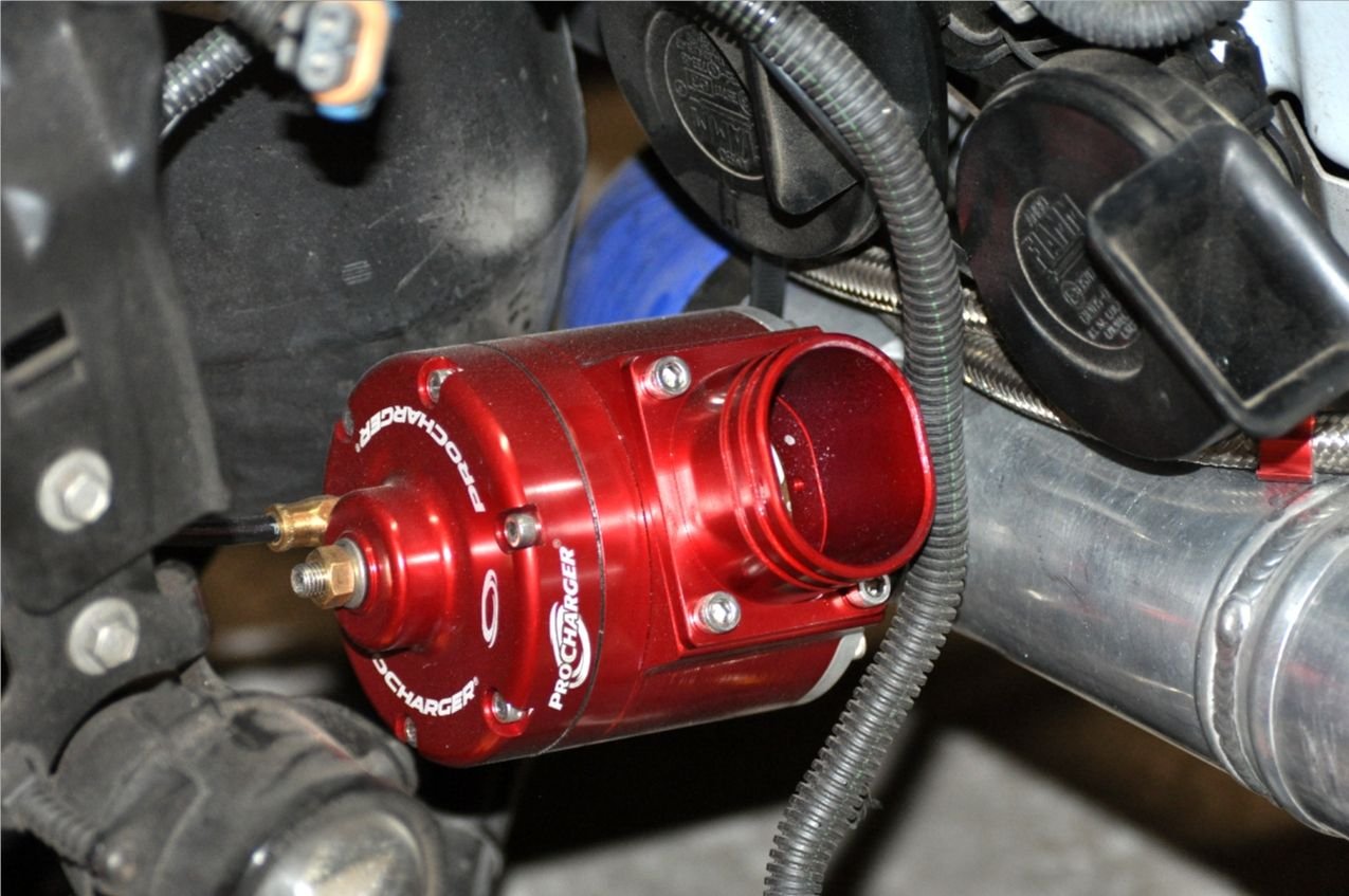

I agree on the extremely loud Big Red ATI race valve. I removed it and replaced with this one in link below. Can hardly hear it now. I thought I might have to add a hose to it and direct air backwards but didn't have to. Is quiet enough as is. Almost as quiet as the black bypass included with a D1SC kit.
https://shop.brutespeed.com/ATI-3FAS...-3FASS-003.htm
Current engine setup:
TSP LQ9 370 Iron Block. ARH 1 7/8 headers with ARH catted j pipe merged to single 3 inch pipe back to Magnaflow catback. ATI D1SC at 8 psi - 600 rwhp.
These two Magnaflow straight thru shorties aft of the Magnaflow muffler got rid of noisy annoying rasp.

I agree on the extremely loud Big Red ATI race valve. I removed it and replaced with this one in link below. Can hardly hear it now. I thought I might have to add a hose to it and direct air backwards but didn't have it. Is quiet enough as is. Almost as quiet as the black bypass included with a D1SC kit.
https://www.flickr.com/photos/183593...7623345499537/
Good info.
I was wondering if adding the enclosed bypass would be quiet by itself or if a hose would be needed.
Do you have any videos of your car? I'd like to hear what that sounds like.

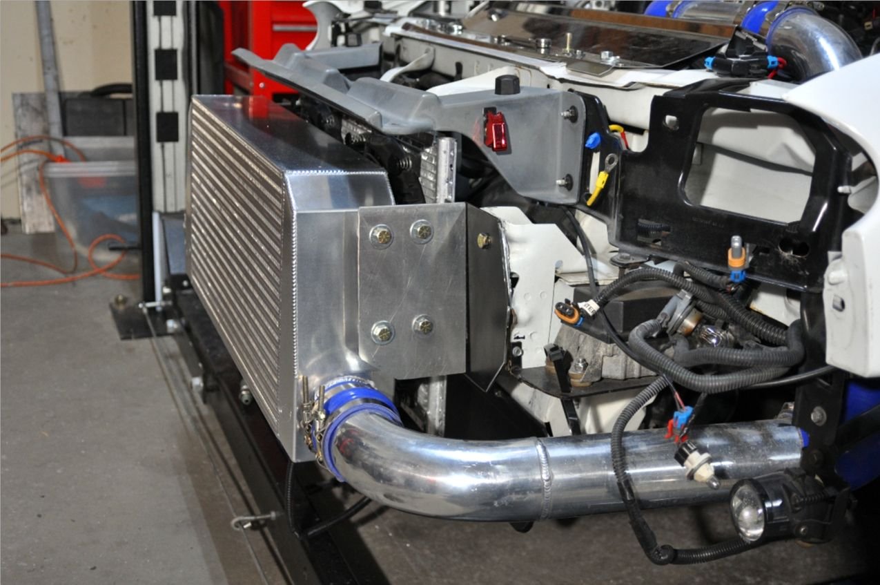

We were getting belt slip with a 7.65 crank pulley and 3.9 blower pulley so psi was only 8 lbs at 600 rwhp.
Since then have replaced 7.65 pulley with a CBR 8.65 crank pulley, moved idler pulley on Aster Bracket, and replaced Mishimoto 26 X 12 X 4 inch FMIC with the Camaro Procharger 26 X 12 X 4.5 inch intercooler (see pic below). Also removed two silicone connectors in the charge pipes with welded connections for better flow and less restriction.
I have no doubt that the ATI intercooler will add more boost and is more efficient than the Mishimoto intercooler. The larger crank pulley should reduce belt slip and also increase blower rpm and boost and still be under max D1SC impeller rpm with the 3.9 pulley. Still running the Gates green belt with plans to switch to the Gates RPM blower belt when I finalize pulley size and belt length with the green belt.
Will be interesting to see the results. I'm thinking boost will be somewhere between 8 to 12 lbs.
Goes on the dyno next week. Will report results for the OP when running with cats, a single I pipe and Magnaflow catback. Will get some videos while on the dyno.
Dyno operator and tuner is still the same (Dynojet Eddy Current Load Control two-wheel dynamometer - similar to a Mustang Dyno). So will be an apples to apples comparison when dynoed previously.
ATI Procharger intercooler with AC condenser relocated off the face of the radiator (still run AC and was getting 34 degree at each dash outlet last week with ambient temps at 102 F).
Note: I'm not looking for max rwhp - another 50 to 75 RWHP is enough. Car drives nice with a Yank 3450 blower converter, Performabilt level III 4l60E tranny with 3.23 gears.
