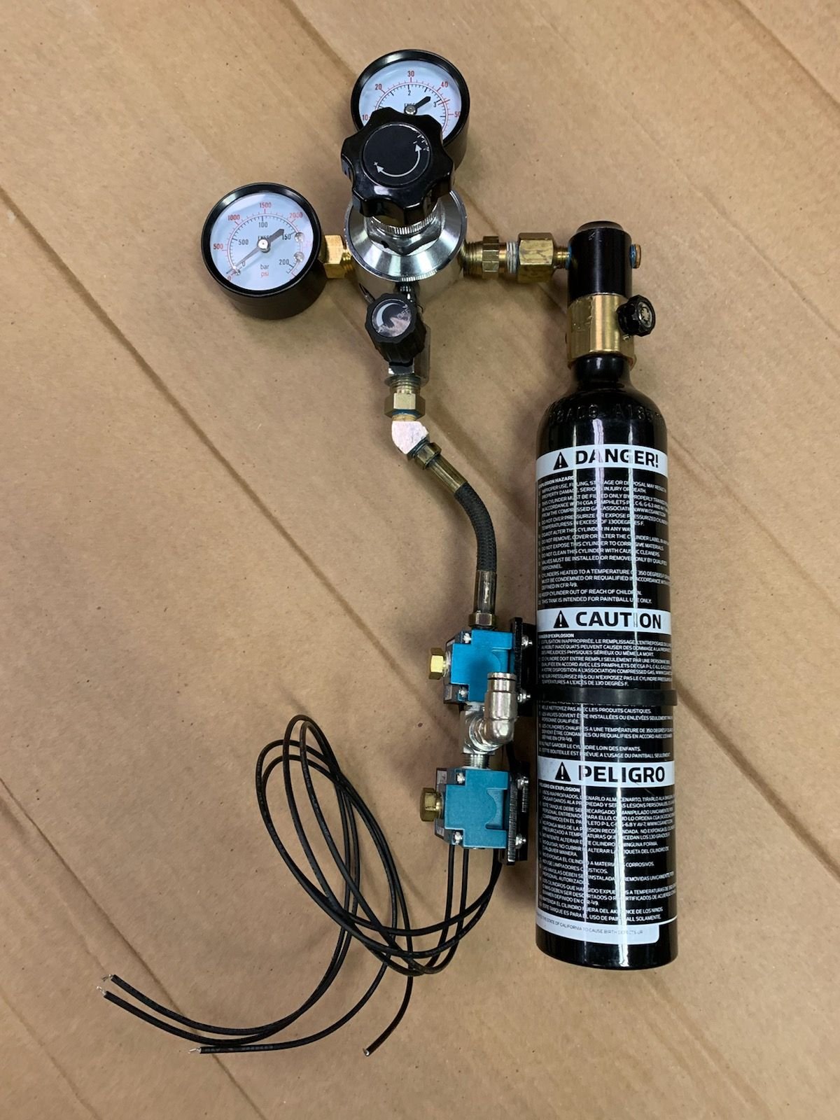

Old Dec 18, 2021 | 03:06 PM
Bad Apache's Avatar
Joined: Sep 2013
Posts: 993
Likes: 119
From: Mechanicsburg, PA
Voila, CO2 set-up!
Old Dec 18, 2021 | 11:57 PM
Bad Apache's Avatar
Joined: Sep 2013
Posts: 993
Likes: 119
For anyone interested. We used a 9 ounce paintball CO2 bottle, beer keg regular (slightly modified), a pair of MAC 3 port valves and an S bracket. I’ll weigh it full and let you know.
