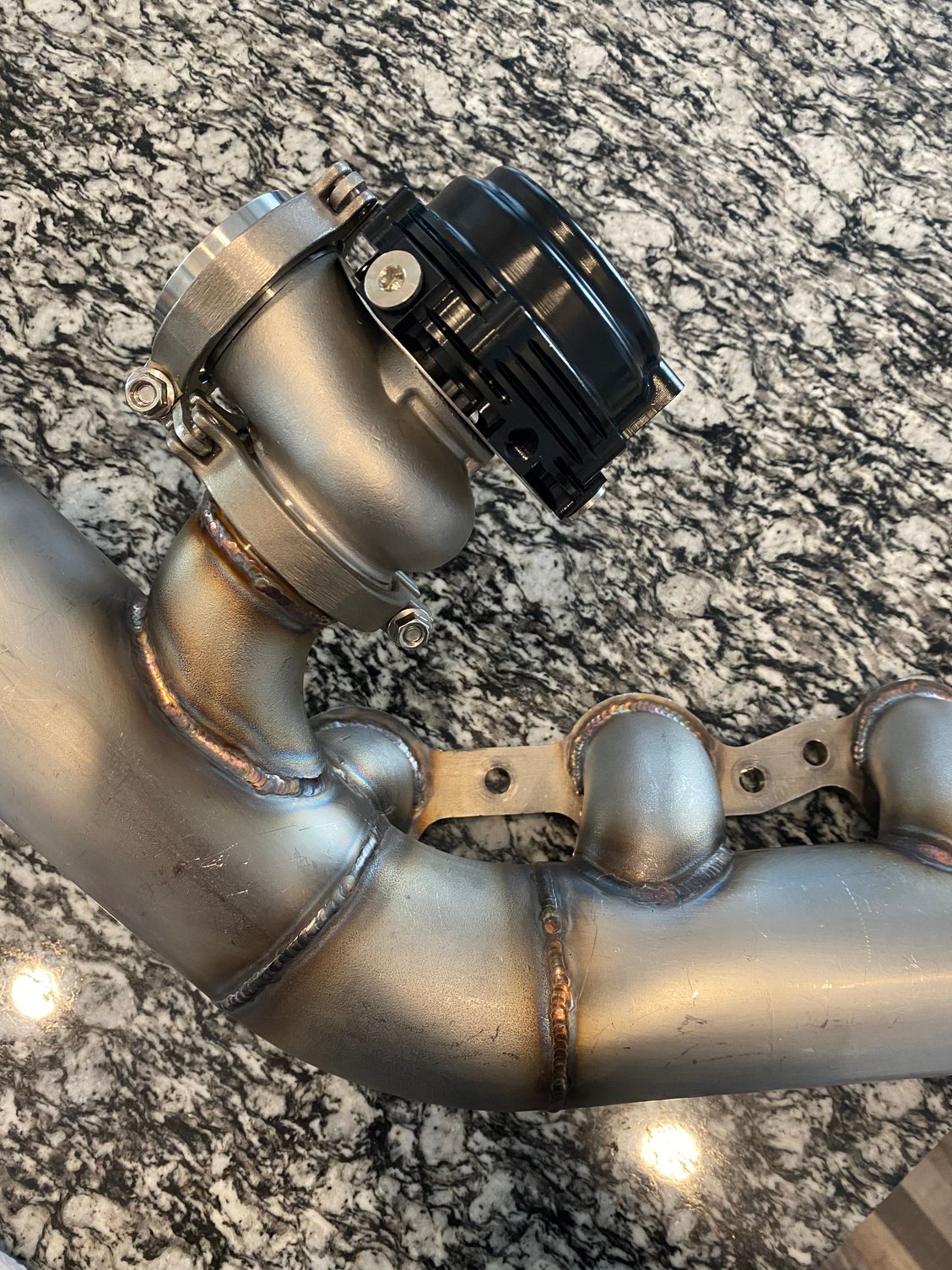

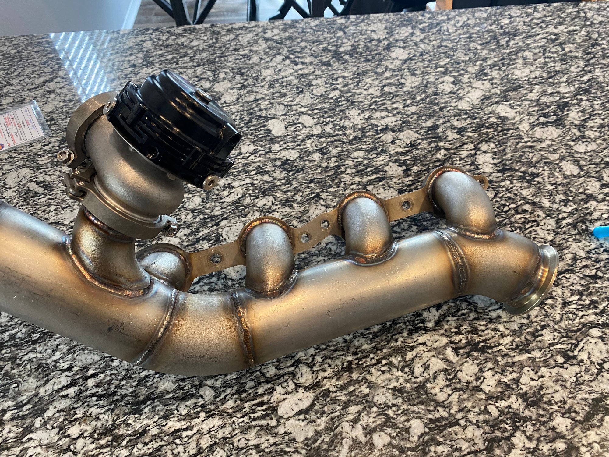

I just built a turbo manifold for my old C10. I’m concerned about where I placed my wastegate. Check out the pictures and let know if you think it might be ok?

Tell me what you think.. Is the wastegate in a terrible location or am I overthinking it?

Although not perfect it isn't bad either. Looks acceptable to me. Depends on how low you are trying to get the boost.

Run it and see but I suspect that you may have a problem keeping boost down , not any priority to flow through the gate as it's on the inside of a turn . Set up some safeties in the tune in case it goes way over intended levels

I would recommend that you rig something up to bench test the gate - low pressure regulator and gauge . That way you know the gate works and approximately what pressure it opens at instead of going by a springs rating. Usually going to yield a lower boost # than the bench test value because of back pressure. Start with the lightest spring you have and see if you can control boost at that level before you put more spring in it. Don't have to have a controller if you're able to get the # you want and don't need or want to be able to change on the fly . Many using the aem - me too , can have 3 levels , gate only , a , b, and scramble ( button or switch activation) are you planning on tuning it yourself?
