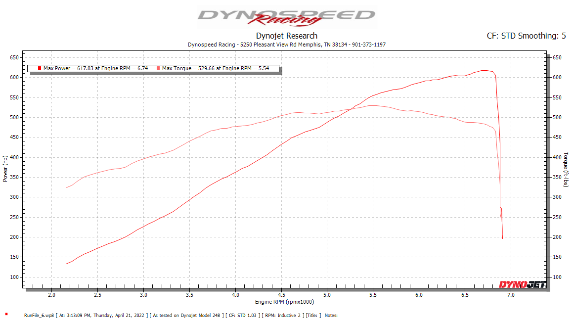

Long time member, but been a long time since I was active. Black WS6 got stolen, so I replaced it by buying someone's project in need of resurrection. Previous owner built the 02 WS6 to be a high compression all-motor beast, then added a D1SC and Meth. The setup was all wrong for the blower, he didn't have forged internals, and was only able to run 4 or 5 pounds of boost, even with 100% meth. I got the car cheap, 7 and 8 pistons were trashed. I sent it back to the same guys that built it the first time for forged internals and run through the car. I got it back from them in October, did all the required break-in procedures and mileage, and had the final dyno tune done last week. 617 RWHP / 530 TQ. Peak HP was at 6700, 9 pounds of boost at almost 7K RPM. Honestly, i was hoping to see 700 HP. The tuner says I can get 700 with just a little more boost, but, to get more boost I will need to upgrade the fuel pump again. Injectors were only at 60% duty cycle on the dyno runs.

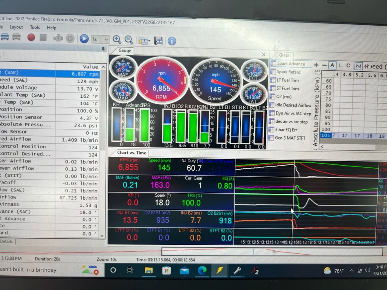

do you have any logs of the fuel pressure?
Old Apr 27, 2022 | 01:31 PM
rncotton's Avatar
Joined: Oct 2002
Posts: 70
From: Memphis, TN
This is literally the only thing I got besides a dynograph of one pull, and the invoice.

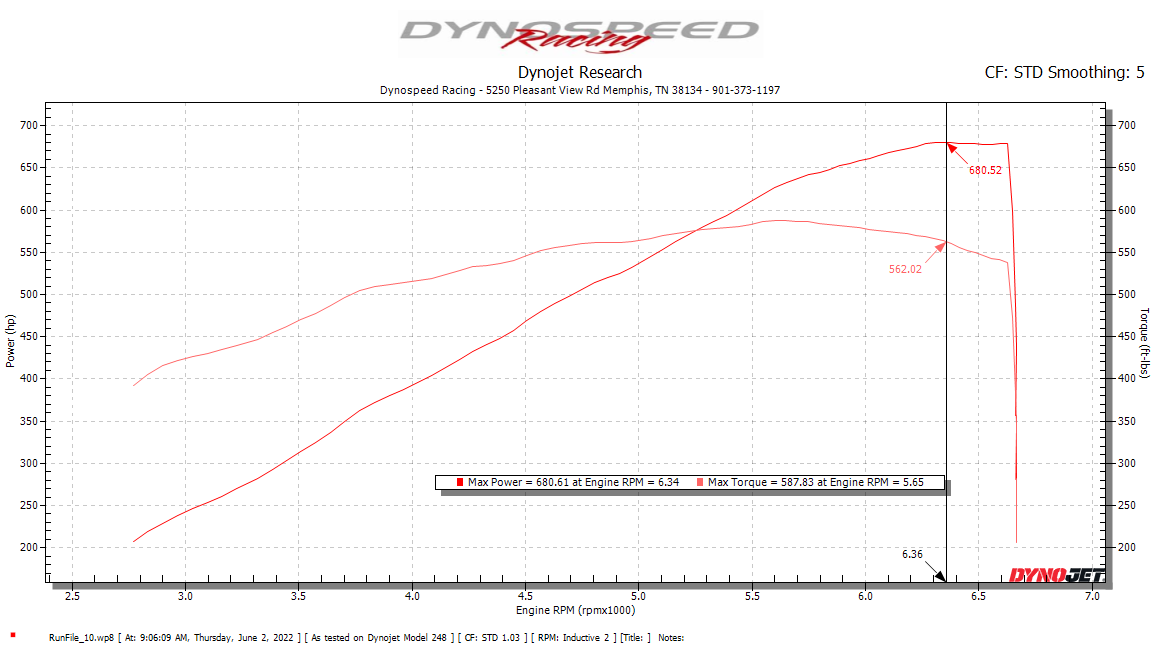

Well if anyone was playing along at home, the fuel pump died the first day I drove it. It's been replaced with a 340 and a hotwire kit. My tuner says 340 is as large as I can go with the stock fuel lines. With a little more fuel now, we also changed the pulley on the blower for just a little more boost, and and swapped over to the updated inlet on the D1SC. End result, 680 RWHP, 588 TQ. (in 100 degree Memphis heat) I'm gonna call it done. It's very mild and streetable. But the power is there if you want it.
