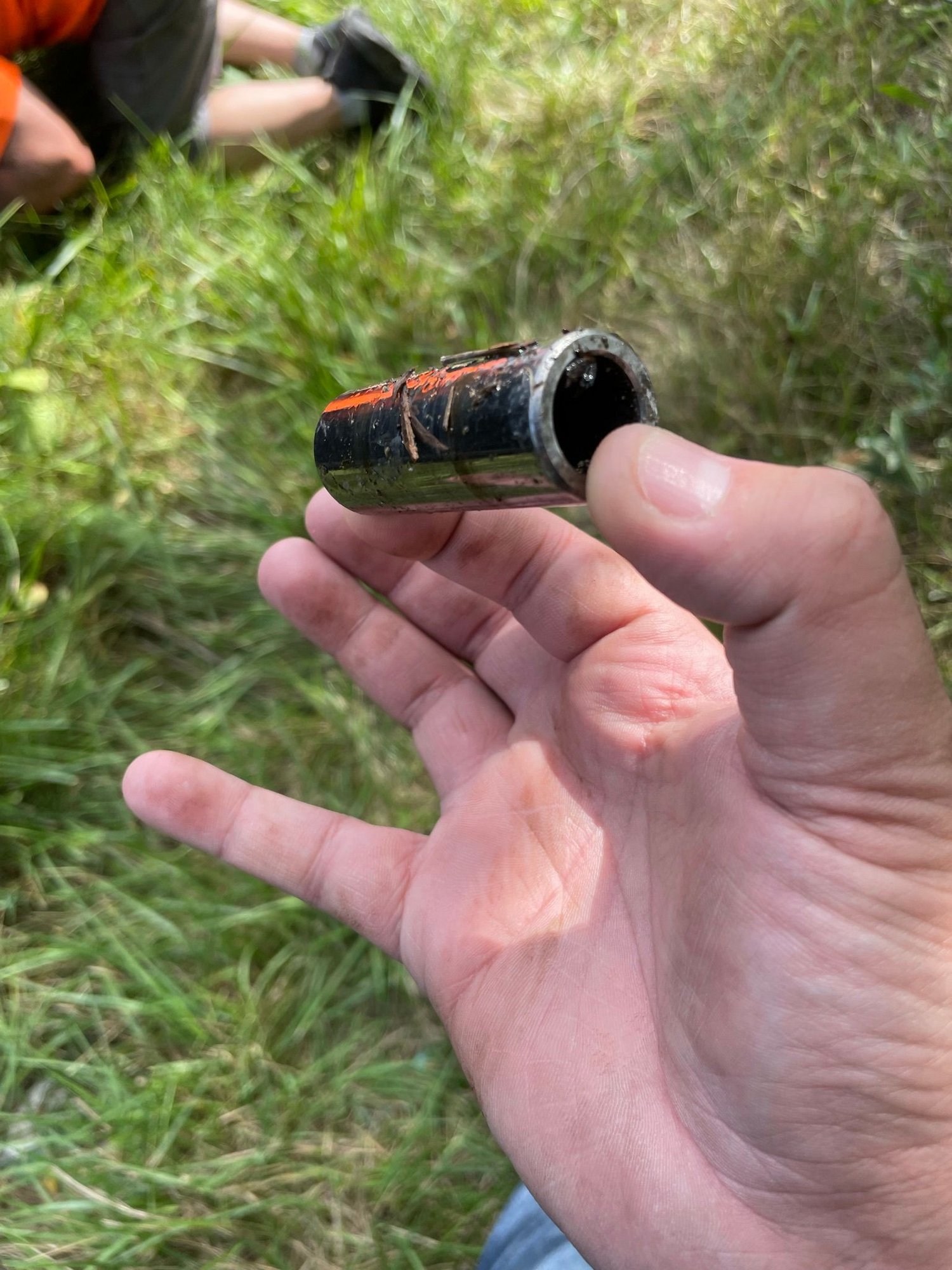

no no... rod went through the stock block, followed by the wrist pin. Carnage everywhere. Quite an awesome experience....
