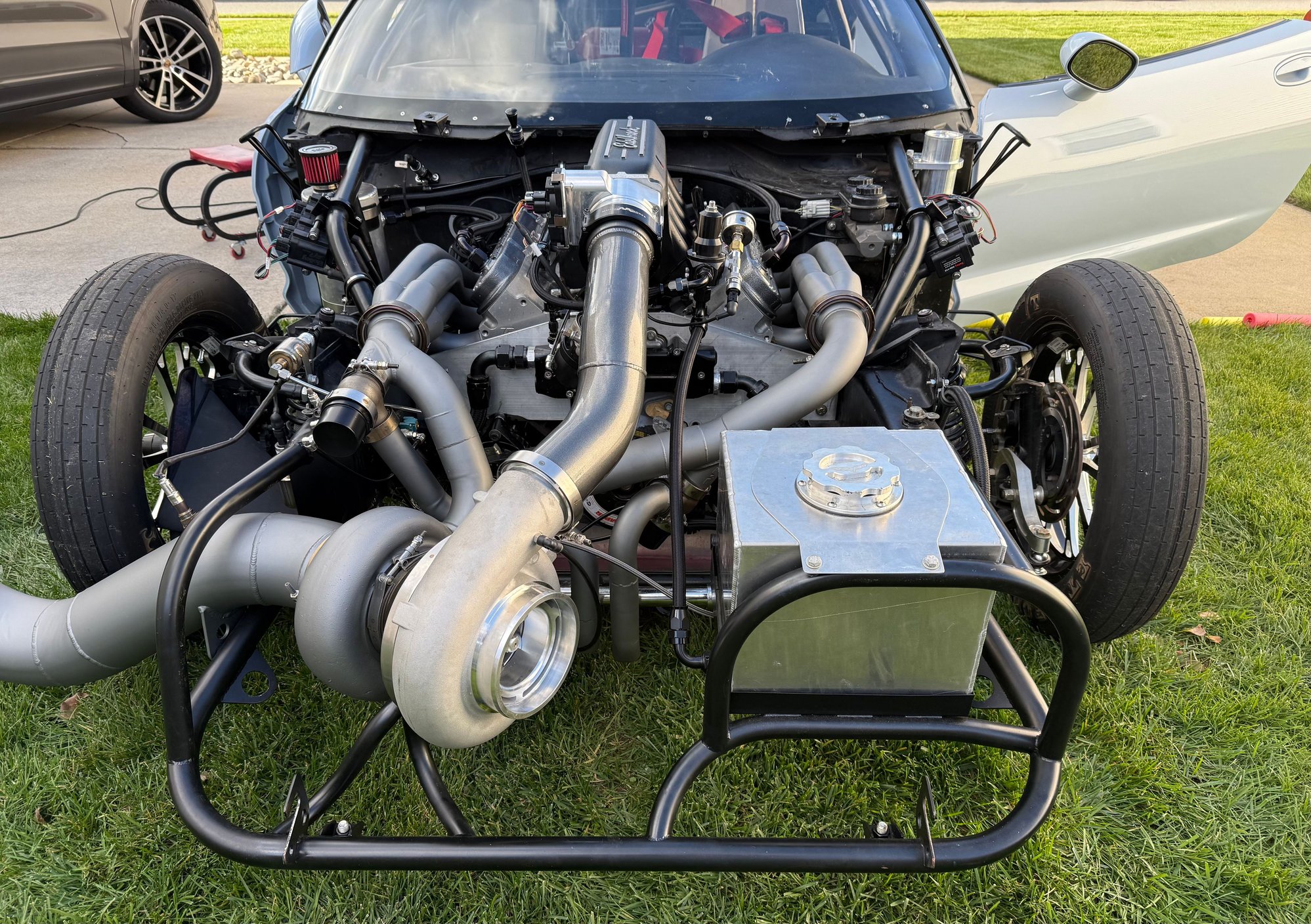

Winter works completed…. I re-wired a bunch of stuff, as it all looked like **** behind the dash…
Quick recap
370” iron block
TFS 245 heads
GT55 94/102 turbo
Ignite Red E90

Nice! How much boost? Just curious, I have the same turbo but it’s going on a 388 with br1 heads
Old Apr 1, 2026 | 04:41 PM
  #219
C5_Pete's Avatar
Joined: Dec 2008
Posts: 981
Likes: 358
From: Washington TWP, NJ
Thanks!
27psi boost
25psi back pressure
14* timing
64% injector dc
Bosch 210 injectors
mechanical fuel pump with 55psi base pressure.
