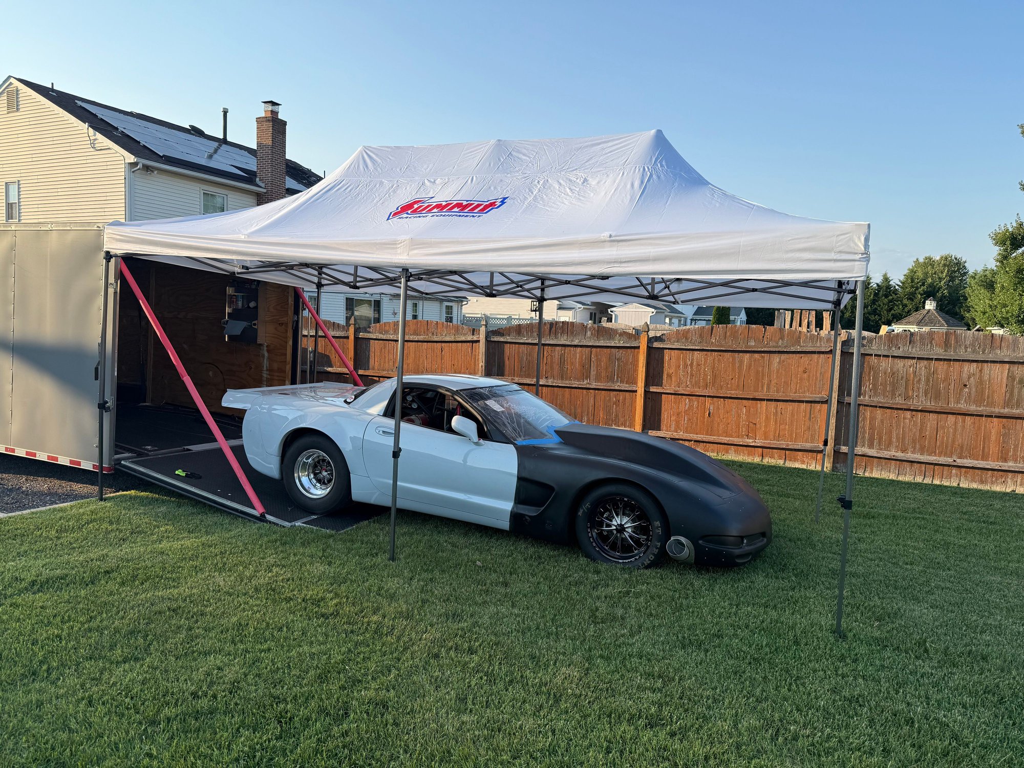

And, for those of you still interested in what I’ve got going on…
Got it back from the shop for some upgrades.

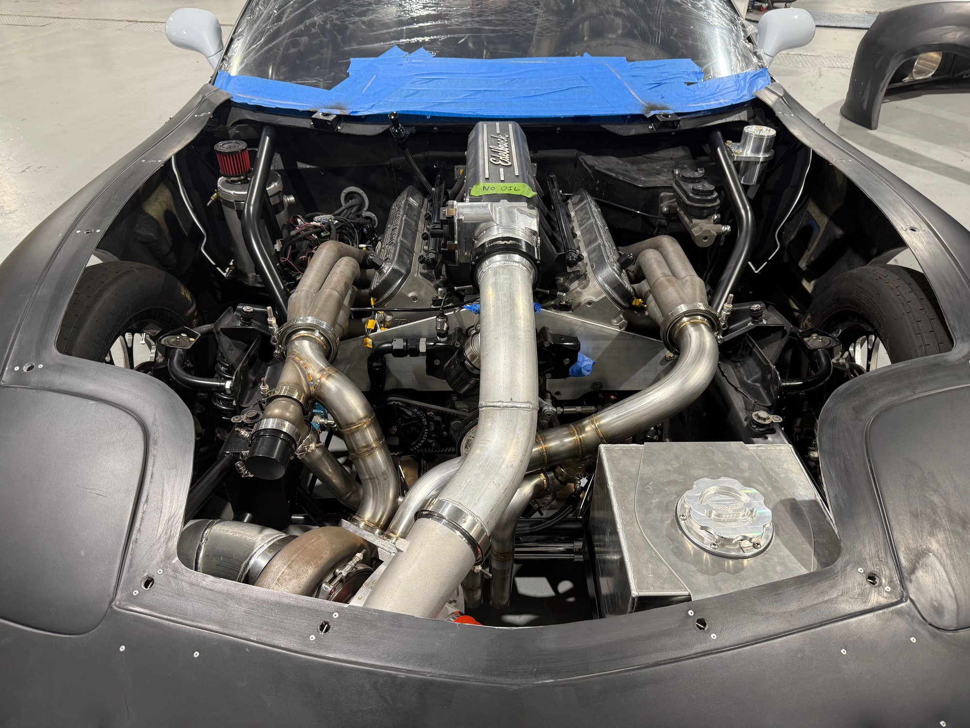

Made it to YellowBullet Nationals this past weekend.
Torched the head Q1. Got the block too.
time for a tear down and determine where to go from here.

20psi and 16* timing and it was a bit lean at 11.8 on the gas scale.
#7 cylinder burnt into the water jacket.
I don’t know why it made 20psi on a 8lb spring and no dome pressure. I didn’t expect it to make that much boost, so I wasn’t concerned with the timing map. When I checked the 2-step, it made 13psi at 5000rpm.
Also, I would think the CL compensation should have added fuel, yet it doesn’t appear that it did.
Oops..
370” engine. Ignite Red fuel. No intercooler. A 40mm JGS gate on each bank with good priority. 94/102 turbo.
Sure, in hindsight, I should have put it on a dyno and ensured the tune was good before sending it down track… but I didn’t.
I can disassemble the engine and get the block decked. The head is already at the shop for repair. If I keep this block, I’ll get new pistons to drop the CR to a more reasonable level, as it’s 13:1 now. (Originally built to be max effort).
All I want to do now is run 8.50 index. I can get a LC9 locally for $1000. Thinking of getting that and lose 100lbs.
I’ll figure something out within a week. No rush.
