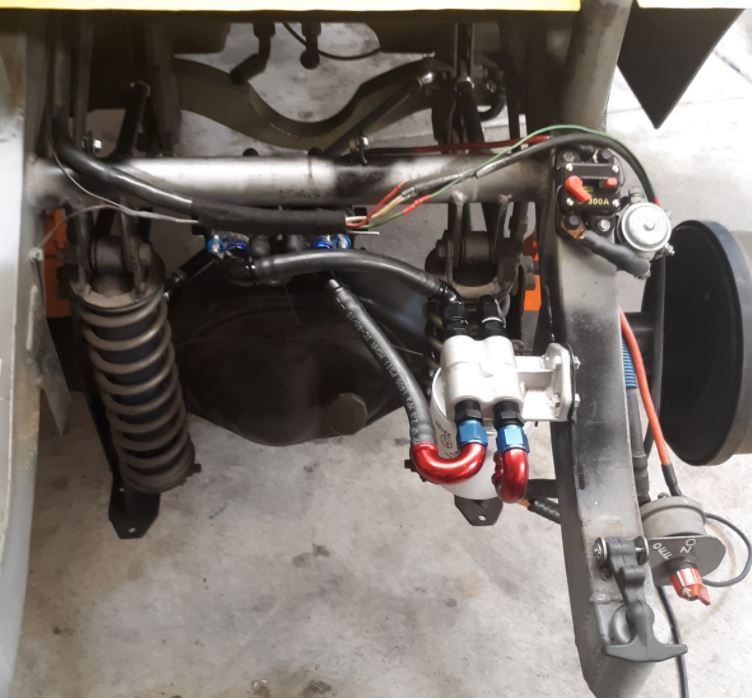

This is the WIX unit I used on my last build. 2 AEM400's feeding it then the two outlets to the regulator and a single out from the regulator to the rail.

sounds simple and efficient. i like it! where did you get the dual inlet/outlet for the filter? only one im seeing is single in/out.

this looks like it.
https://a.co/d/23MEz5o
Yes they make socks. but the AEM has filters on the inlet side anyway
