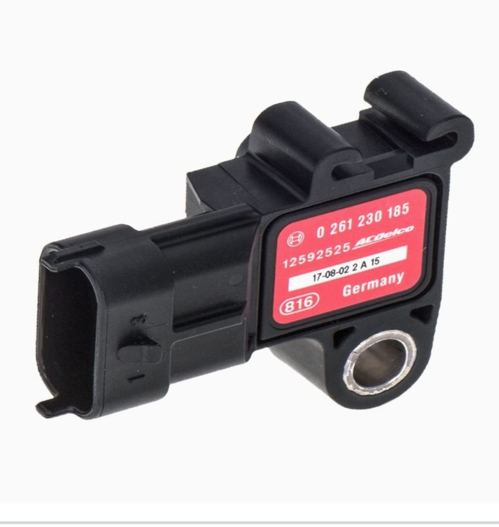

my tuner is will take care of all that for me. I'll just install all the parts and then bring it to him and he builds vehicles too and knows my truck pretty well so when I drop it off I always tell him if something needs to be changed or added to go ahead and do it. Now im trying to figure out what map sensor to get. This one should work right?

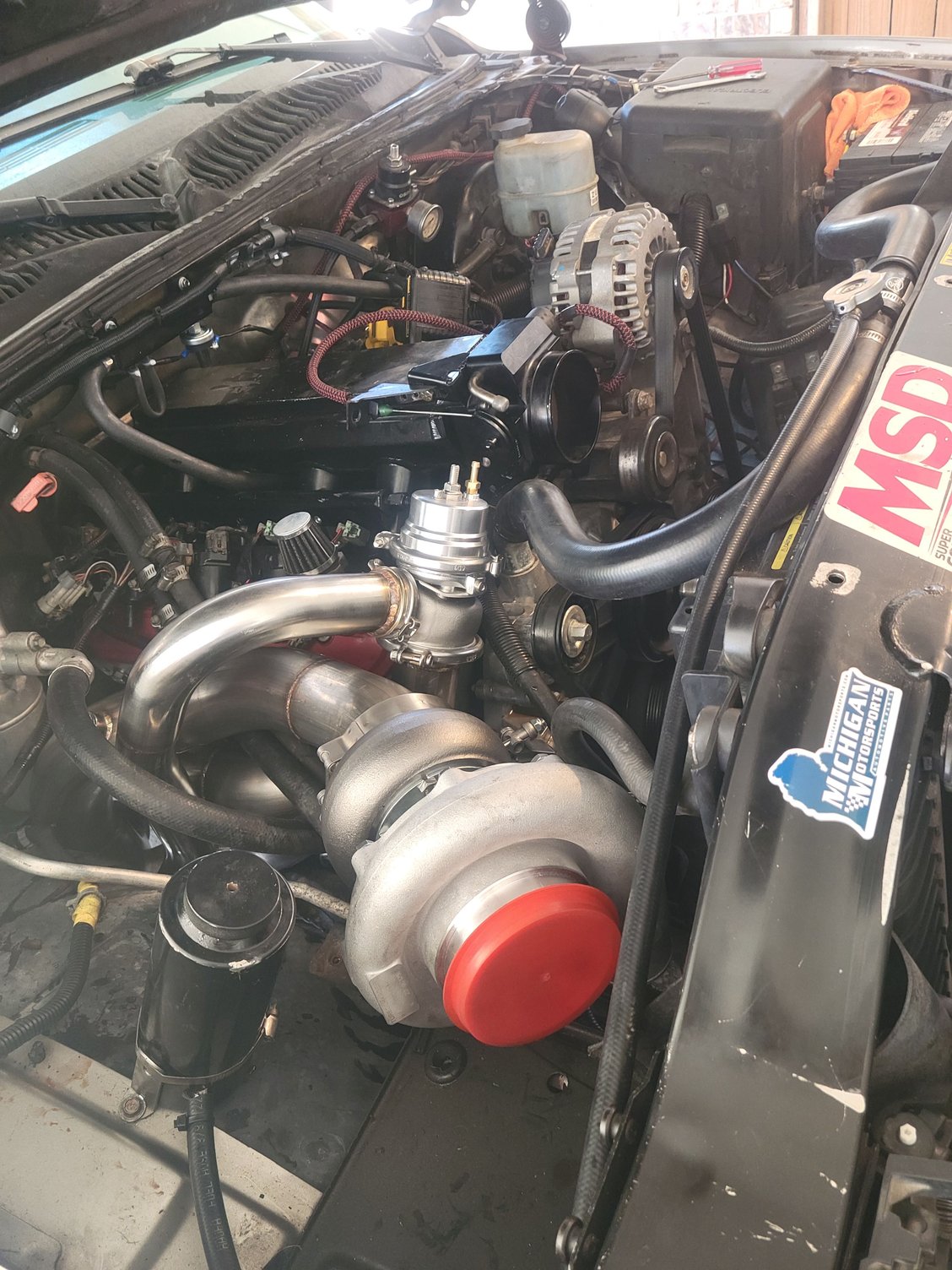

Going together fairly easy

Nice .

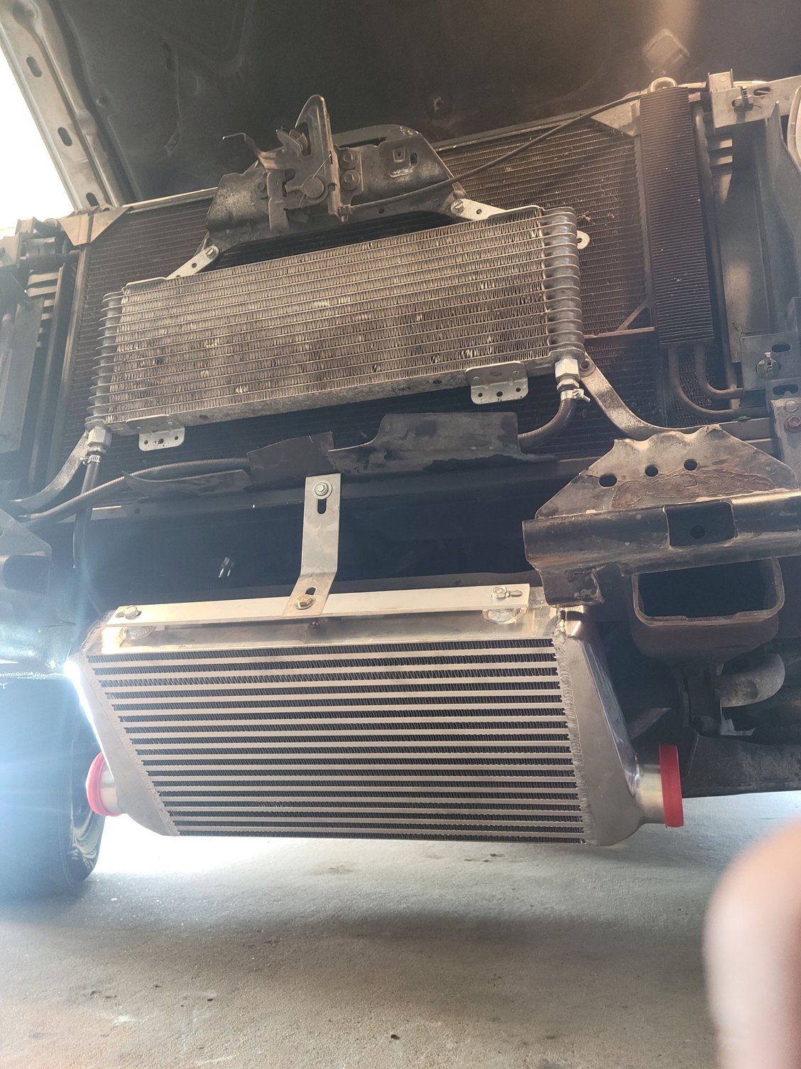

Weird place for the intercooler but its on, the only issue ive come across so far is bolts missing from the kit. Luckily i have plenty bolts laying around

And this is street driven?

most definitely, why what you got to say man?

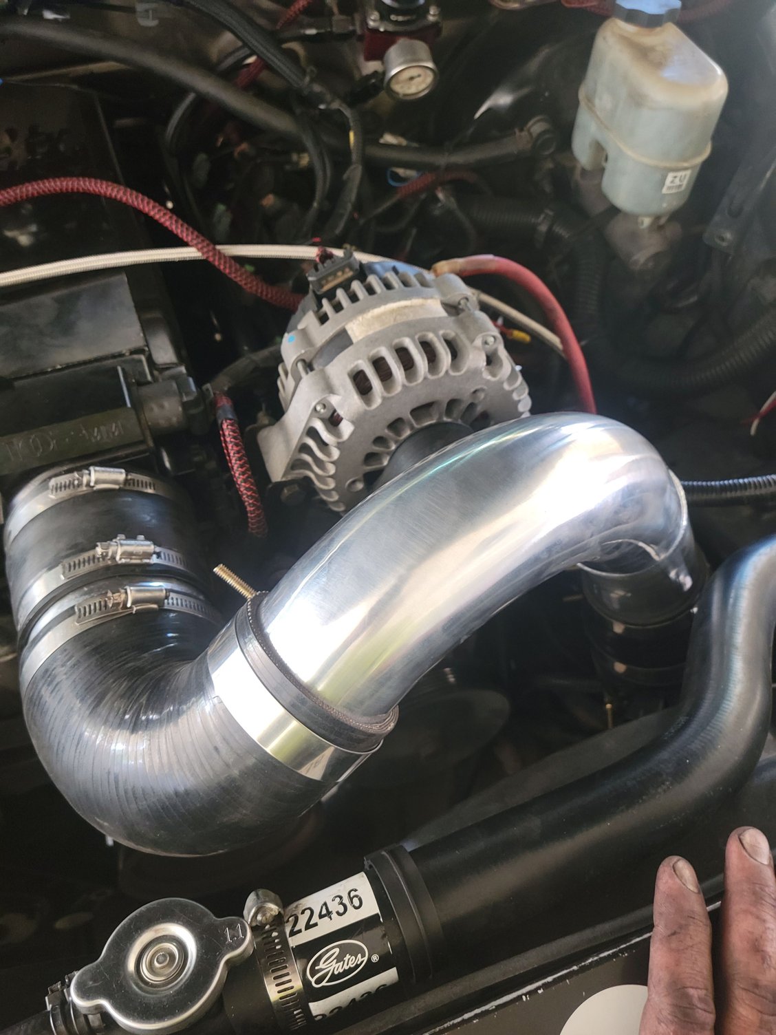

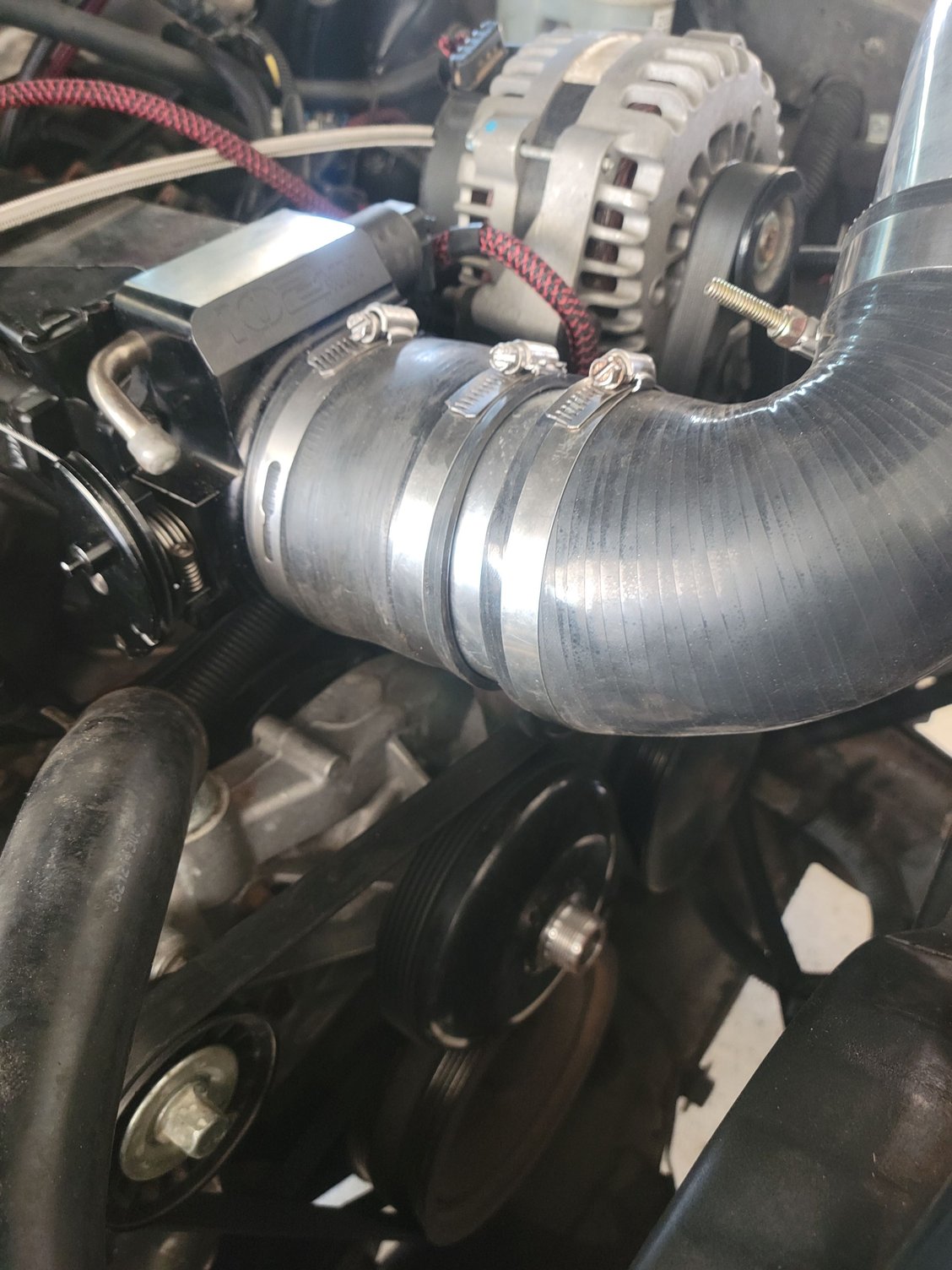

Had to put an extension piece right here because the piping was hitting to alternator. I made it work tho, i cut a piece out my old intake

Question Am wondering..
If instead of the cooler being close to the road and subjected to road debris hitting it, if it could be put in place of the trans cooler.
A set of hood pins in place of the latch, would open up enough space to put it there.
Old Aug 19, 2023 | 01:51 PM
  #78
Tommy42088's Avatar
Joined: Oct 2022
Posts: 1,776
Likes: 627
From: Louisiana
it's about 8 inches from the ground, the picture kind of fools your eyes a little. The lower control arms are 8 inches as well and a few other parts under the truck are similar heights. Forgranted the truck has a 2/4 drop
I may move it later on if it seems to become an issue. It's very hot here in Louisiana so i try and limit my time outside working on the truck
Air intake temps can be a clue.
One of the issues with the air hitting the cooler at an angle is, it tends to create turbulence in ft of the unit, and airflow may stall.
In any case, good luck with the project!

The kit we put on my neighbor's escalade years ago was designed for that intercooler mounting location. It was utterly useless down there. We even tried to make an airdam to direct flow through it, but the only thing that actually worked was mounting vertically in front instead of that low horizontal position.
