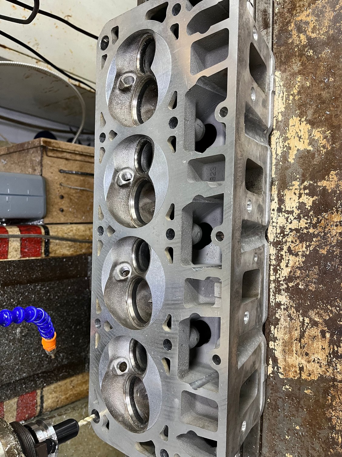

Talked to local machine shop about my build. The guy has been building race motors for years and has a snazzy 5 axis CNC machine. He said he has a program to open up the comb chamb size (he built a program for it because he's done it before), or alternatively we could machine more dish into the pistons, to lower compression. Does anyone know if either of those practices are common or preferred?

In a boosted build, I’d definitely cut the chamber before I cut the piston dome. Having said that, I’ve seen plenty of guys run 10.6 with boost. It lowers your tuning window some, but very doable with todays efficient heads and intercoolers. Meth injection will also help cool things. You want a great tuner here. Not a good tuner, a GREAT tuner.

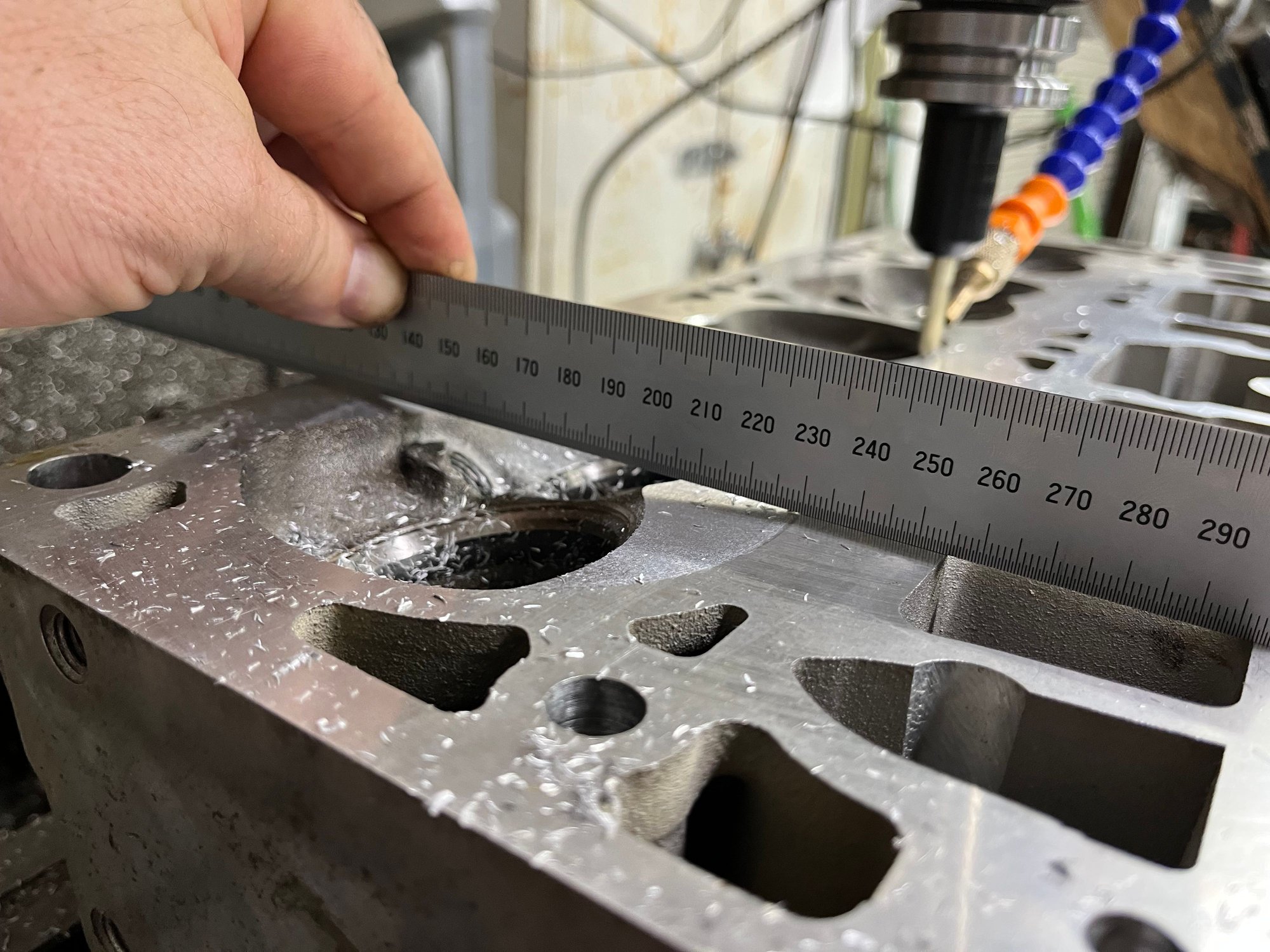

I’m putting together an ls3 for boost and wanted lower compression so I softened the chambers on my cnc Bridgeport. I haven’t measured the chambers yet but it should put me in a better spot and I’m more comfortable using a thicker head gasket now that the head side of the chamber isn’t flat.
I cut it about 005 deeper than I meant to but I think it will be fine. If not, these castings are cheap.
This mod should open up the tuning window as well. It’s becoming more common and lots of head shops will do it for a very reasonable cost. Something to look consider.

I appreciate this answer, I had totally forgotten that "softening" the comb chamber was a thing, I actually have a friend with a ZR1 who had that procedure done to his fancy-pants Frankenstein heads. He's overdriving his 2650 and making stupid amounts of power. That's actually the car that made me want to get into tinkering with blowers. I believe I'll go that route.
