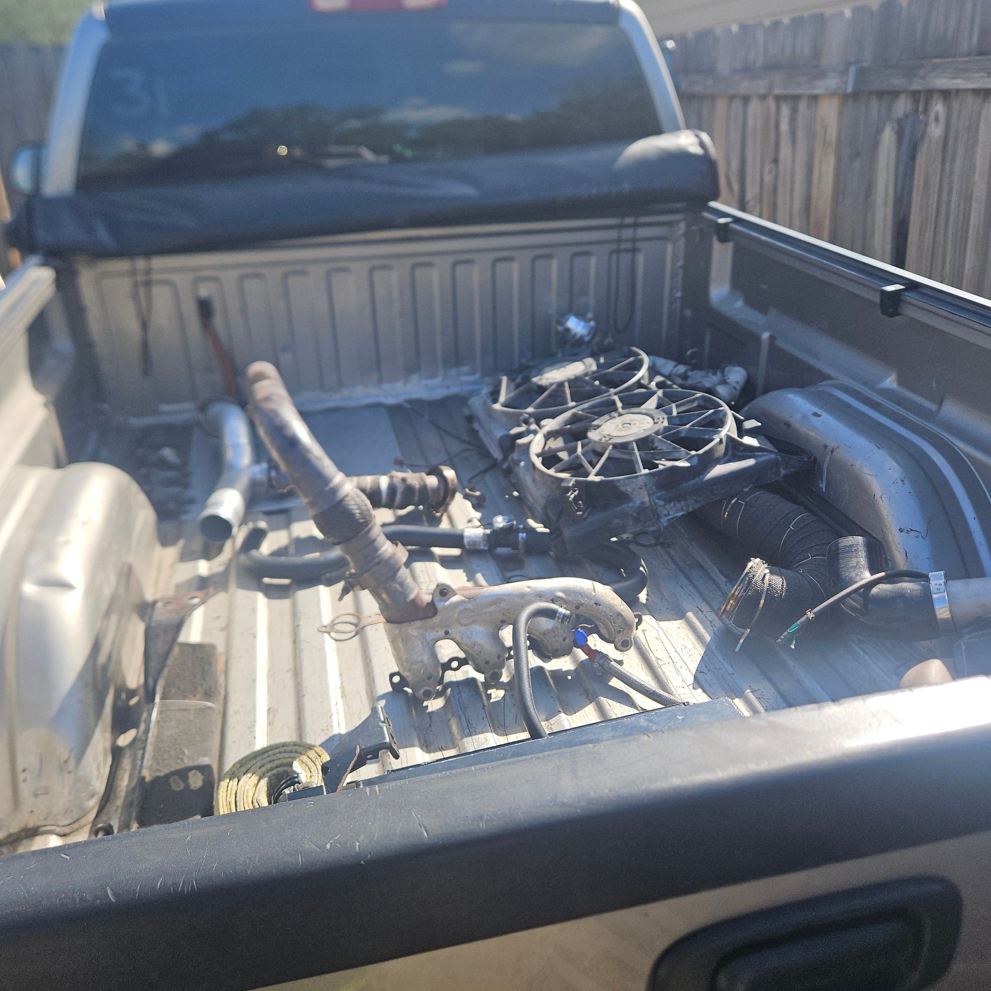

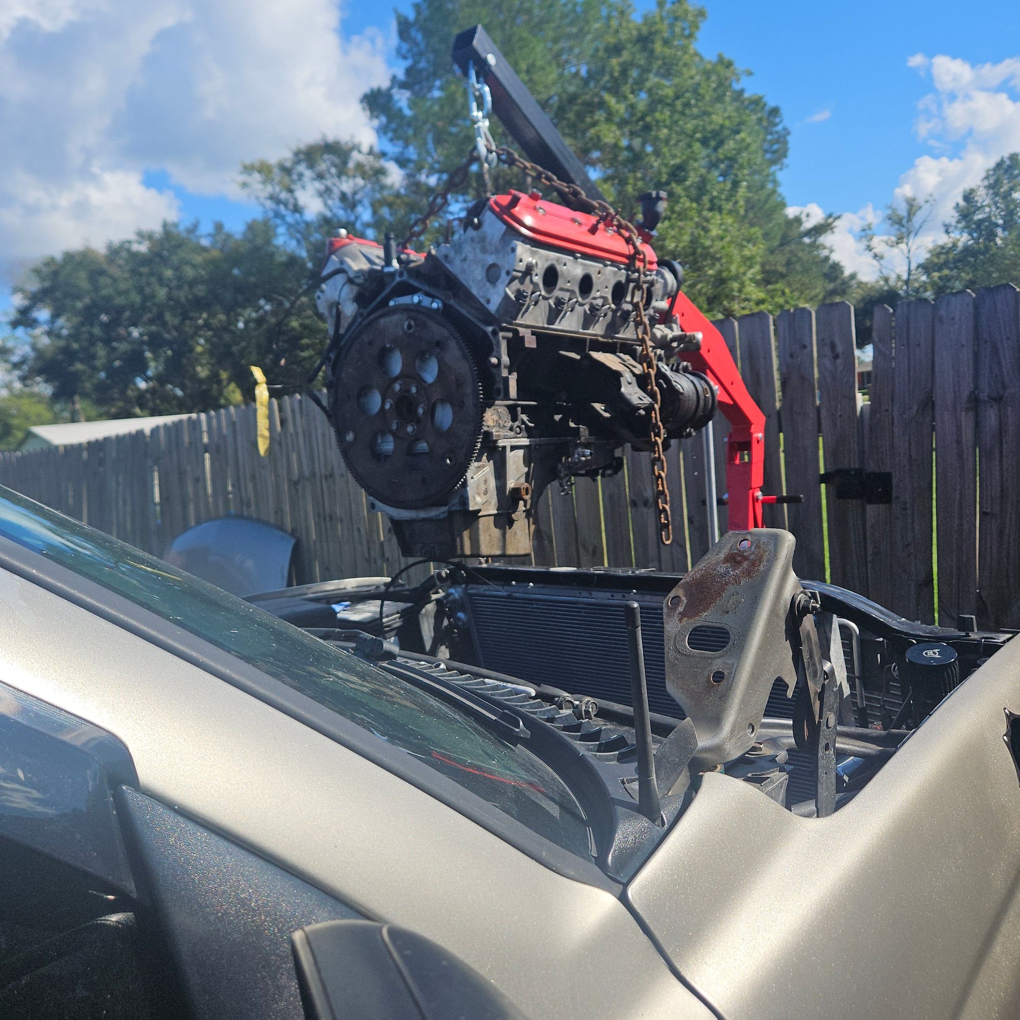

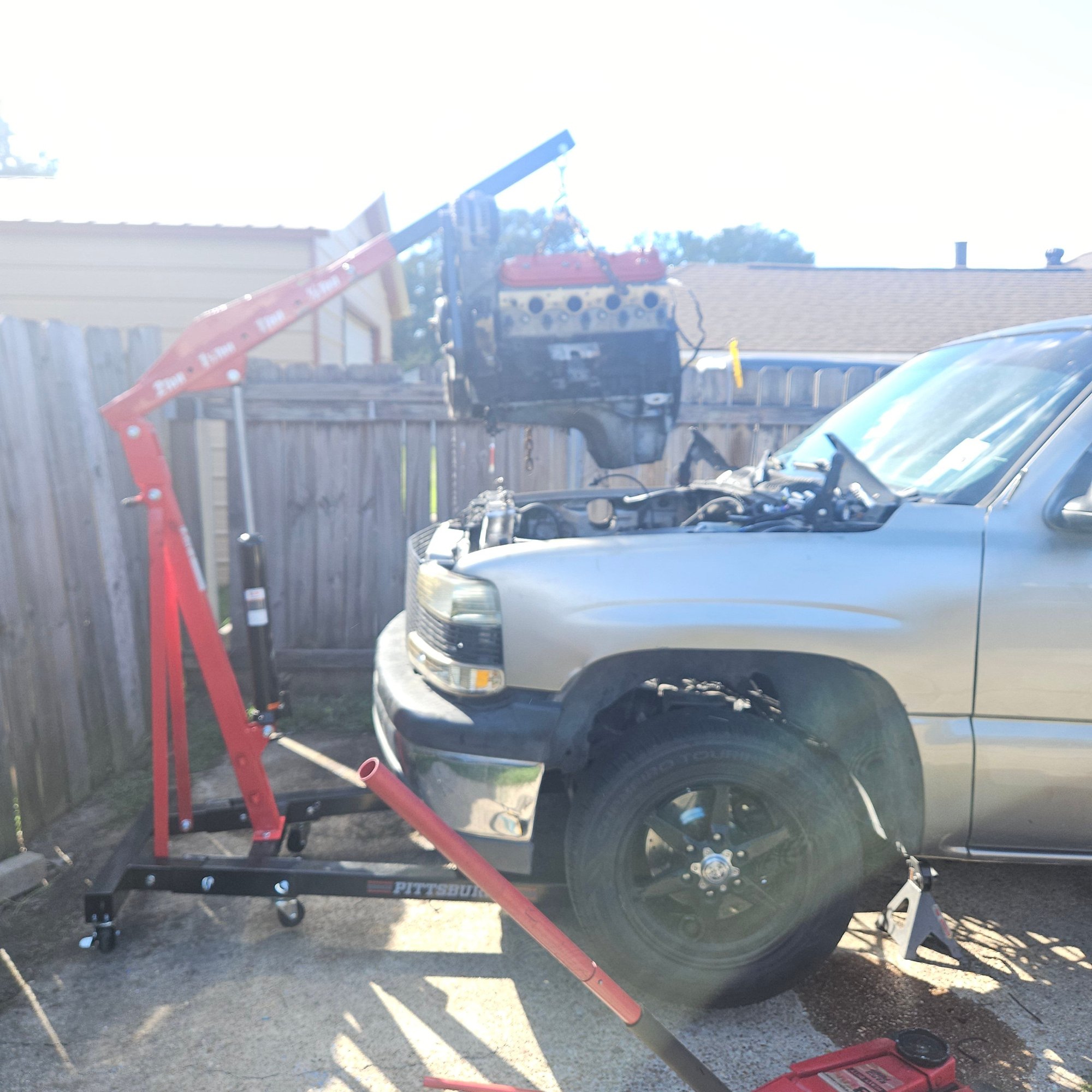

And it's out!

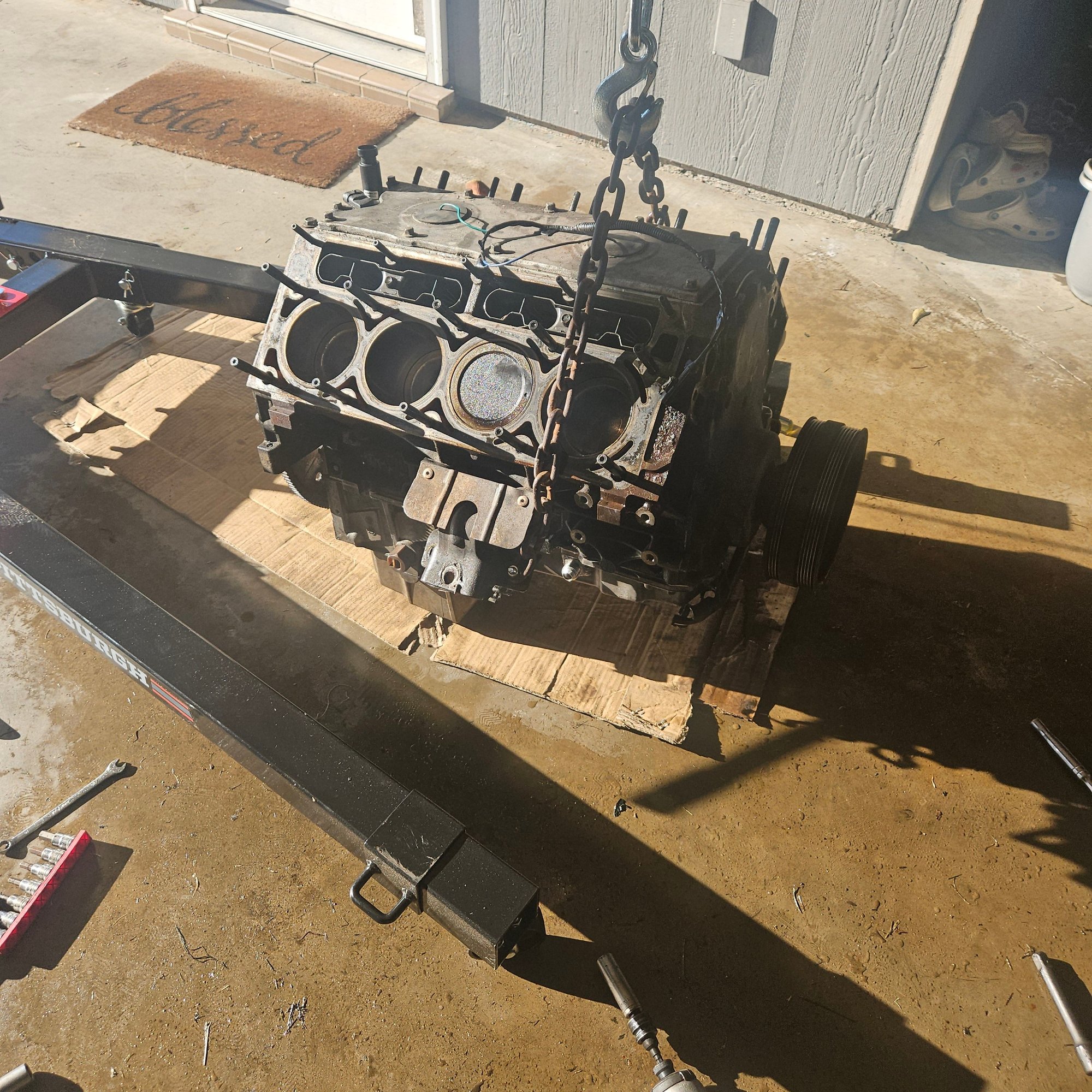

lol my work ethics is probably my best quality, ive always worked my *** off so this isnt anything different for me. I ripped the heads off too now I'm pulling all the accessories off the motor

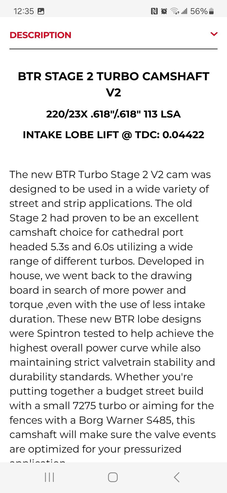

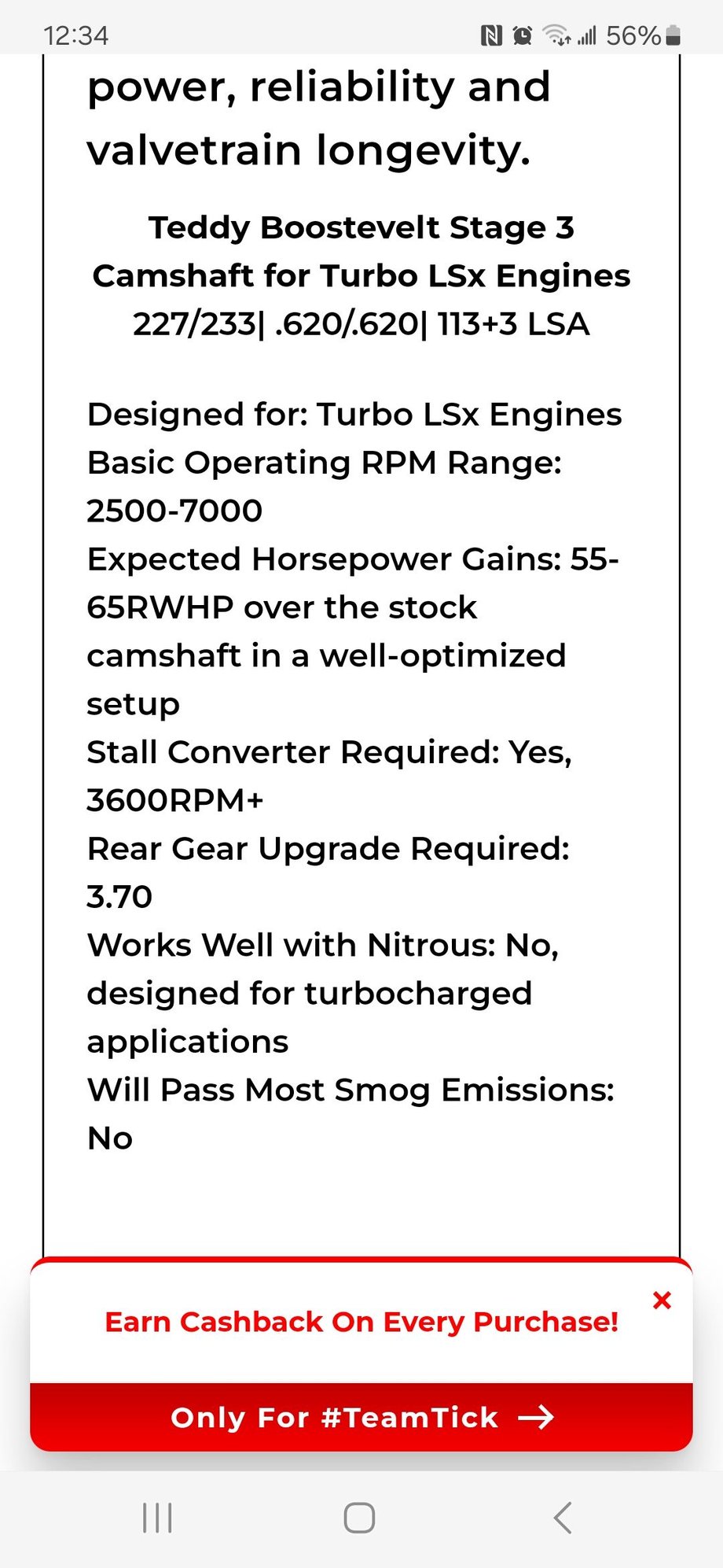

Which one guys? Might as well ditch the truck cam while I have this thing pulled apart

My rpm are falling off after 6400 rpm and i looked at the dyno sheet on btr site for the cam i have and it does the same exact thing and im looking to get around 7200rpm out of it.

I called tick and that's the cam they suggested and my tuner said he has used the btr cam alot of times with good results so that's why im debating the two. Leaning more towards the tick cam.

and im not sure that it will resolve the problem but I can understand why it would as it's a truck cam and not meant to rev that high and the dyno graph from btr looks exactly like mine. This is the dyno graph from btr. Look at it and look at mine.
