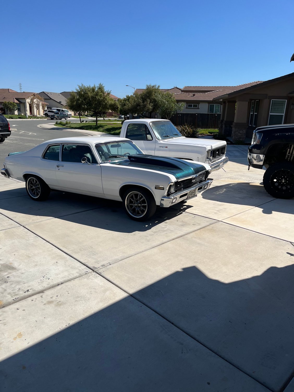

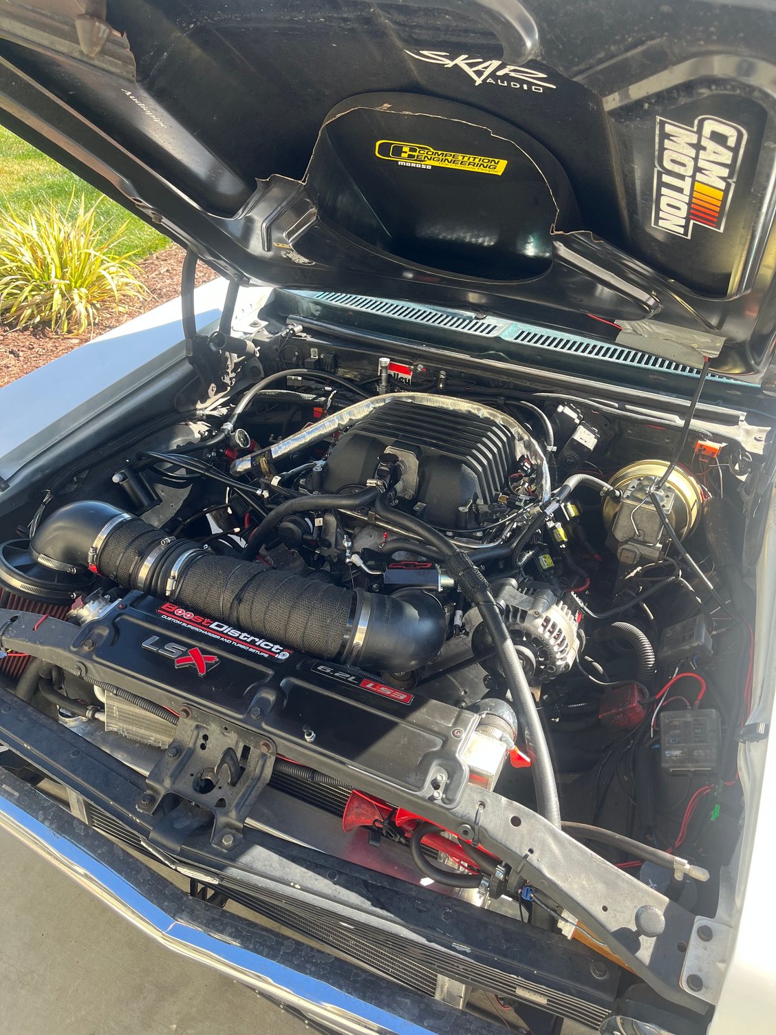

Yeah i have been following your posts and you are absoluteley correct on keeping a spare hoarded away in the garage, either for a spare or who knows if you come across another project car that is begging for an LS swap…..i have a couple rainy day spares stashed in the garage too…..just in case
Silver one is a 5.3 with 4.8 flat tops and asa cam, the other is my LQ4 converted to a 370” with flat top LS2 pistons and ASA cam before it got a supercharger and different cam
The motor in the car was my first swap and its a nice lil cammed (220/220) strung out 4.8….this is the one that started it all….the 370” behind it is what went in its place shortly after and now is being built into a supercharged 408”…..the 4.8 is supercharged (centrifugal) and now lives in my ‘73 c10 swb fleetside
The 370” before it got the 64cc LS3 style heads
This one is a gen 4 L96 with LS2 flat tops swapped into it
Closest motor is flat top L96, the other is FLAT top 370”

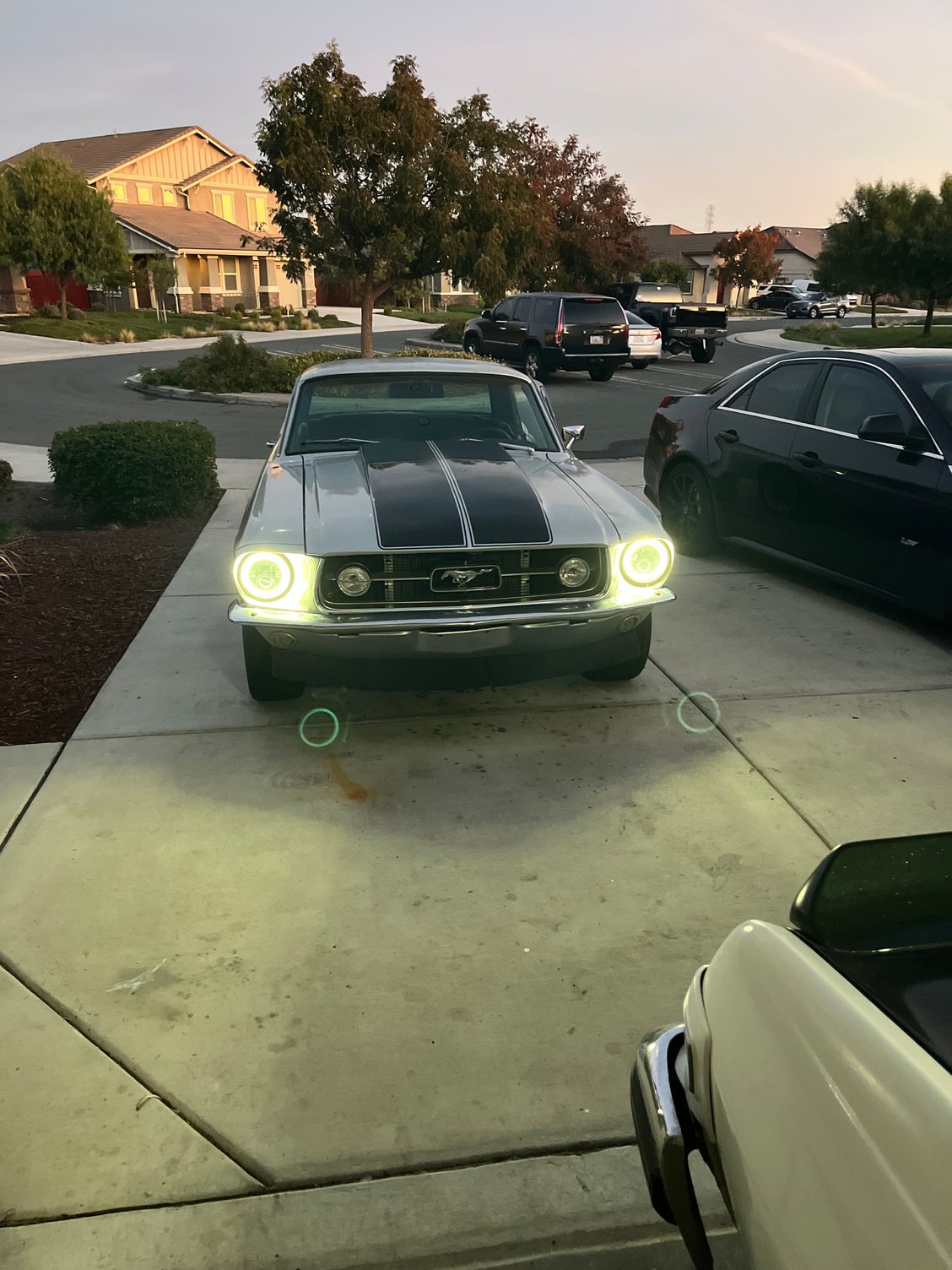

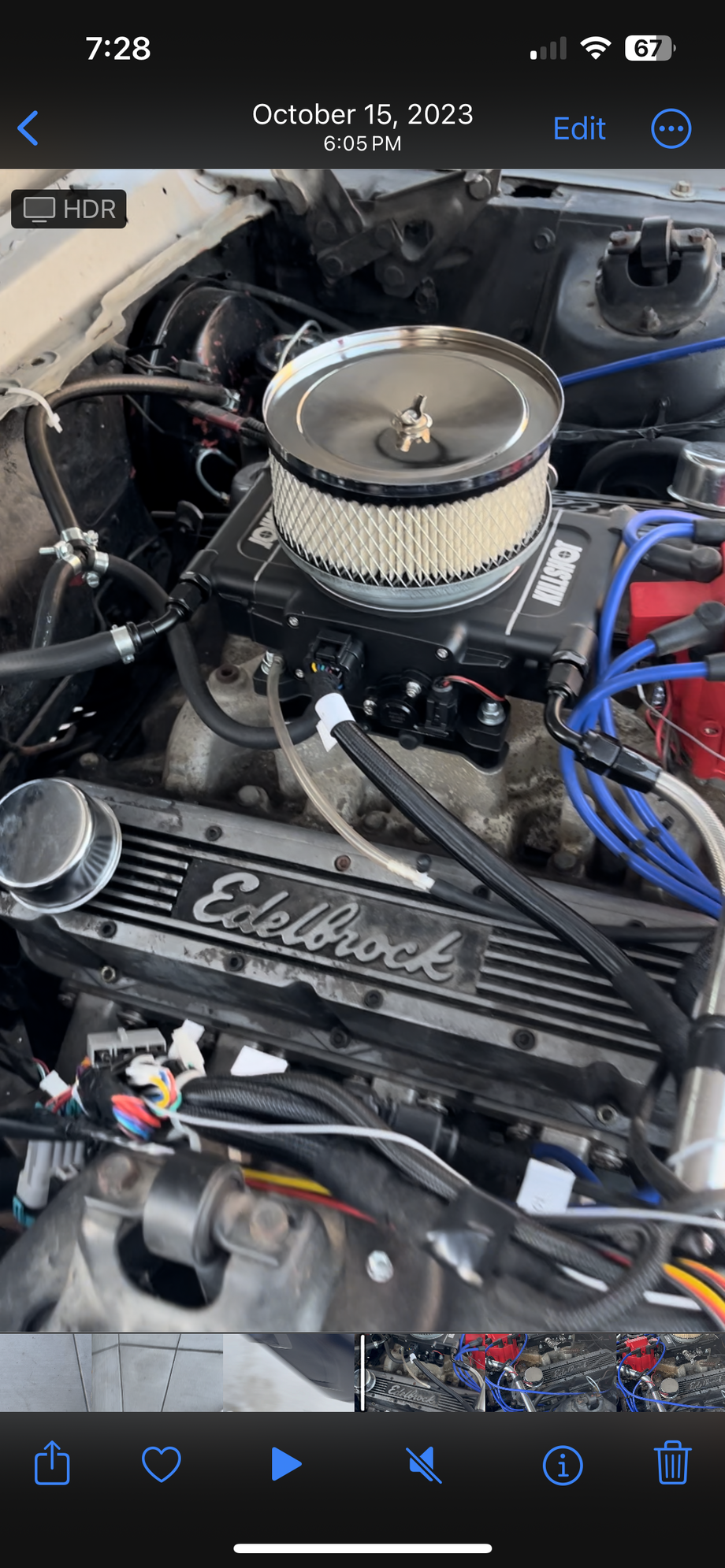

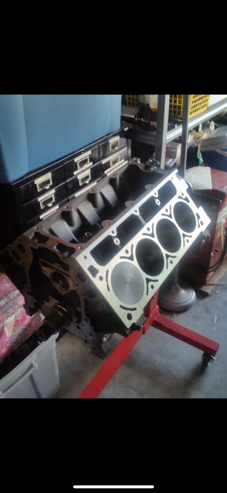

Thats the 4.8 in the white truck….i have that flat top L96 to go in its place in the near future here, just have other prioroties with other cars to deal with at the moment
This is the LQ4 that got punched out to 370” with the flat top LS2 pistons, it had a 2.45” pulley and 850fic injectors with a cam motion 220/230 on 117+5 lsa (baby) cam but works great with my power brakes and has awesome streetability manners, i have a 408” stroker assembly stashed in the garage to go into this block seeing how it is already bored .030 over and is still basically a fresh build with only 13k mi on the clock since its been finished….
My 16yr old son was able to talk me and his mother into getting him a ‘67 mustang, i tried to convince him into getting a GM product, but he was very convinced and determined that he needed a mustang, when i was in high school at his age i had a ‘65 fast back, and when i met his mother she had a ‘66 coupe , so i knew his mother was gonna side with him on the mustang dilemma, it currently has a slightly tired 289 in it that i already converted to EFI,
So we got this lil tired 289 running as good as we can considering its been parked for the past 25+ yrs, we picked up a late 90’s explorer roller cam 5.0 to replace the tired 289, we got higher compression pistons and aluminum heads to get us into the 10.25:1 range instead of the current 9:1 that the anemic 289 is pushing, got all new internals and the only things being re-used will be the block and crank, everything else will be BRAND SPANKIN new, only gotta get a hi stall convertor, and build!
……if only i coulda talked him into getting a GM product, i would have saved thousands (literally) and it would have been LS swapped already…..no boost untill he is at least 25 and paying his own insurance and proves he is responsible with 325hp……..let alone 500+…..fords are soooo much more expensive to build and only get half the power, not to mention they are all *** backwards and make zero sense half the time……although i will admit, an early ford (60’s and very early 70’s) when done up right with the proper touches are very very nice and are attention grabbers, i just cant justify where their outrageous prices come from

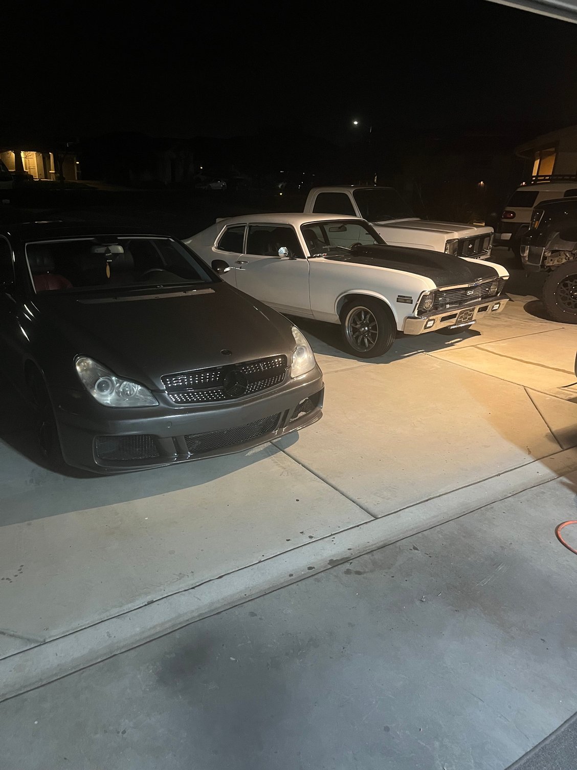

Oh trust me, my wife hates it but at the end of the day she is a car person too and she gets to drive a cts-V at the end of the day so she cant complain toooo much
So she mainly likes to drive this cts-V
When she doesnt wanna burn a half a tank of premium unleaded when just driving to the next town and back she will drive this mbz cls550…..despite what people think about these cars they are actually solid built cars and if you keep up on simple maintenece they will treat you right and run forever….in the past 10yrs and only repairs that i HAD to do to it that were tricky were changing the motor mounts and front air ride struts….if i had taken it to a shop those repairs would have been thousands$
But when we are going on long trips or traveling with guests she will drive the black tahoe way back there in the middle of the court, if we are going to lake tahoe or a place where there is snow or somewhere far and dont wanna makr several fuel stop we’ll take my huge duramax, it has an auxillary fuel tank so fully fueled up it holds close to 100gallons of diesel….i keep it around mainly for tow purposes
This one is my tow pig and is an absolute beast….but yeah 7 cars is a full time job in itself when it comes to keeping them all maintained and safe for the road…not to mention a boat that has a 8.1 vortec in it (basically a big block LS), several dirt bikes go karts and a road glide
This started life as a road king but around 3 yrs ago i decided it needed a stereo and the ugly 16” front wheel had to go, thats when i put this 21” wheel on front and converted it to a road glide, its so much better to drive now with that faring in front to block the wind but it takes up soooo much valuble space in my garage, lately ive kept it parked in the backyard under the awning so its out of the sun and rain , but since winter is coming its gonna have to go back in the garage……
…….i wanna get another project car to LS swap, like an early chrome bumper c-3 vette, or maybe even a newer one like a c6 or possibly c7….but the wife isnt having it and in order to bring another one home id have to get rid of one and possibly the bike too 😫😫😫. Maybe ill just tell her i will sell the mbz cls550 and the boat…..but then she will want a newer mercedes which is more than what i will end up paying for a c6 or c7……i cant win either way!!!!
