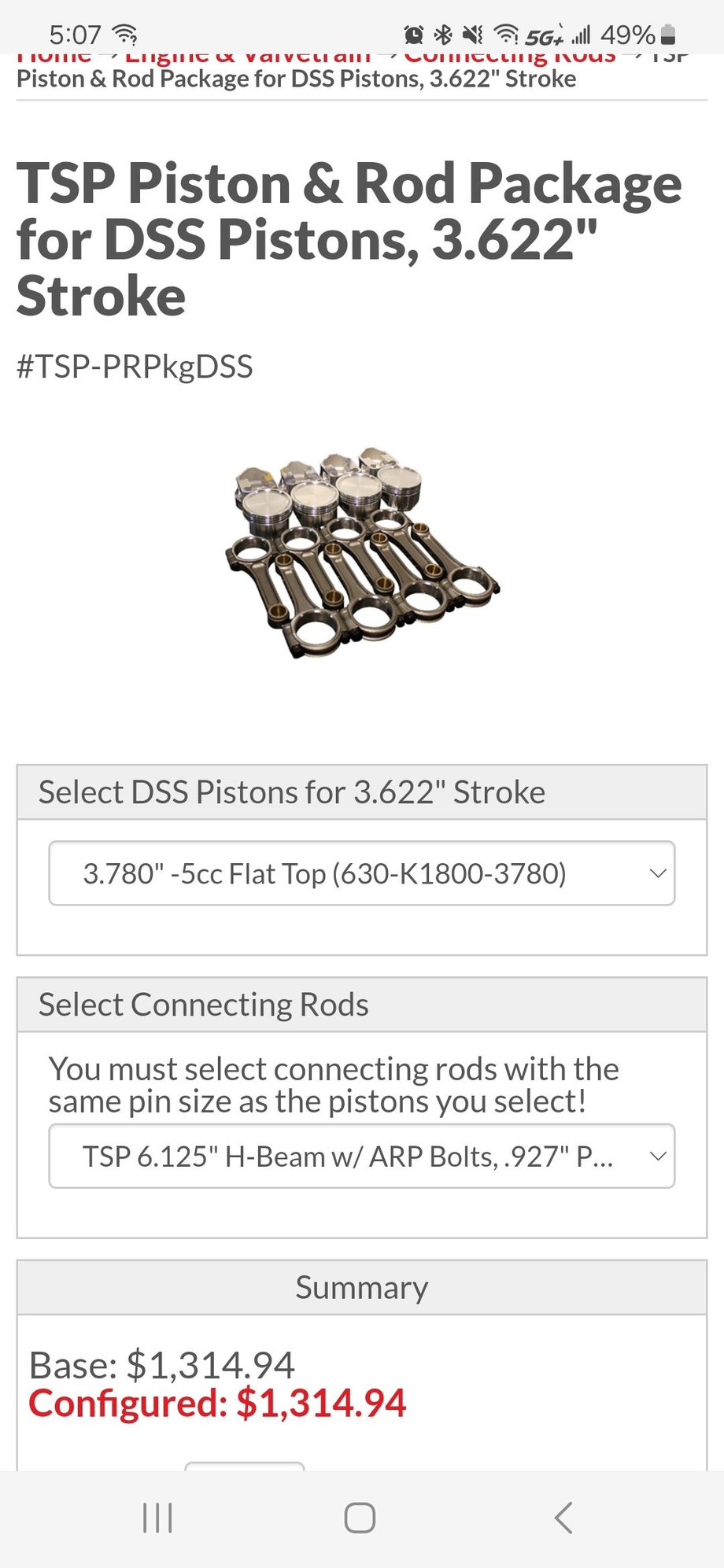

Gen 4 pistons and rods or do i bite the bullet and buy these along with the tick performance cam?

Dude just go forged and be done. I get that people don’t mind tearing down motors gapping rings and round tripping the install. But the forged stuff is cheap peace of mind. You’re two more exploded SBE’s away from spending forged money anyways.

you sound like my tuner, his words were ill install gen 4 pistons and rods if that's what you want but I'm going to try and convince you to go forged.

Up to you, can hit your goal reliably with the gen 4 stuff at a fraction of the cost though. Quick use of some of wallaceracing.com calculators puts you at under 5800rpm at 130mph depending on converter slip % in case you to think about your power curve and gearing

yeh thats why i was debating it. Ive seen plenty guys push to 1000hp with gen 4 so i didnt really think it would be a problem. And tbh i didn't notice where my rpm were when i crossed the finish line and i was at 128 so i was right there at that speed

If the crank is still good, I'd drop in gen IV rods and pistons and keep going.
Those should literally be a drop in deal which you could do yourself, gap the rings while you're in there.
Buy some block cleaning brushes and a case of brake cleaner and give the block a very good cleaning or have it hot tanked.
A forged rotator will also require cleaning the block and balancing so more money, Summit has a good rod/piston package too.
I'd scoop up a LC9 or L33 aluminum block and piece together a fully forged rotator over time while enjoying the engine with the Gen IV parts.

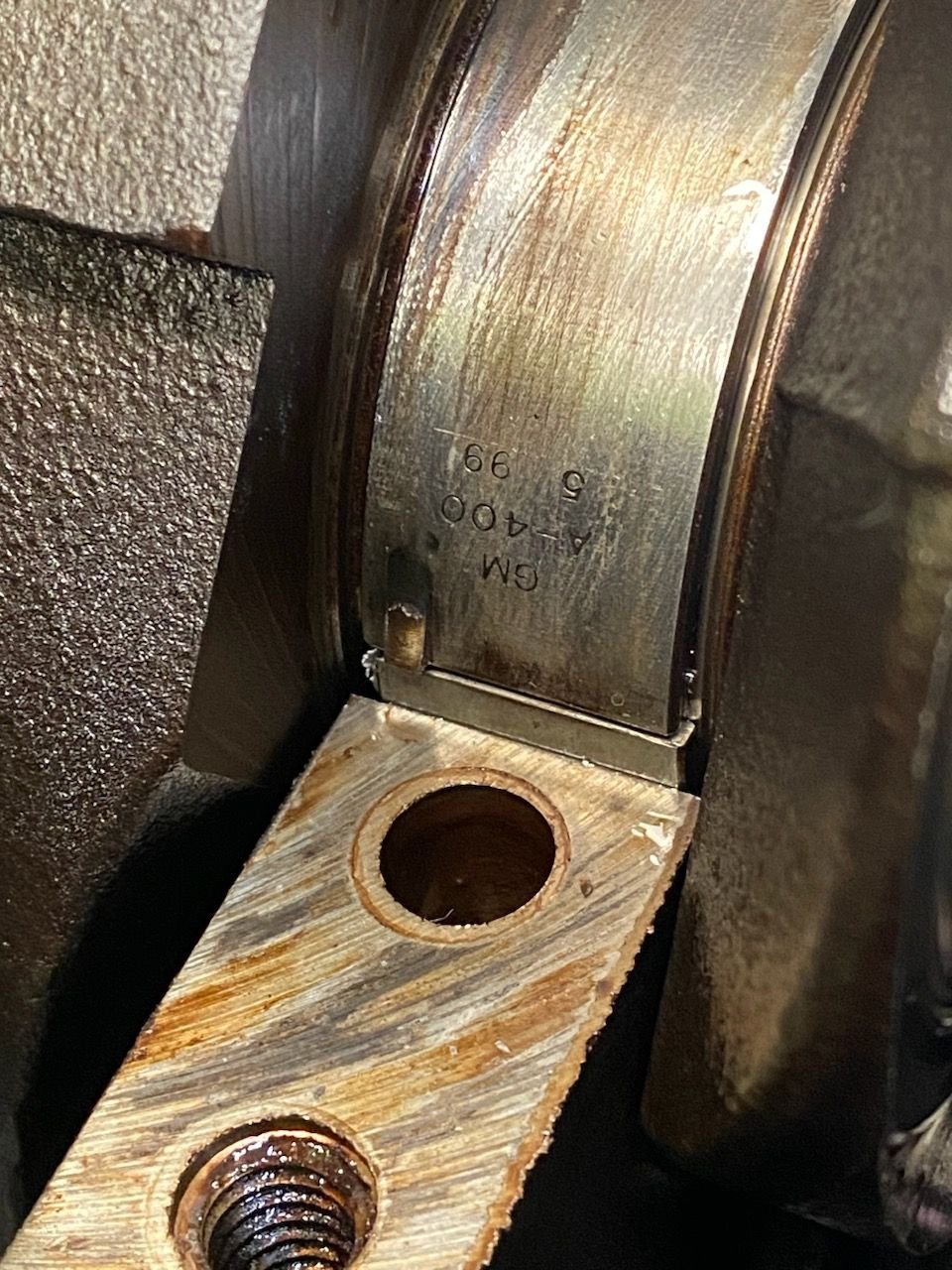

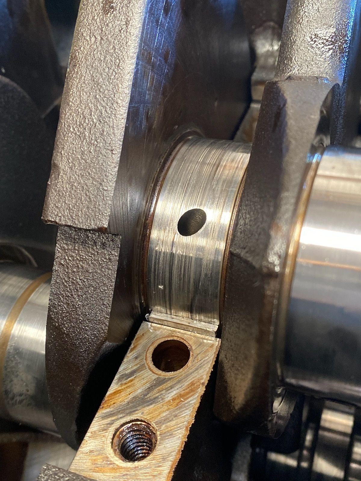

I'm thinking it's the main bearings. If I had to guess I'd said number 1 cylinder. If you recall I posted several months back, not sure if it was this post or a different one but the rod had broken off from the piston. The valve seal was stuck and the valve could close and detonated the hell out the piston. I had stuck another gen 3 piston and rod in it and replaced the head and put it right back on the road. So I'm assuming that bearing probably failed cause I didn't check clearances or anything on it.

Well I think i know why my oil pressure dropped, mains spun. That would be my luck, he said I would have to have it line bored and use main studs if I wanted to reuse it.

Damn it man.
Time to start at looking at other options instead of tossing yet another used short block at it.
Is the crank salvageable?
At this point I'd have them prep the block, clean up the crank if possible, pick up a rod/piston package from Summit and be done with it or if the crank is junk get that from summit too.
Either that or pick up a fairly low mile (100K or less) L33 or LC9 short block, inspect it thoroughly, confirm gaps and make sure its ready for duty.
Or...or.... get another crank and a set of factory bearings and go back together while saving for option one.

he's telling me it's not worth saving the block because I would have to line hone it and the main studs are damaged. Mind you this is an lm7 block. He said the damages he found is worse case scenario. Crank is damaged as well, crank was flexing? He said he has a 6.0 bare block that I can buy for 300 and he has a spare crank we can use and of course I would have to get pistons & rods and the few other small variables it takes to put the shortblock together.
I'd jump on the 6.0L, only caveat is that 7875 is gonna choke out sooner but the added cubes out of boost will be nice with your heavy truck.
