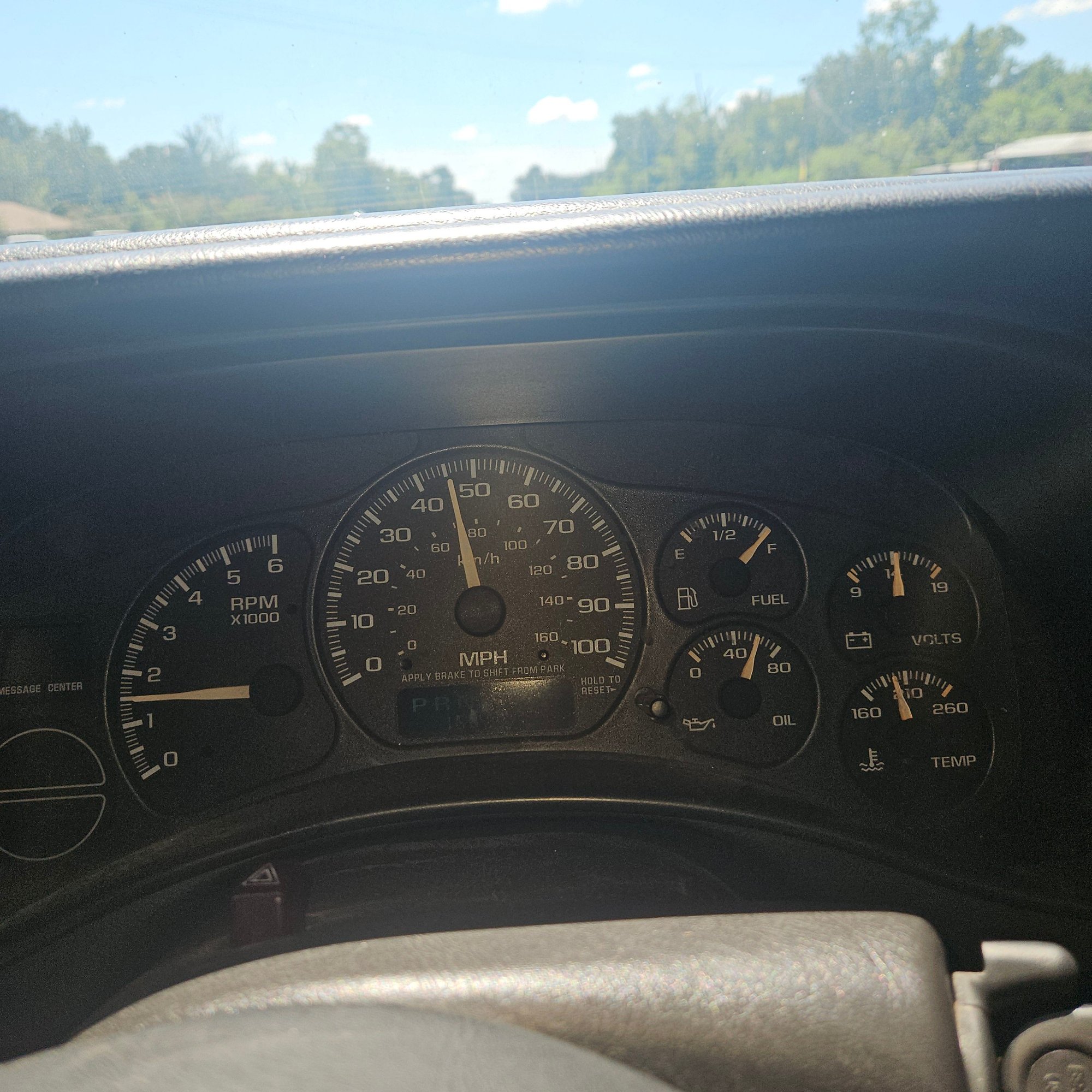

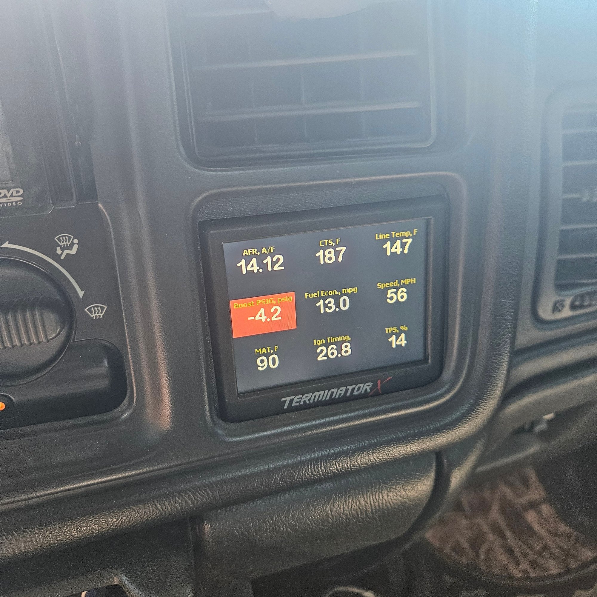

Just took the truck on an hour joy ride around my town just putting some miles on it, its 93 degrees outside so its hot as hell. Temperatures all looked good, ac blew ice cold so all in all truck is doing good. I did notice theres about a 10 mph difference between my stock tachometer and holley tachometer and im pretty sure its the holley thats off. Thats a simple fix though, ill play around with that and get it to read accurately.

👍 speedo or tach ? You mentioned mph and tach
Dash says 46
Dash says 46, didnt mean to say tachometer. Meant speedometer
Holley says 56, i think holley is wrong because i was on a road that the speed limit is 45 mph and i was going pretty even with the rest of the cars, plus i definitely didnt feel like 56.

Just pull up a speed app on your phone. At a steady speed, gps mph is accurate. Then you can easily see which reading (or both) is incorrect.
Old Aug 16, 2025 | 05:21 PM
  #1014
Tommy42088's Avatar
Joined: Oct 2022
Posts: 1,776
Likes: 627
From: Louisiana
holley is wrong but the thing is i have the gear ratio and tire size correct. Do I lie to holley to make it read correctly?
i actually just did the app thing and went around the block, holley is wrong.
I would suspect so, but there are quite a few people here far more familiar with the Holley, so hopefully they will chime in.
I had the tires set at 28, i dropped it down to 27 and ill give that a try. If i doesnt help ill get with my tuner i suppose and see if i can get him to remote tune it to correct. Im just wanting to learn these things myself so im more familiar with holley.
The only Holley I have even touched in 20 years is my neighbor's Dominator, and that was on a manual transmission, so I don't know if fudging the numbers somewhere may give unintended consequences regarding your shift tables.
thats a different parameter so I dont think that will interfere, I dont dog on my truck though so ill drive it tomorrow slowly and test it and it i don't see a change ill put it back and let someone more experienced help me.

Are you getting speed through a wheel speed sensor? I had trouble getting mine to read correctly as well. You just have to play around with the numbers until it matches. I think averaging the pulses played a role in getting it to read correctly for me, but it's been awhile since I set it up.
through the vss on the transmission and thats what my tuner told me. Im going to play around with it today and see if i can get it to read accurately.
