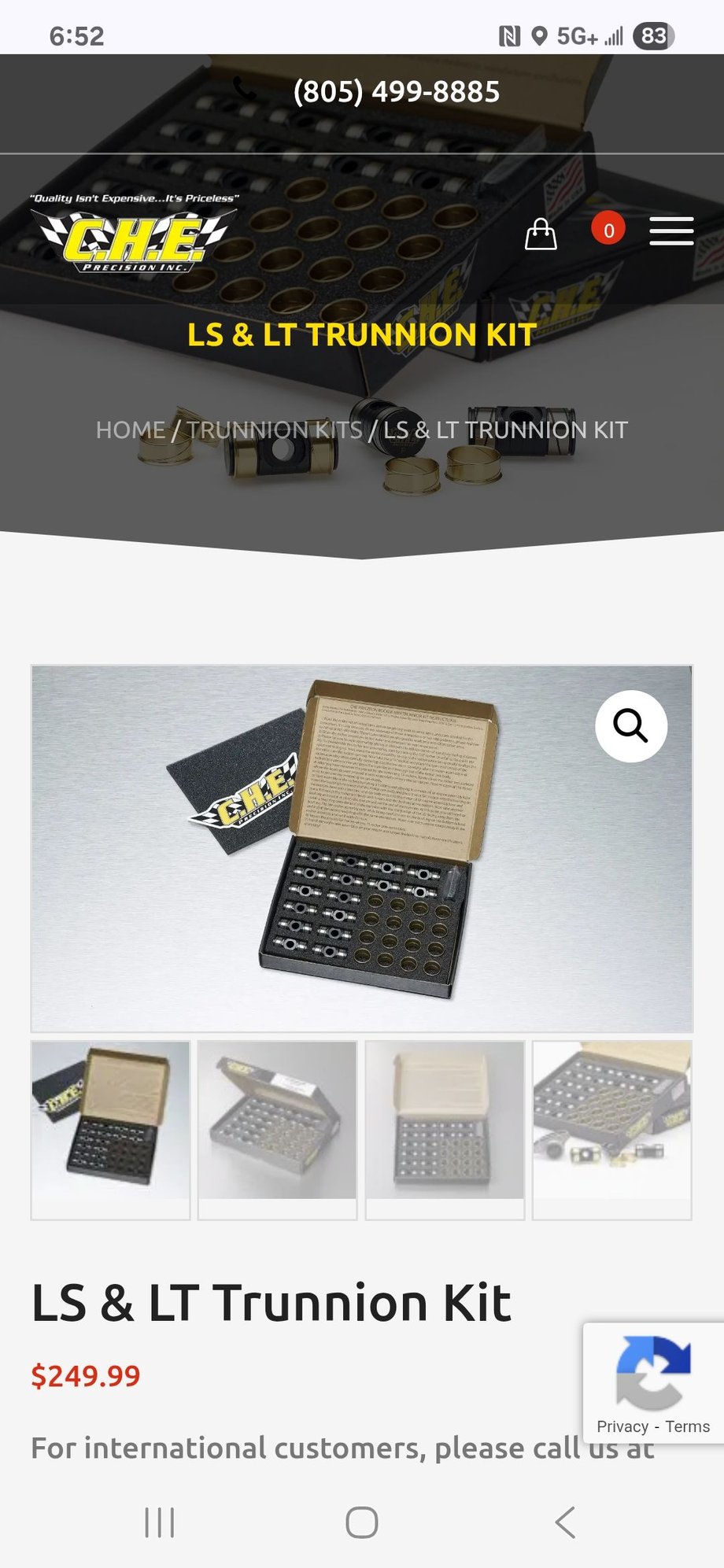

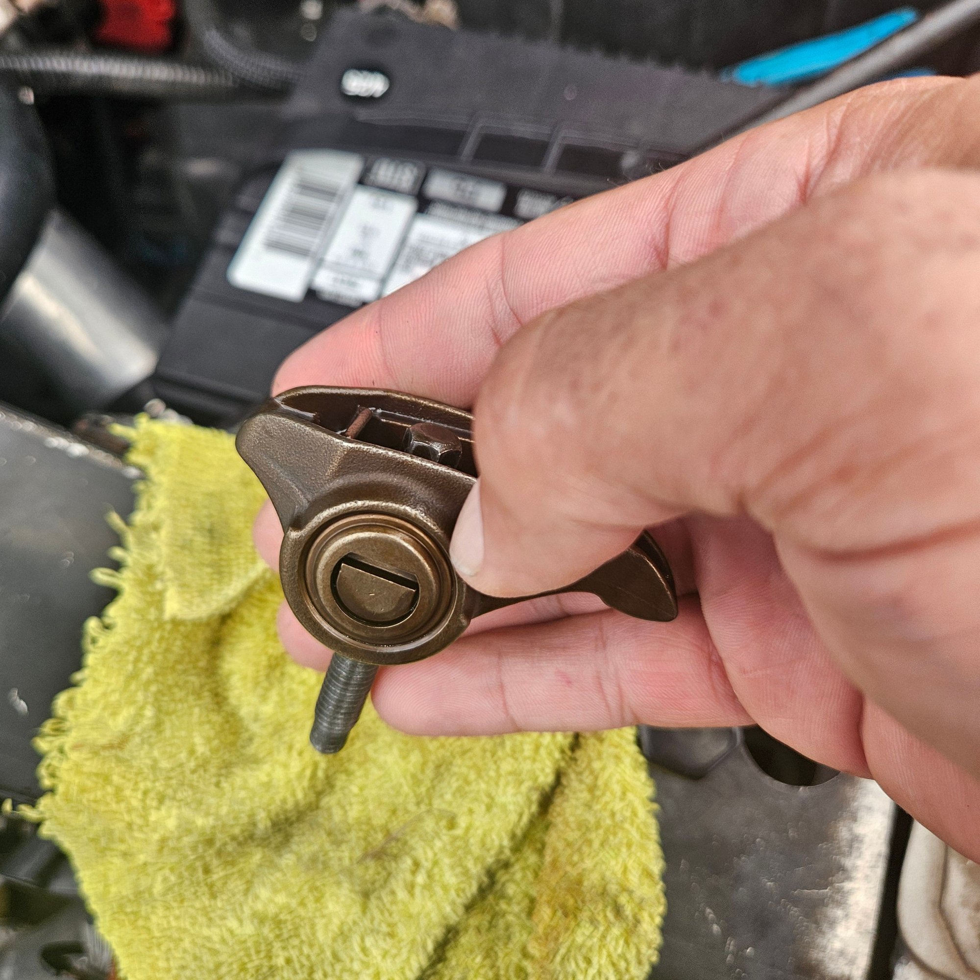

Supposed to have had a trunnion kit from the guy i bought the heads from but upon taking them apart they sure looked stock to me. Still have the needle bearings on the sides. These CHE are much better with the fixed bushing and clips.
This is how they looked before
This is the kit i installed

Typically, when the stock rockers fail, they dump the needle bearings so yours failing and not doing that is a bit odd.
Look I don't want to be pessimistic because you've been battling but keep an eye on those rockers.
The early versions ate through the bushings quickly sending metal through the engine.
If I recall the CHE kit was a good one and perhaps others will have more info, but I never went to the bushing setups because of this.
Drive it around for a bit and pull the valve covers occasionally just to make sure.
Again, I hope I'm wrong and those issues have been resolved.
Old Sep 16, 2025 | 09:56 AM
  #1052
Tommy42088's Avatar
Joined: Oct 2022
Posts: 1,775
Likes: 624
From: Louisiana
the bearings didnt dump into the engine, they just had a lot of side to side slack when I pulled them off and alot of the guys at my local track have the CHE trunion kit and suggested it to me. I would hope for the price that they are a good kit.
I also looked up the reviews on Google for the CHE kit and seen it was highly recommended.
