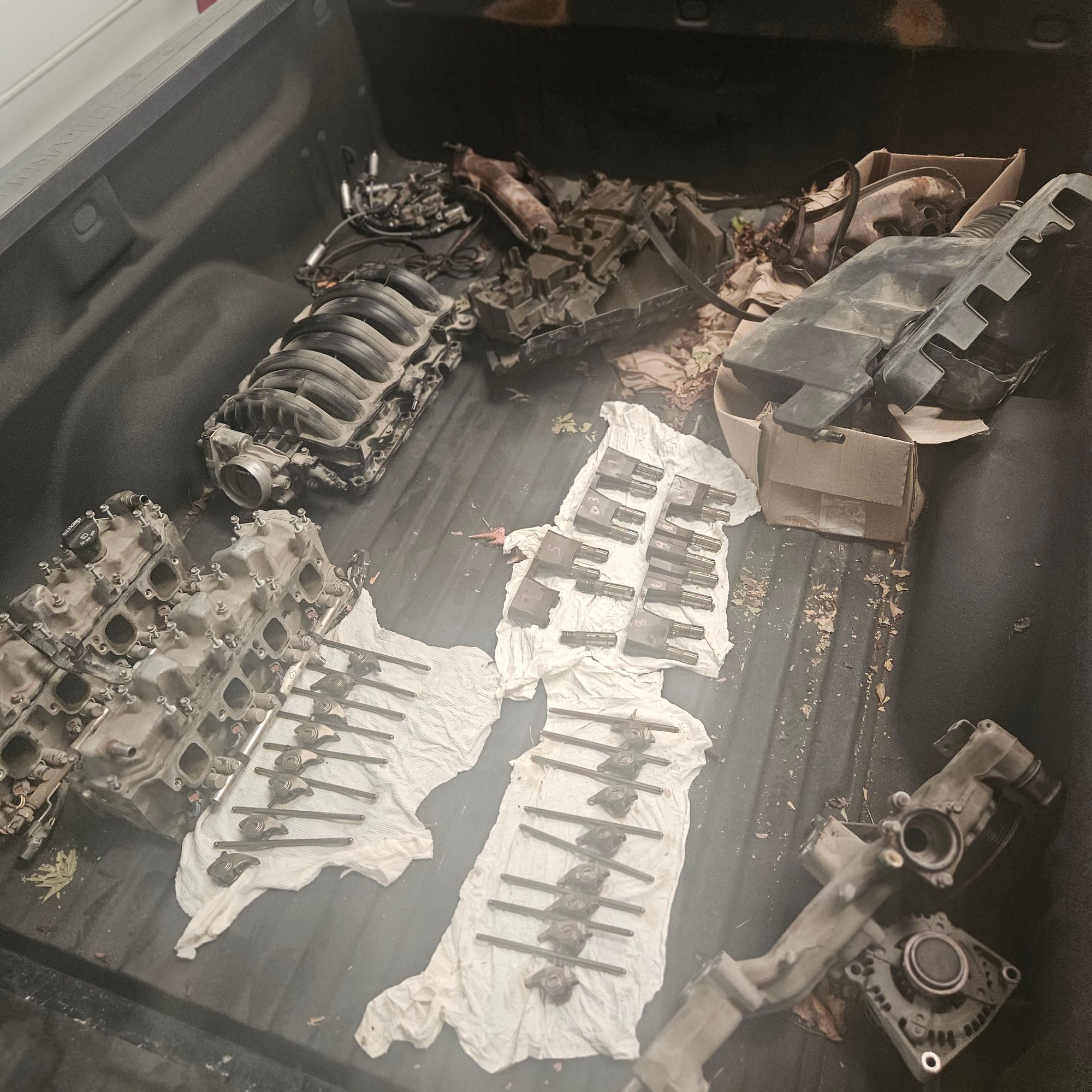

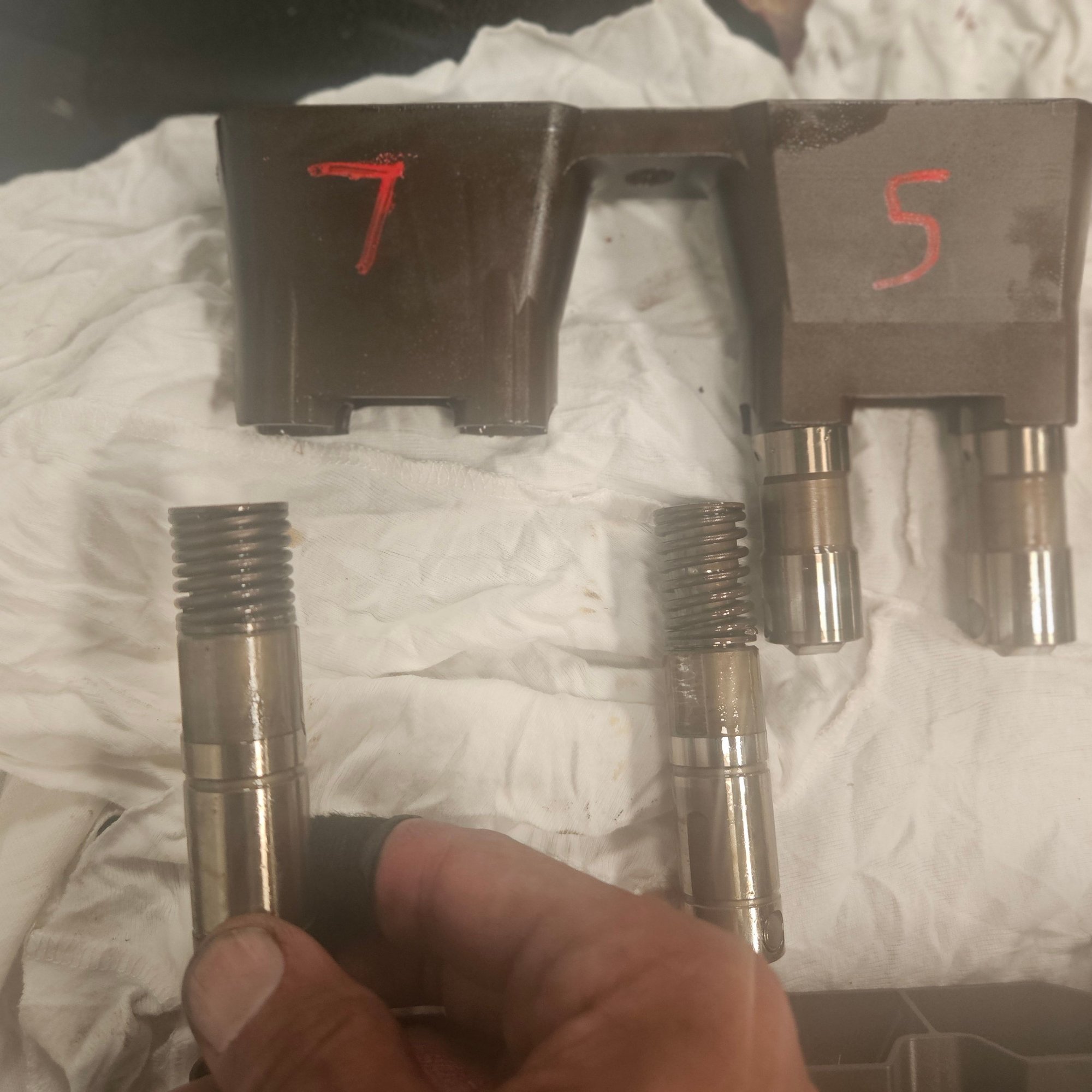

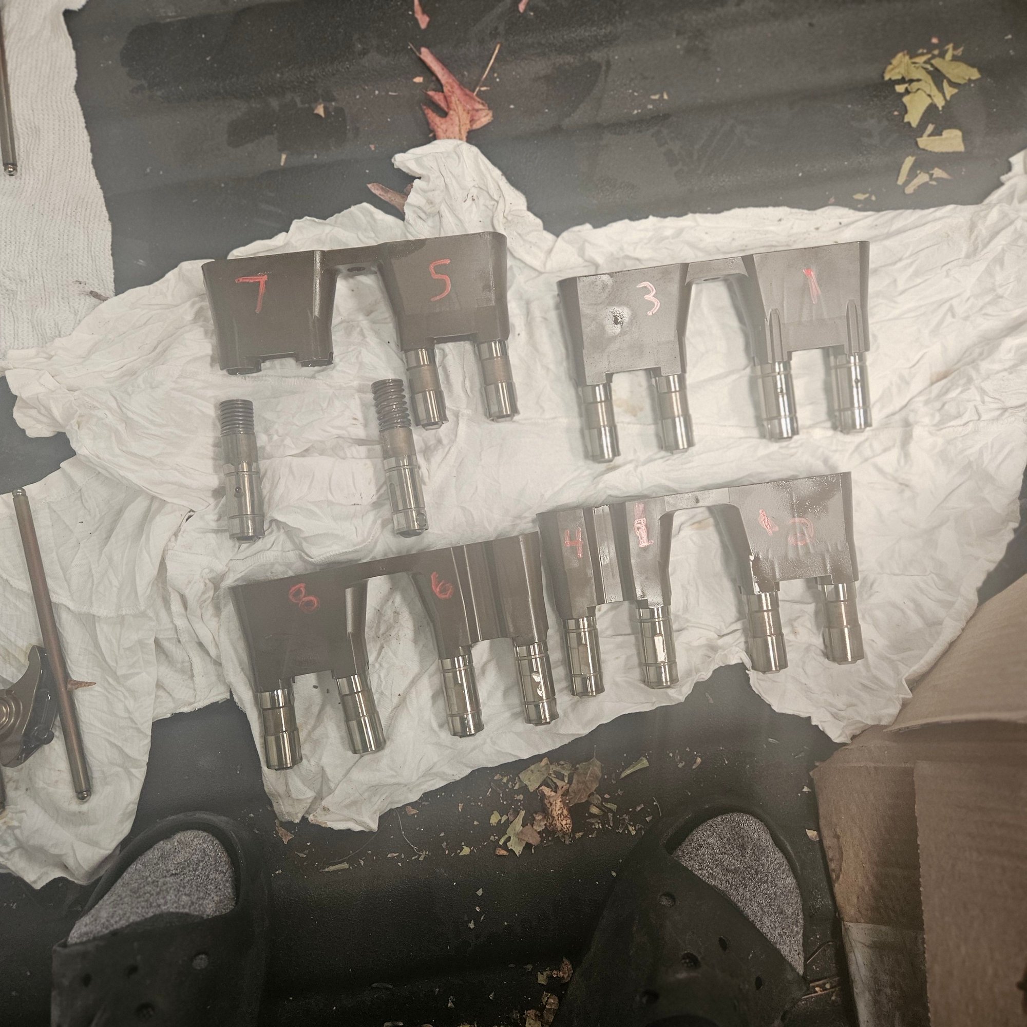

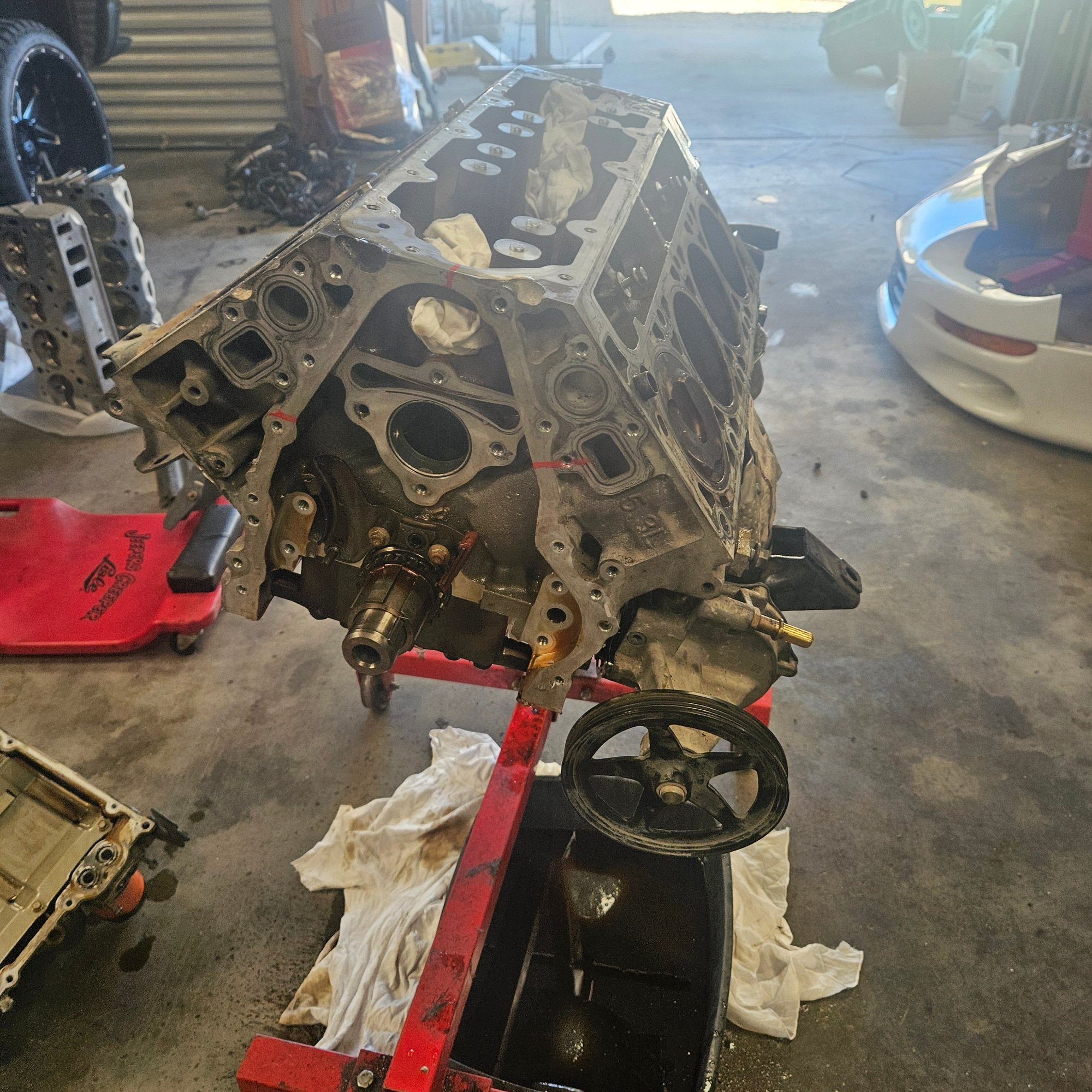

These LT trucks are definitely not an ls, started on my 2019 or should I say 2018 because it's 2018 body style search for the number 7 misfire and I definitely found it. Sure enough spring stuck on lifter.
Old Nov 9, 2025 | 12:48 PM
  #1080
Tommy42088's Avatar
Joined: Oct 2022
Posts: 1,775
Likes: 624
From: Louisiana

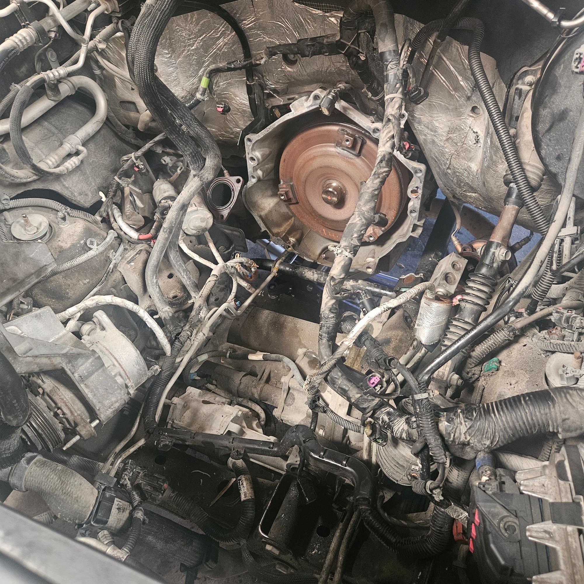

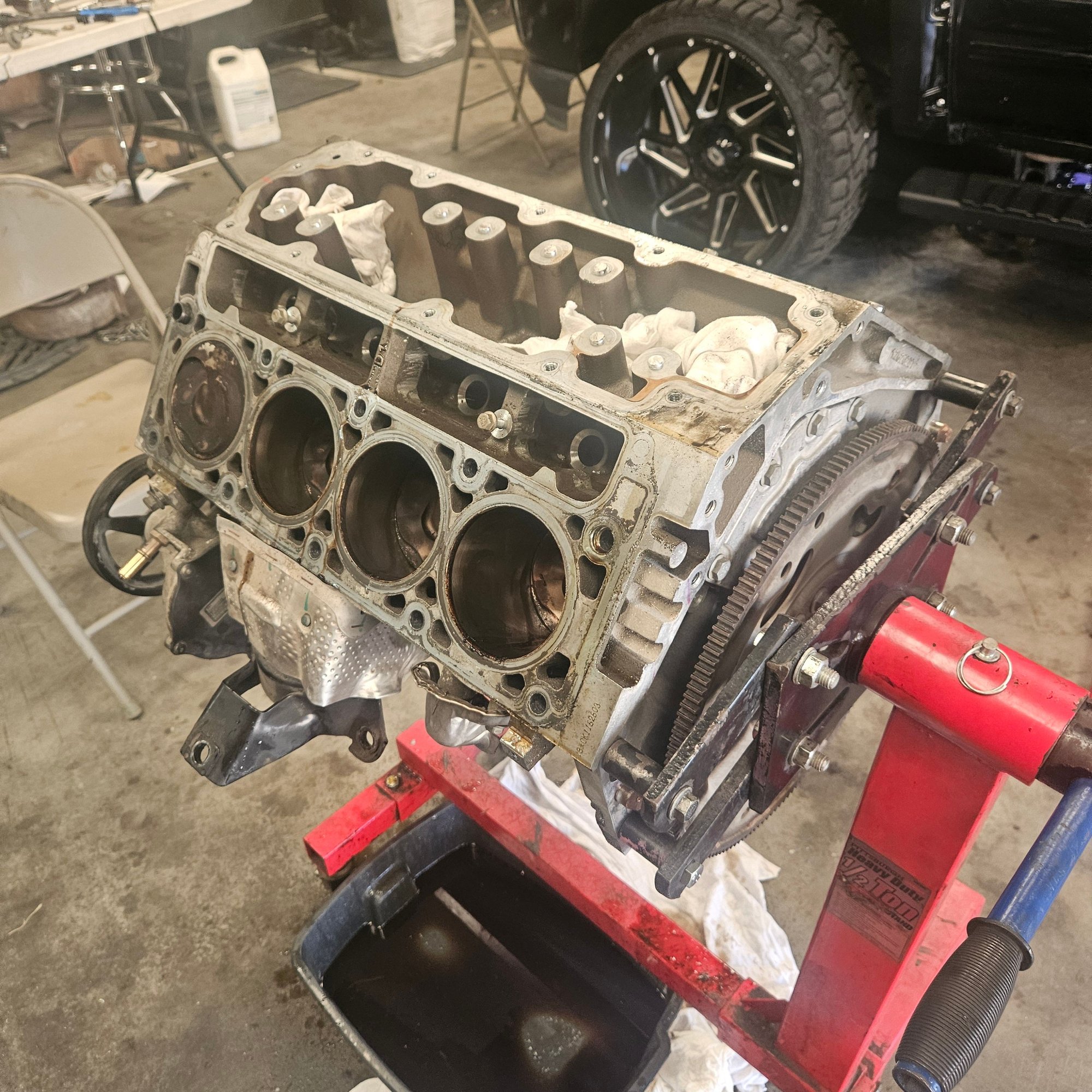

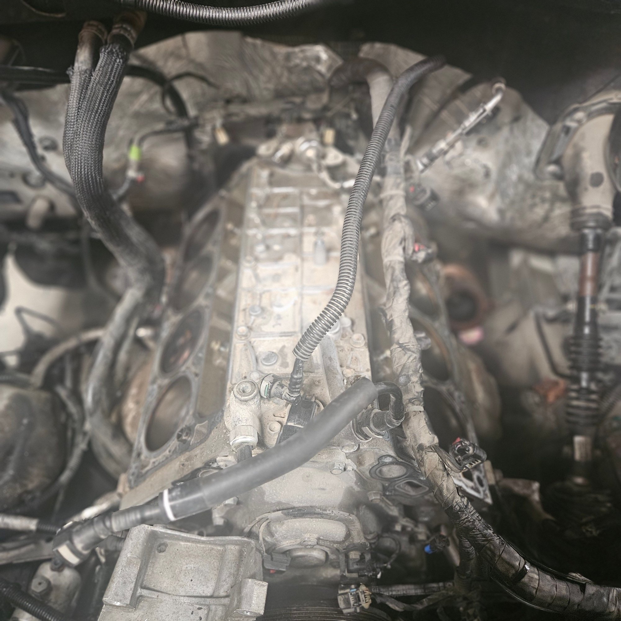

My lt truck finally apart, decided to pull the motor. Notice timing tensioner was cracked and oil pan was leaking it was easier to pull the motor then pull the pan since I already had the heads off. Im gonna go ahead and change rear main seal and put a gel pro gasket on the oil pan instead of silicone.
