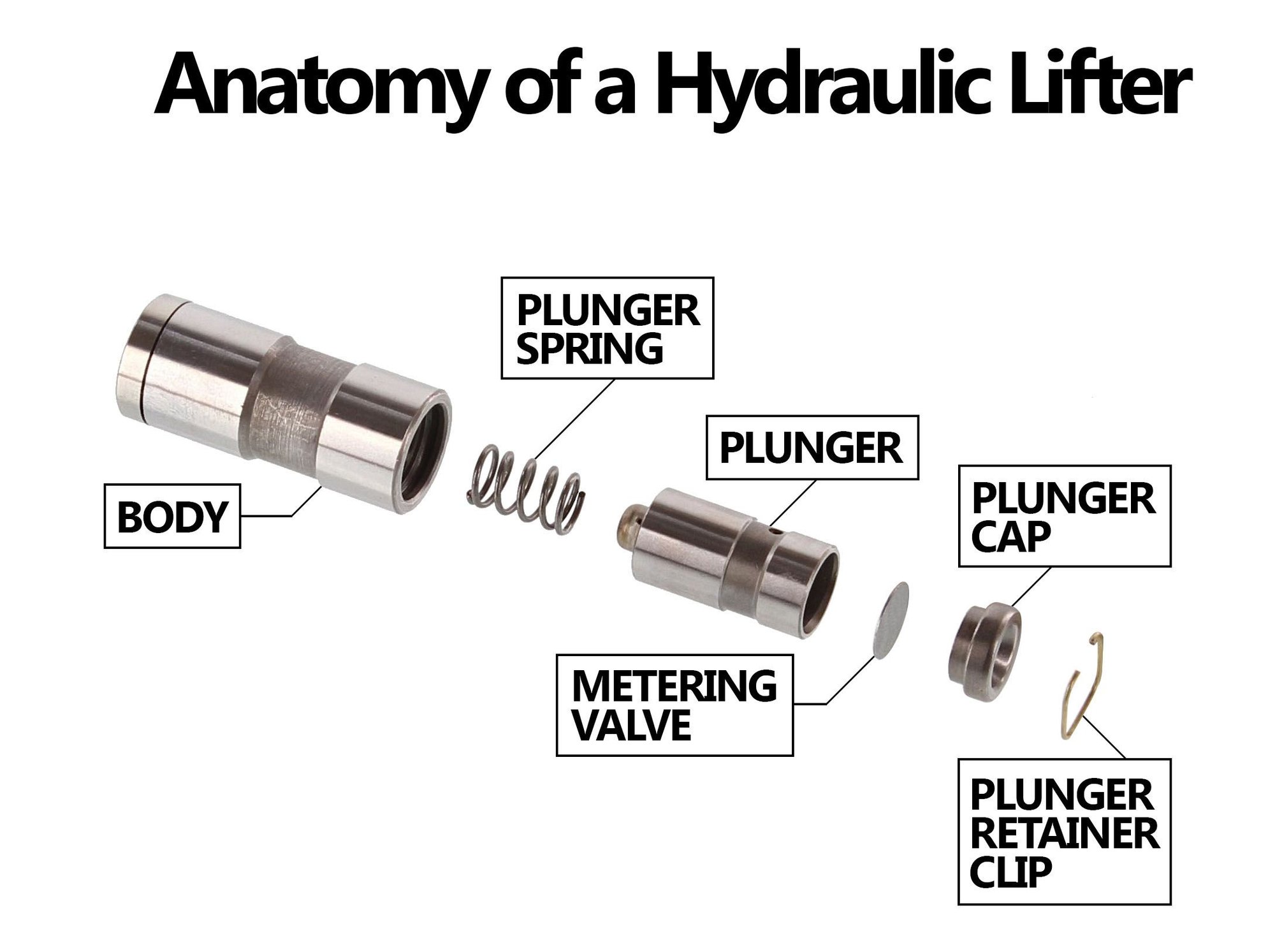

I had a new set of lifters from gm do something like this. I finally got it to do it and not release, tore it apart and the cup part was getting stuck sideways at the bottom of the lifter and there wasnt enough pressure to un stick it. Found several others that felt sticky. Swapped them all out and never another issue. May not be your issue just my 1 time experience.
And you'll need to get it on a dyno and see if its still making power that high. I imagine the rpm isn't a problem though
im trying to visualize what your saying? So the lifter was actually spinning a bit or you mean it was hanging up as its moves up and down? That interesting maybe thats whats happening. Did you go back with the same lifters? If not which lifters did you use? Its definitely still making power at 7200, it pulls hard all the way through. Im definitely going to get it back on the dyno though. Its a close friend of mine so he won't charge me to use the dyno.

The innards of the lifter. The plunger piece that holds the pushrod tip was getting stuck down in the bore. They were acdelco lifters and were replaced with more acdelcos. Just happened to get a bad batch I guess.
That was in a customers stock truck. In my play cars i have always used ultra power brand from rock auto and never had an issue. They are the cheapest ones on rockauto
