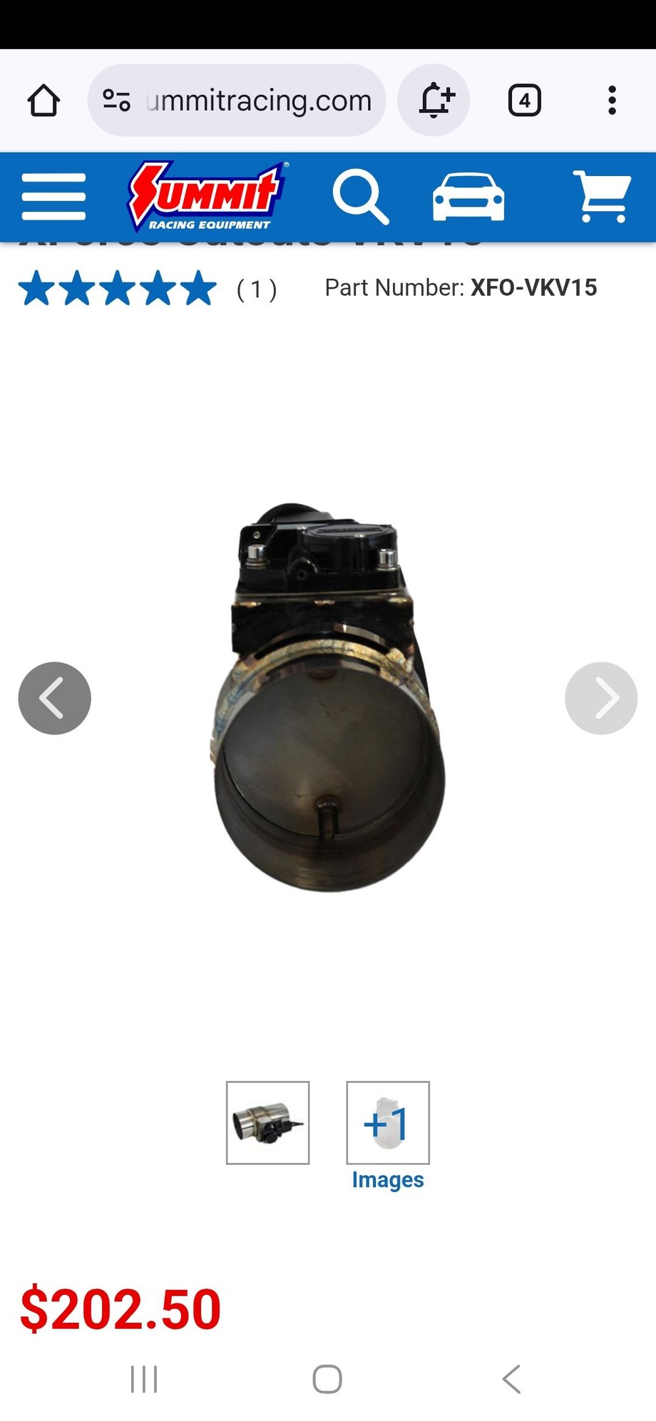

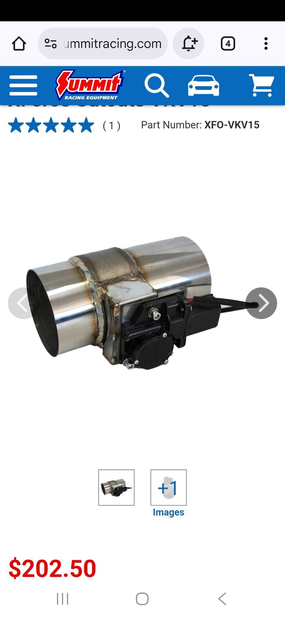

So hear me out and tell me what yall thinking, ive been looking over my truck and the 4 inch pipe isnt going to fit past my manifold on the passenger side, the only way it would fit is if I use oval pipe or change my manifold to a log style so it got me thinking. I have a full 3 inch exhaust in my back yard with a magnaflow muffler that was on the truck when it was all motor and I know it fits past the turbo manifold because when I first put the turbo on I was using that exhaust. So what it i put this cut off on my fender exit and keep it there and pie cut the fender exit and weld in my 3 inch exhaust so I can have it back on the truck and also habe the fender exit? The exhaust video earlier made me start thinking.

It would work similar to mine, but I stayed away from electric for a couple of reasons - The motors are notorious for burning up, and they're fairly slow. My set up is purely mechanical and instantaneous if I want it to be. Should be no reason you can't make it work, though. I personally like the sleeper effect of having the cutout closed and then progressively open with throttle/speed. I have a PWM table set up that controls when mine opens up. If you're just wanting to have a cutout available for the track, it will work just fine.
well I started looking at it like this, the fender exit is already there so if i got rid of it then i have to get a new fender and get it painted and my original plan of just 4 inch exhaust got screwed when I tried to stick a 4 inch pipe between the manifold and realized it hit the fire wall. I actually had a 3 inch cutout years ago and I never had issues with it and it was mechanical. Maybe I got luck. I like the one I posted because its true 4 inch and very easy to install. One clean cut and weld and it's on. Then I just had the magnaflow exhaust just sitting behind my house so this route actually came out way cheaper. I plan to hook the cutout up to holley as well. Im just going to run it to an output and have it tps activated. I have the can bus module on my truck so I have plenty extra inputs/outputs.

Sounds like a good plan. I have the CAN module as well, it made having a Terminator X a lot easier to deal with. I love how I set up my cutout, as it's quieter at idle than my N/A Camaro. If it weren't for the lopey idle, it could almost pass for stock.
