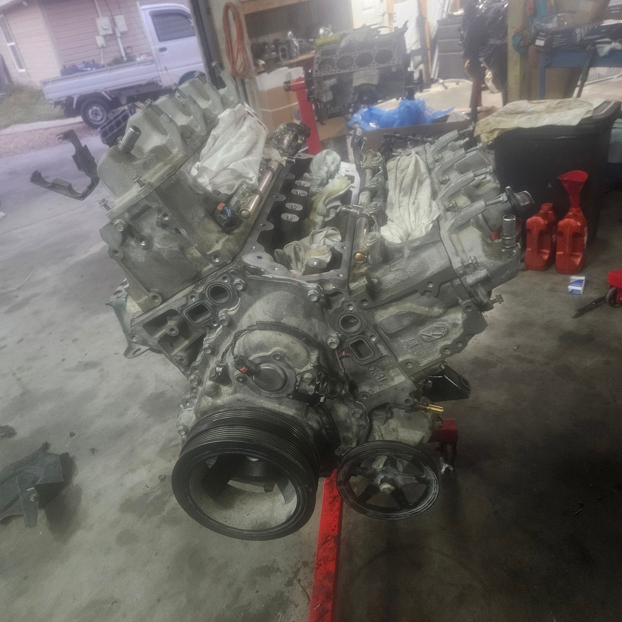

Lt back together, texas speed dod delete kit, also changed cam retainer plate, timing chain tensioner, oil pan gasket kit.

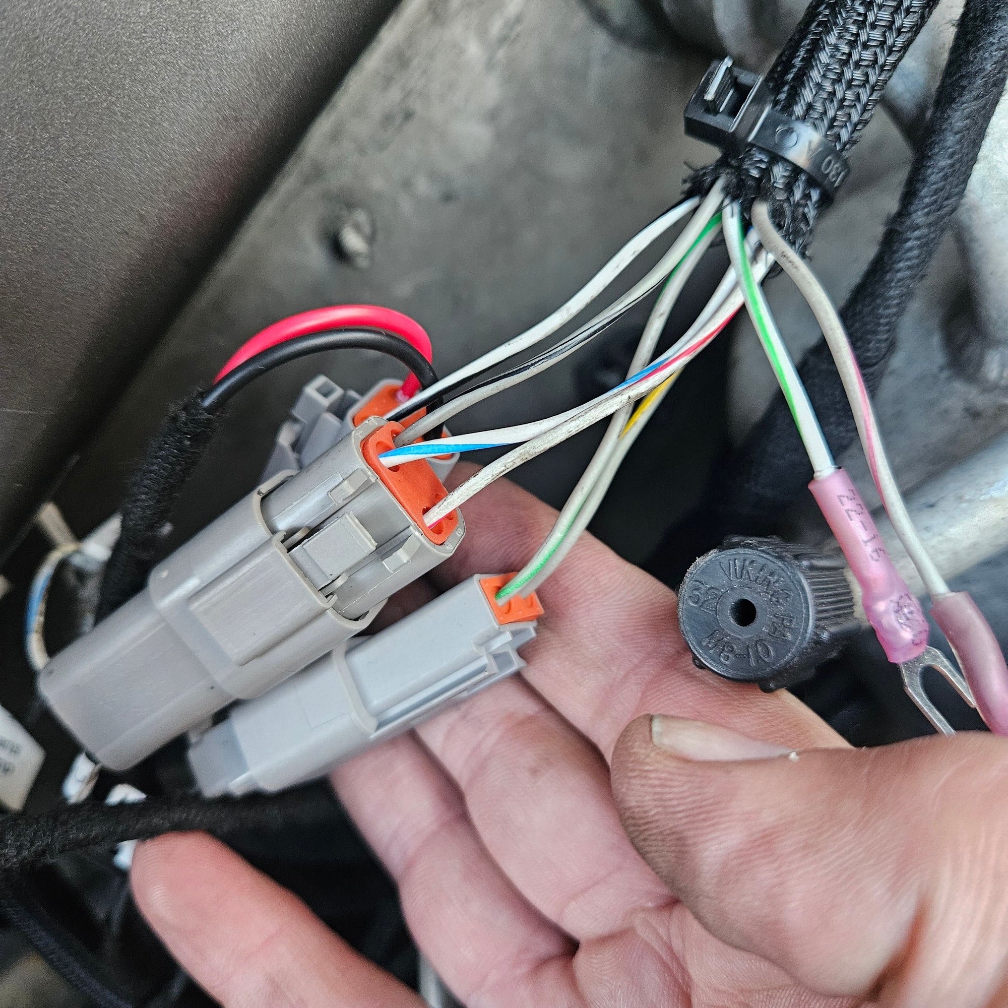

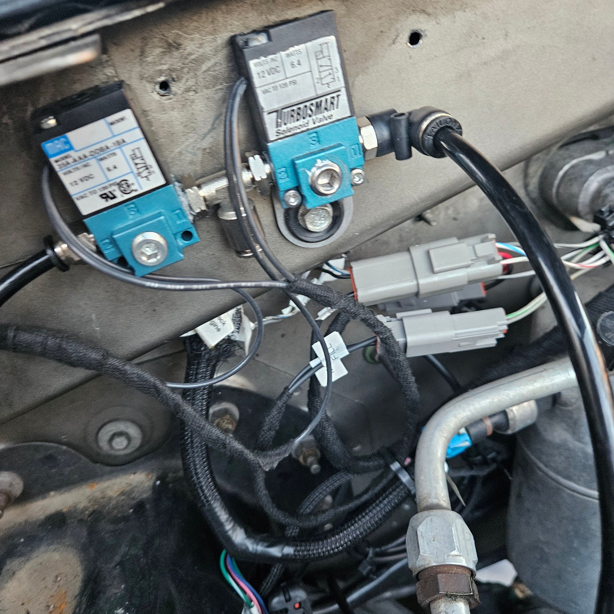

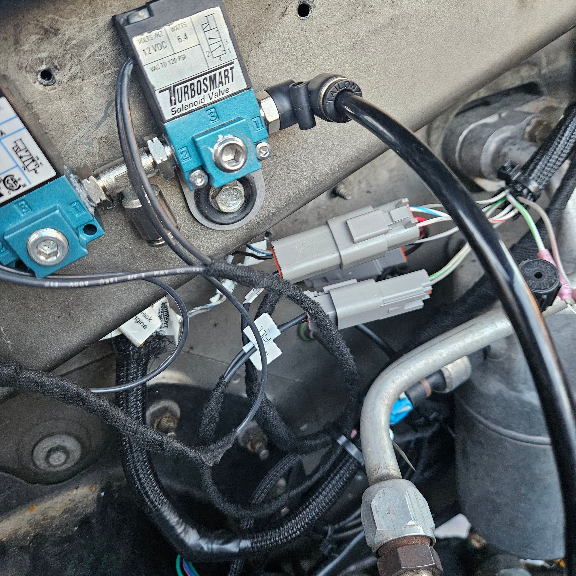

Originally Posted by Tommy42088
Better? I have a bracket coming tomorrow for the mac valves
Where did you get the labels for the wiring?
I'm starting to plan out mine and want everything clearly labeled moving forward.

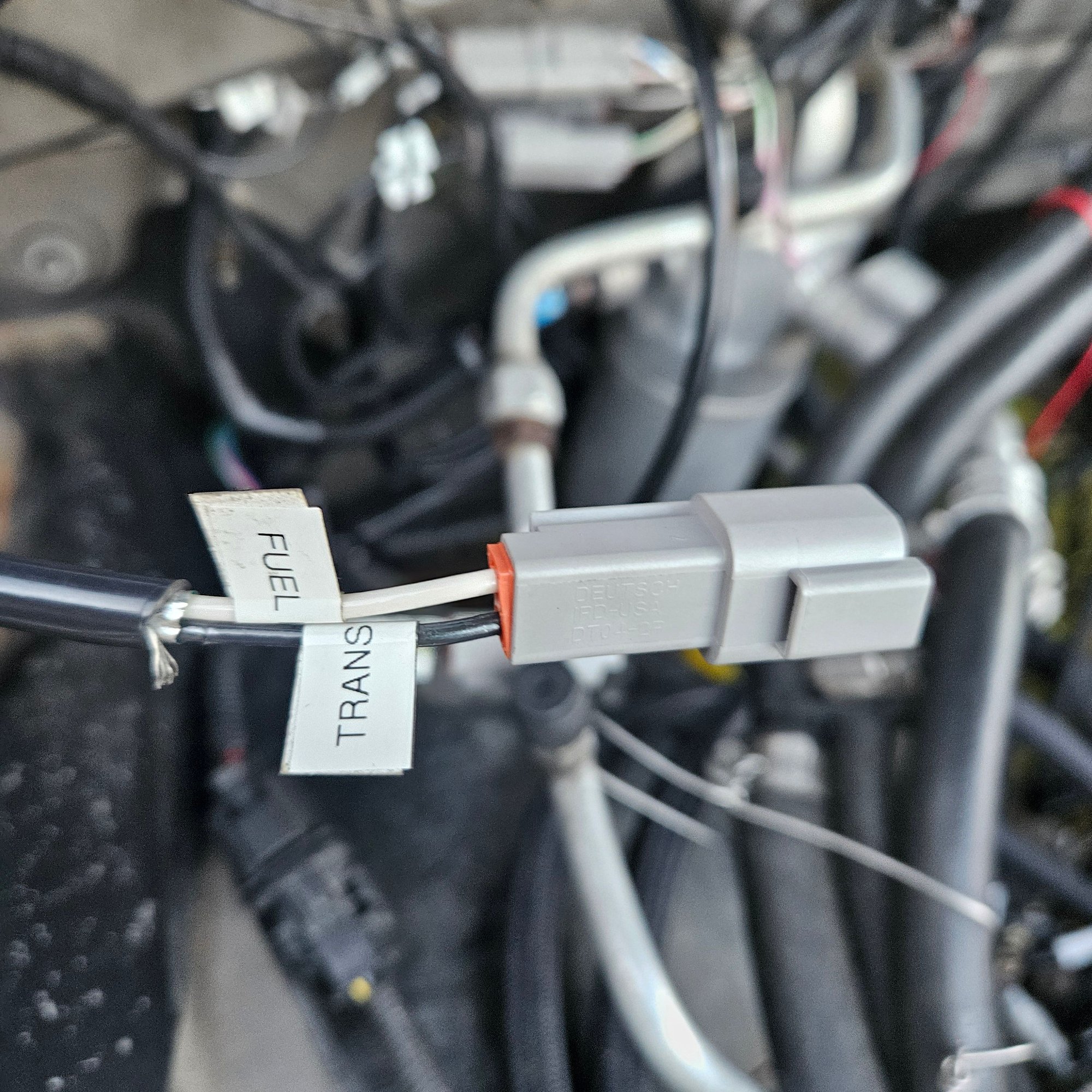

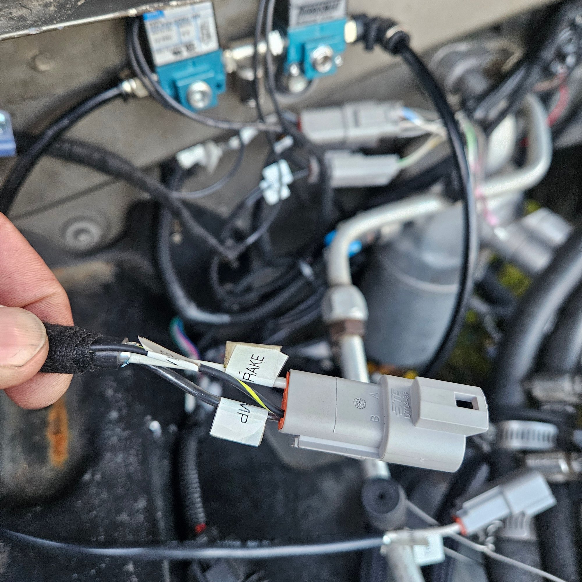

I have a label maker at work and typed everything up and brought it home. They are cheap though, just go on amazon and order a label maker.
Great, one last thing if you please.
What Deutsch connector kit did you do go with?
I see several on Amazon ranging from $109.00 all the way up to $400.00 so I don't want to buy the cheap one and find out they suck lol.
I bought the cheap kit and it works fine
