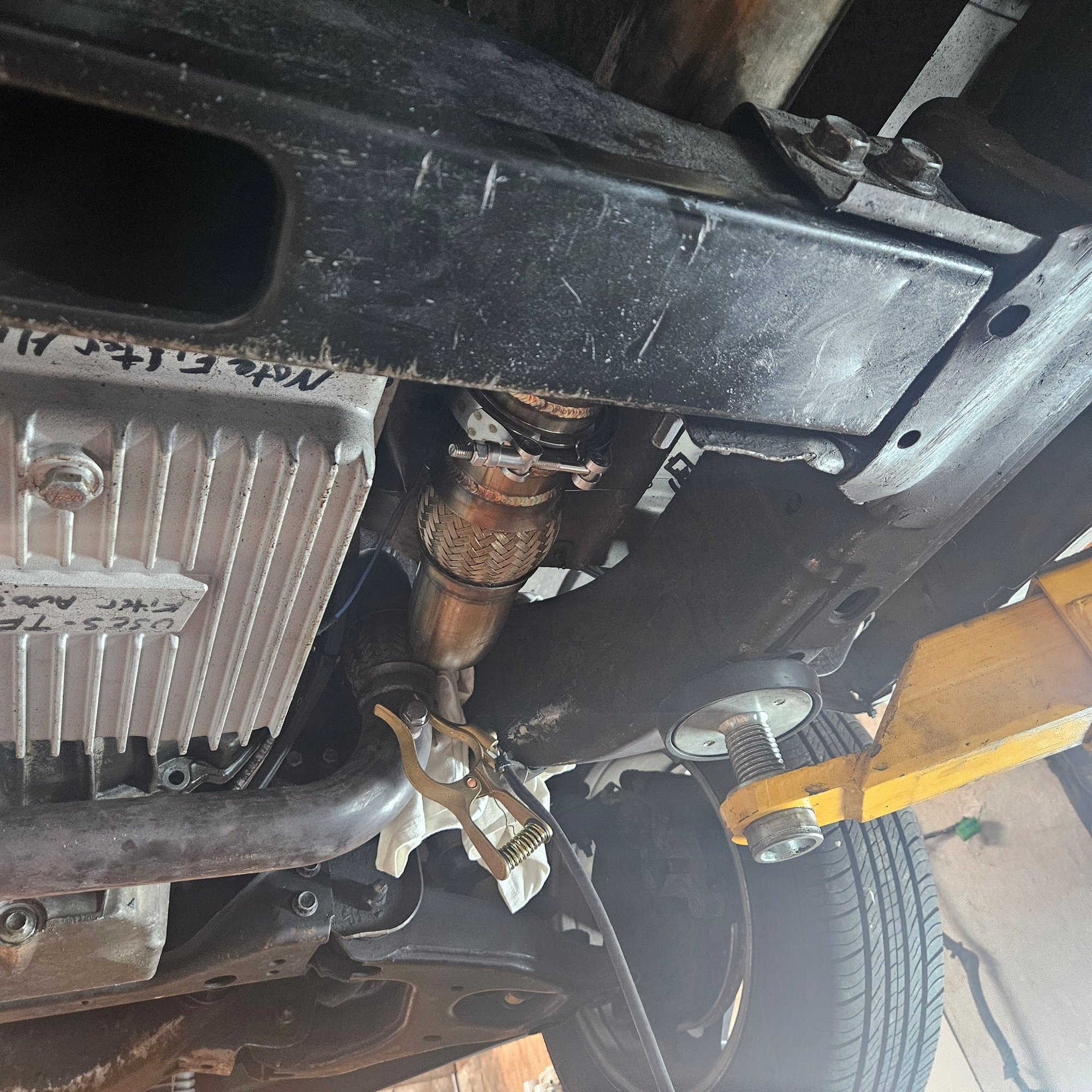

*Saturday im going back to my tuners and were going to do the exhaust, the flex joints on the down pipe are leaking as well so were going to fix that also. You could hear it when we put the truck on the dyno. I have a video but i dont know how to upload it from my phone. Also he wants to but some more brackets for my intercooler so we will probably do that too, he also wants to get rid of any couplings on my truck and put the quick releases clamps, we may not make it that far though, we will see how time favors us.

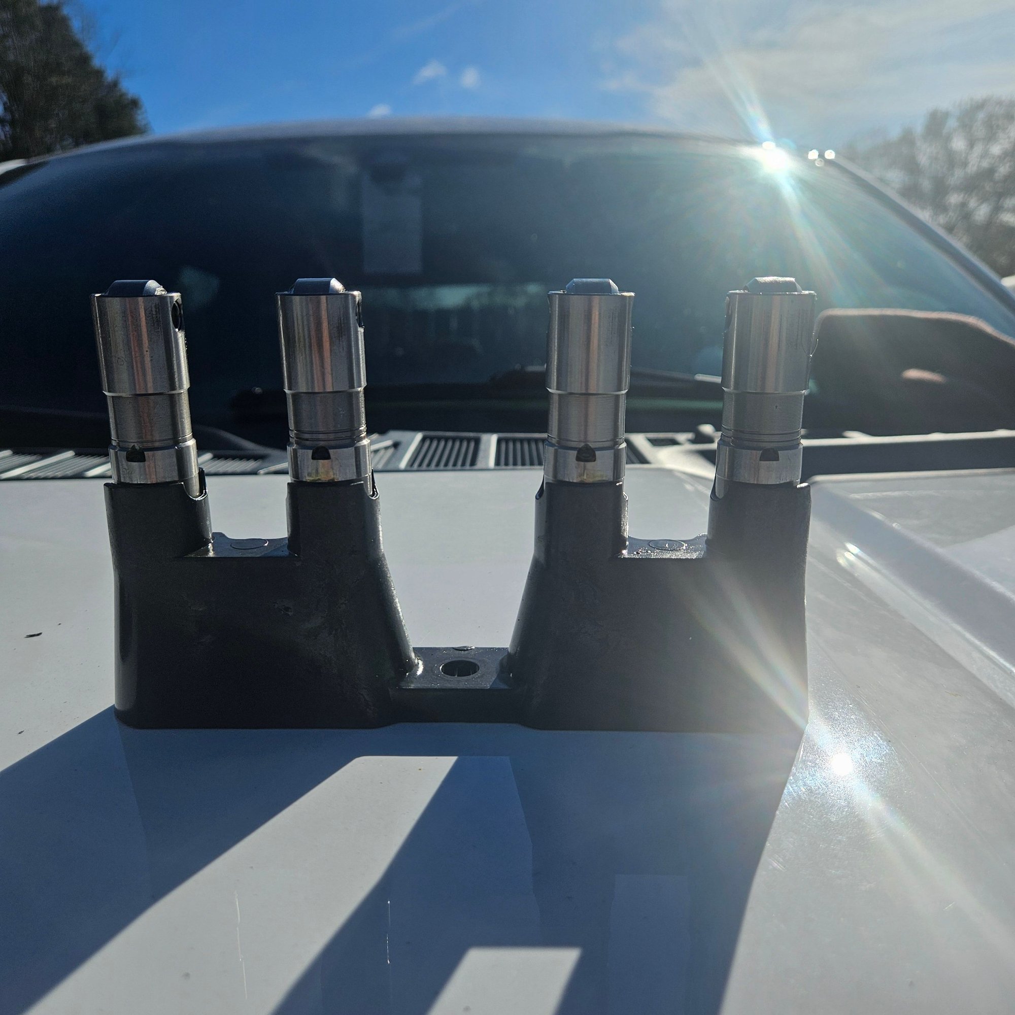

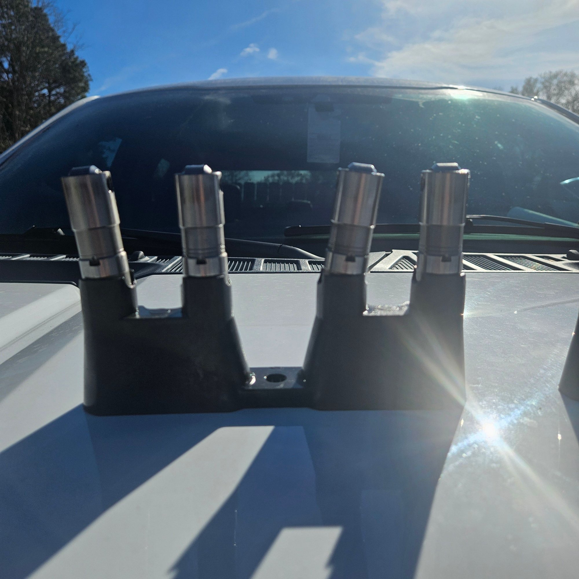

1 & 3 lifters are damn near falling out the trays, this is where the noise was coming from.
5&7 still pretty snug, didn’t hear any noise from these cylinders. Im still going to change all 4

Motor looks good though, a little carbon on #3 but oither then that everything looks fine. No wear marks or anything on the cam.

Are those GM lifter trays?
thats what ive been trying to figure out, I know to buy gm lifter trays but ive been looking for the receipt all day trying to figure out who I bought them from and I cant find it for the life of me. Ive searched my emails high and low.

There should be a part number on them

Why would the lifter trays cause noise?
don't think they can , there purpose is to prevent turning to keep the wheel aligned, loose up and down won't hurt anything but if you can feel play in a turning motion that could cause a problem

I had a set of Morel lifters do the same thing as OP is describing. After a WOT pull they would get noisy and then quiet back down after a bit. Never had an issue with them besides the noise. I was revving the engine to around 7600rpm. I was using 20w-50 oil and they do not recommend that weight for their lifters.

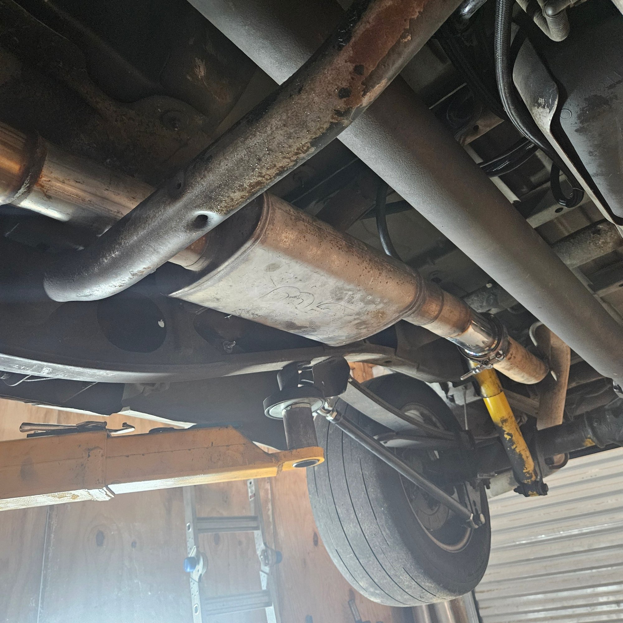

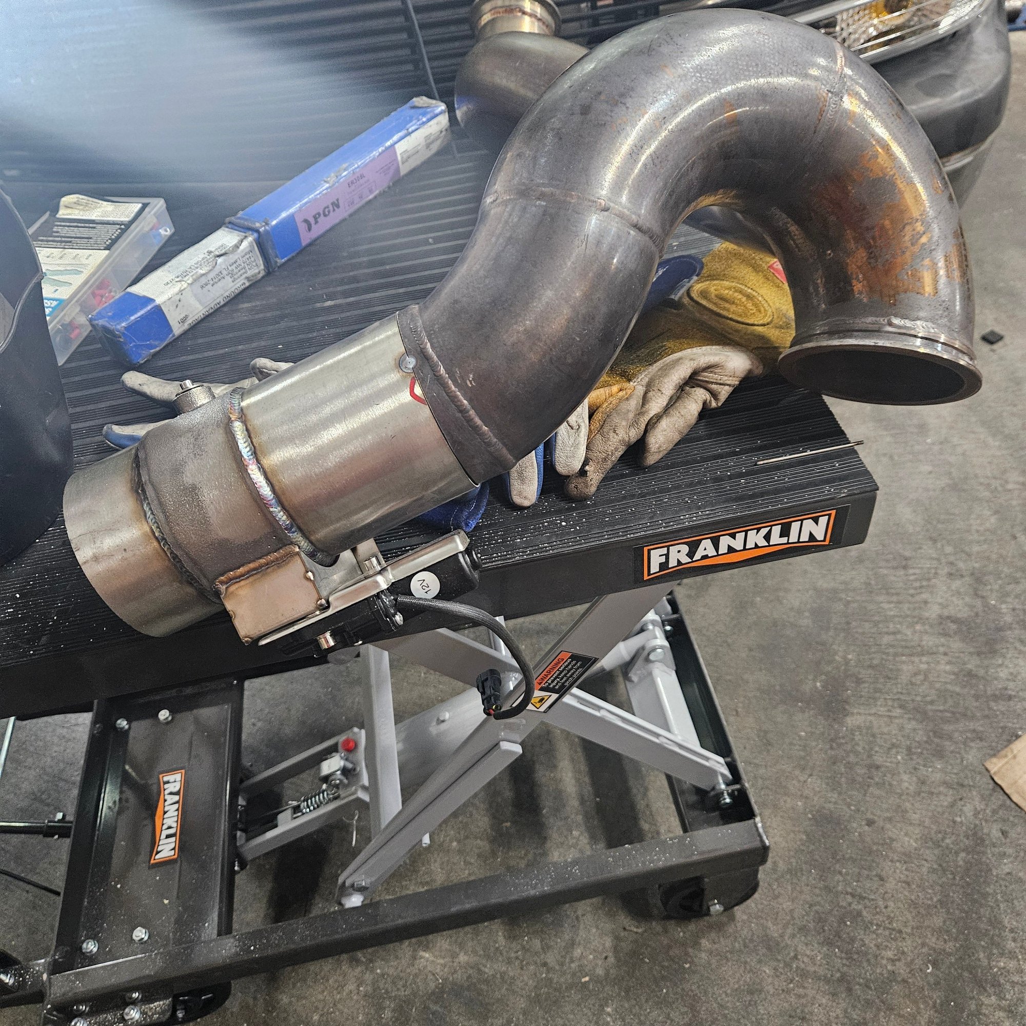

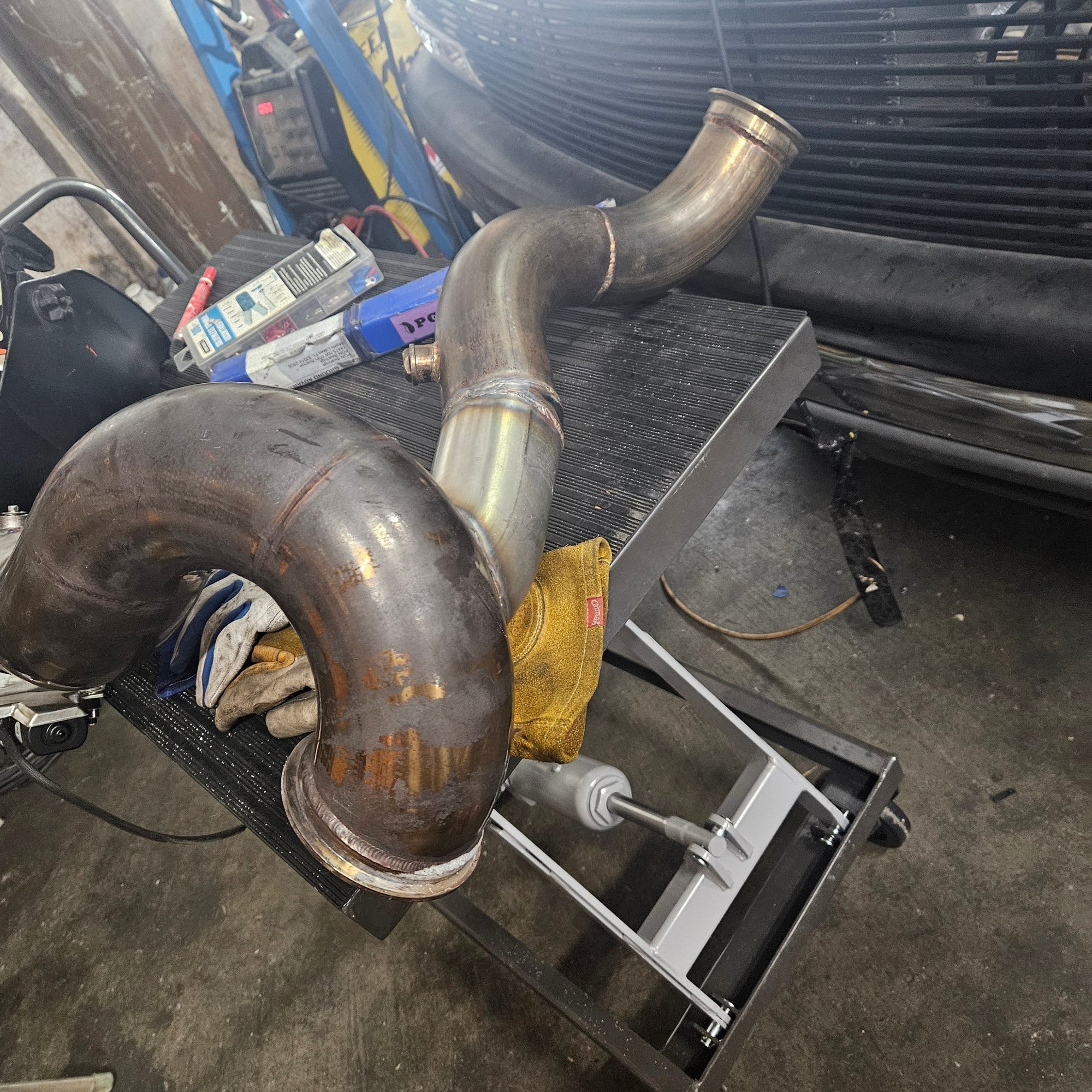

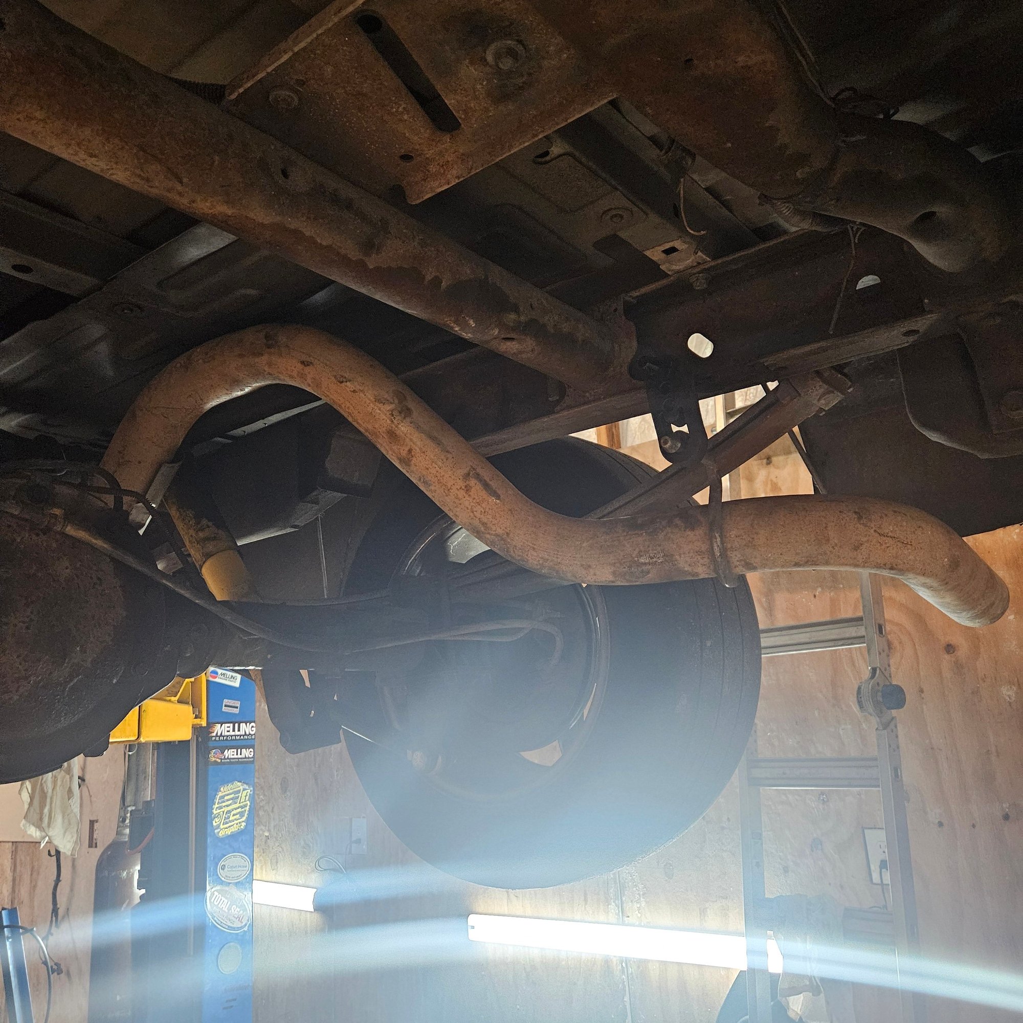

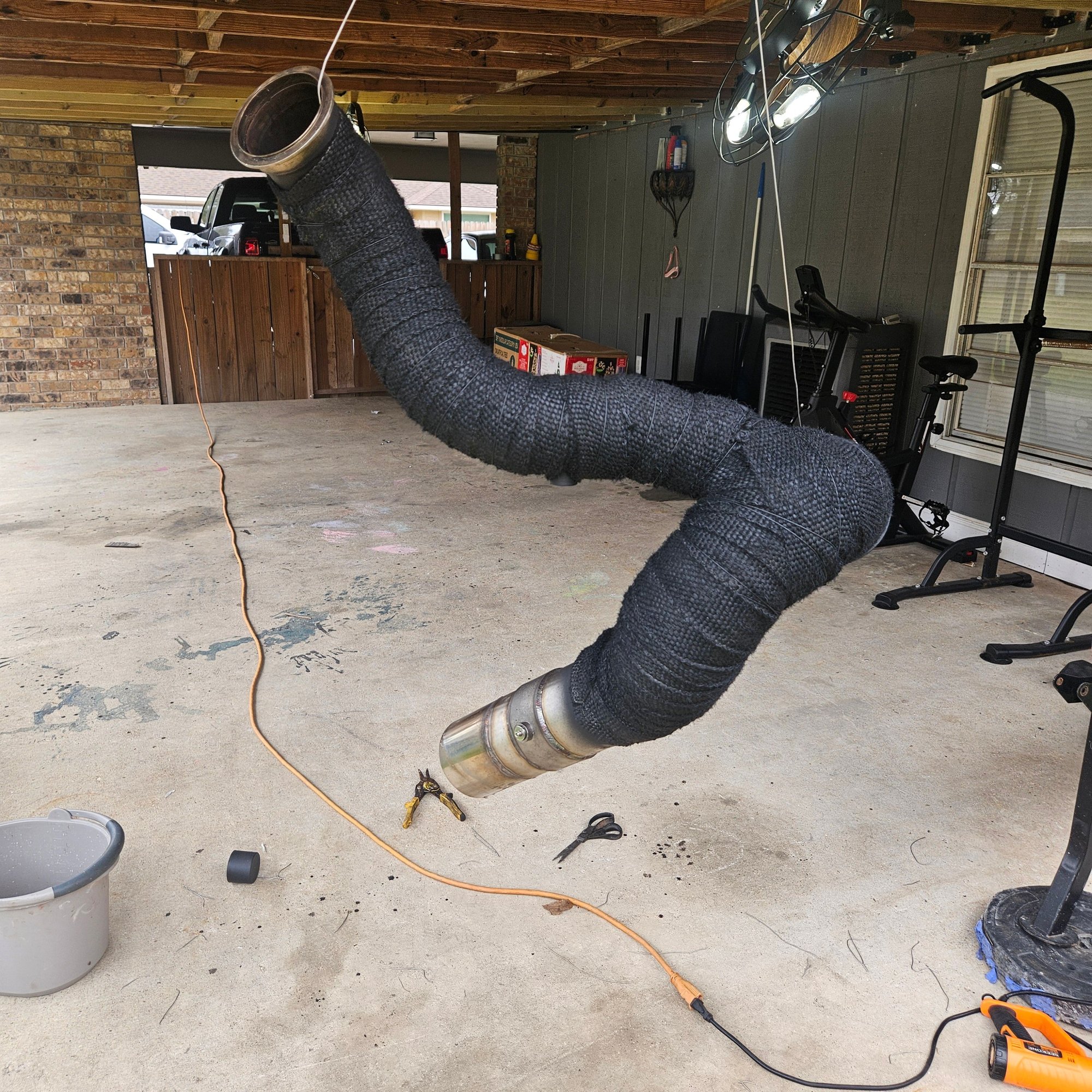

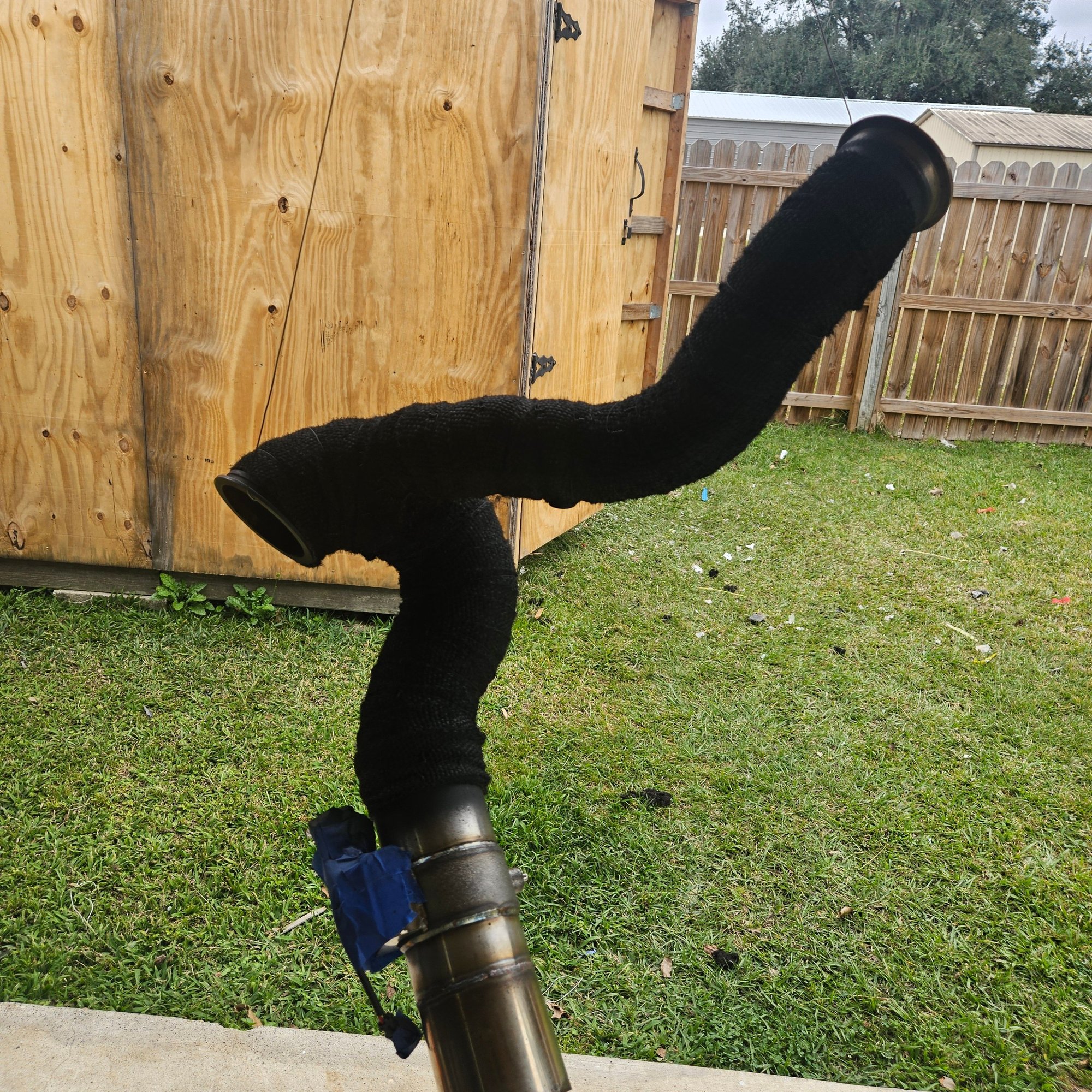

Got the exhaust back under the truck, tieing the 3 inch to the 4 inch fender exit was interesting to watch. I made an attempt but it was kicking my butt so my tuner stepped in and made it happen. He pie cut a few pieces with this big band saw looking thing that you bolt the pipe down too and set your degrees. That tool made it happen and of course he welded everything. Im just waiting on the paint on the wrap to dry and the cut off is remote activation. I just kept it that way, the only thing I changed on it is its made to hook up to the cigarette lighter. I didnt want to do that so I just ground it and gave it key 12v.

Nice, that looks killer. You'll be happy with that set up for sure.
sounds like a stock truck with a cam, much better!! The turbo noises are neat too now that I can actually here alot better.
Are my eyes bugged out, or are you using 2 different types of lifters?????
