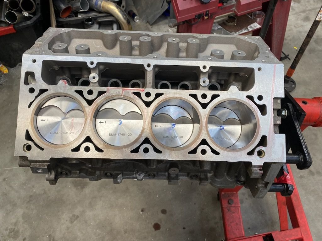

Machine shop finally finished with the block. Balance, hone, and cam bearings took much longer then expected.

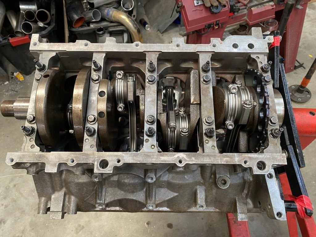

So the guy putting my shortblock together sent me these numbers. Man this the kind of stuff i need to learn because I dont even know what this means
Crank bearing diameter Tolerance
#1- 2.0990------ 2.1015 ------- .0025
#2- 2.0990 -------2.1015------- .0026
#3- 2.0986------- 2.1015-------.0024
#4- 2.0988------- 2.1017 -------.0029
#5- 2.0989-------- 2.1015------- .0024
#6- 2.0989 --------2.1015 -------.0024
#7- 2.0988--------- 2.1018------- .0024
#8- 2.0989--------- 2.1017--------.0028
Old May 15, 2025 | 07:38 AM
  #952
LS1Formulation's Avatar
Posts: 3,890
Likes: 1,137
From: Grand Rapids, Michigan
That's the bearing clearance for your rods, which I would say is a little excessive. Steve Morris set my clearances at .0022-.0023 on the rods and .0026-.0027 on the mains, with the thrust at .0030. My crank measured out closer to 2.100", though. You may want to try a different set of rod bearings to see if you can tighten them up slightly, especially #4 and #8.
Old May 15, 2025 | 03:35 PM
  #953
NoGo's Avatar
Joined: Jan 2002
Posts: 2,814
Likes: 110
From: Mass
Those are fine.
The Clevite CB663HN rod bearing is a pretty common, performance, standard size LS bearing that I've pushed to >1000 flywheel on 3 engines with no issues. I like Clevite/Mahl because they actually publish their tolerance requirements. Their specified min/max is 0.001 to 0.003 (https://lspartsdirect.com/clevite-ma...g-ls1ls2ls3ls6). Also, if you pull the Mahle technical guidance (https://www.mahle-aftermarket.com/me...l77-1-205r.pdf) you'll see they will park you in the 0.0025 to 0.0035 range as a starter.
Also, if it helps, the last 2 builds I setup were at ~2.5. I just pulled the bearings on one of those engines and they looked perfectly fine.
When you start getting within fractions of a thousands type of tolerances it starts to come down to how accurate your machine shops tools are and were they all measured on the same day with the same shop temperature, does the bearing have a coating, etc, etc... People on the forums get pretty excited about main and rod bearing clearances, but if you have built a handful of motors you will see that mains and rods will run fine all the way from 0.0008 up to 0.0035 - you just want to be on the bigger side with bigger power setups.
Old May 15, 2025 | 04:05 PM
  #954
Tommy42088's Avatar
Joined: Oct 2022
Posts: 1,776
Likes: 627
From: Louisiana
Originally Posted by NoGo
Those are fine.
thanks for the update, the guy building the shortblock said this is all within the Tolerance. He said crank Tolerances all came in with .0030- .0033 but I just didnt listen that picture.

We getting there fellas, hopefully this weekend ill throw the heads on and try to get it at least in the truck.
We getting there fellas, hopefully this weekend ill throw the heads on and try to get it at least in the truck. My guy did me a nice job from what I can tell.
