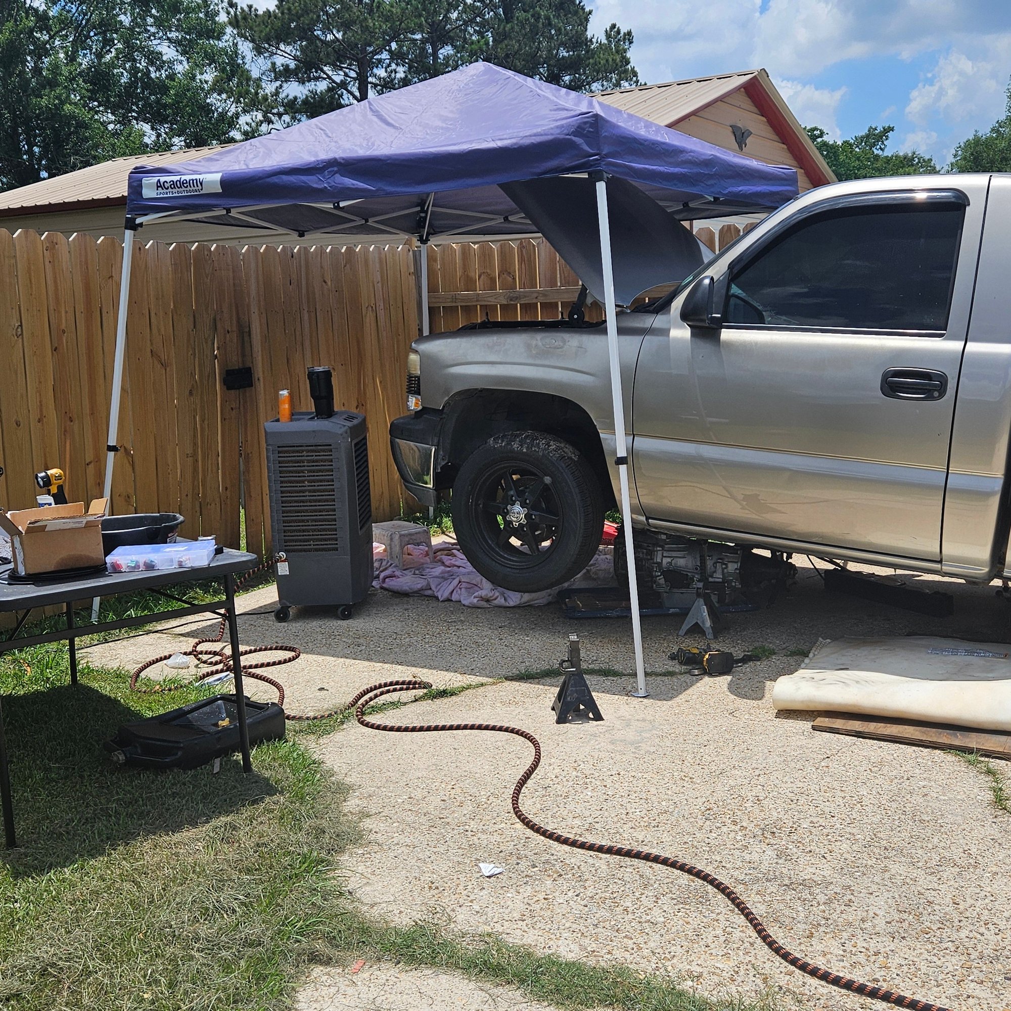

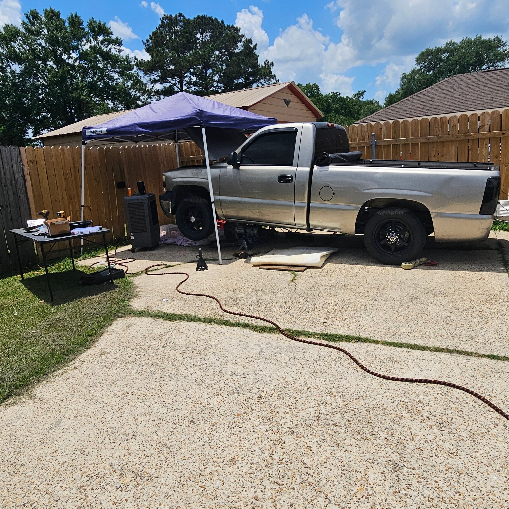

Im getting there fellas, if this Louisiana heat doesnt kill me first

Ive been a supervisor at work way too long, this Louisiana heat is kicking my ***

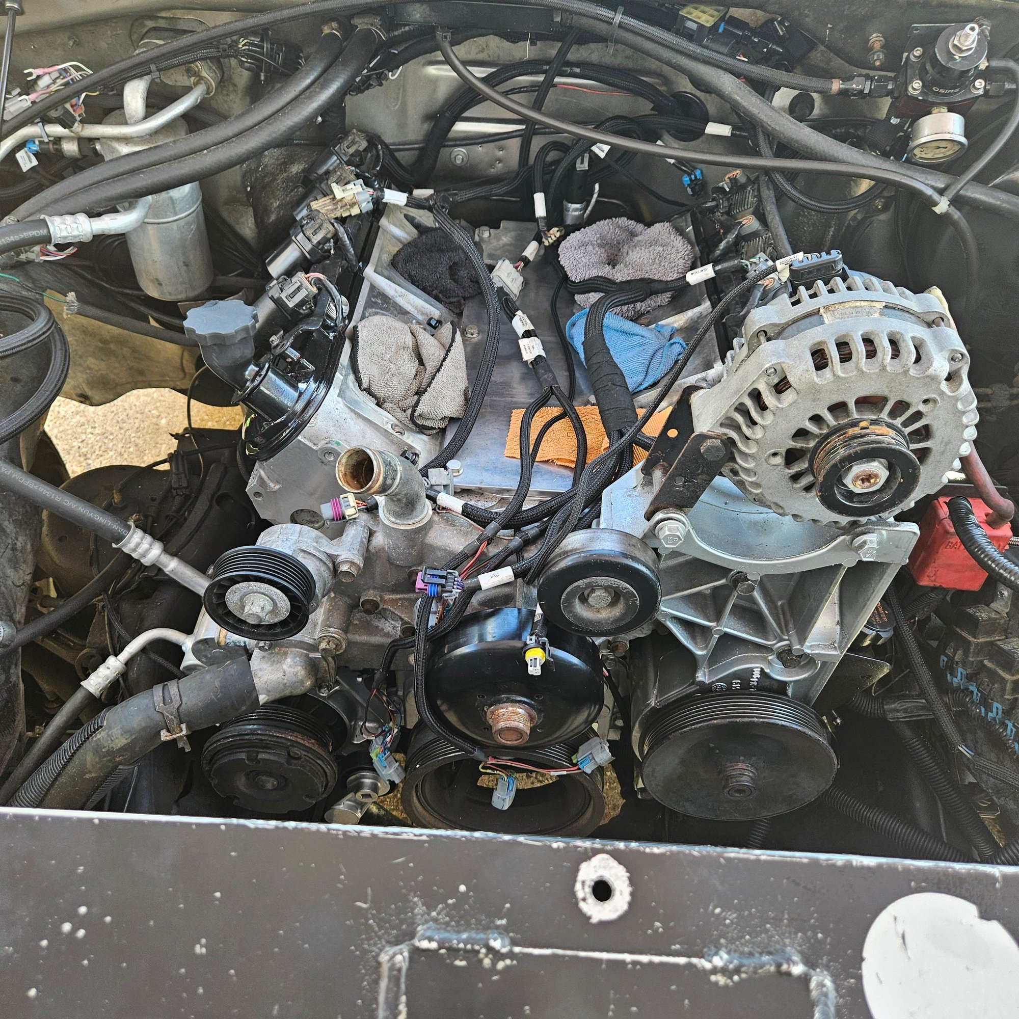

I put the motor in yesterday, put the trans in today, buttoning all the stuff up under the truck now and the holiday tomorrow gives me enough time to put the turbo stuff tomorrow. My tuner is going to take over my computer with any desk and make the changes on all the inputs and outputs tomorrow as well and tweak the tune also then ill take it to his house because I want to put it back on the dyno and he wants to look over the tune a little more anyways.

is it normal that im nervous to turn the key? Im hear picking up tools knowing I don't get a damn about these tools. But everything is together, all seriousness im getting some fresh e85 now then ill hook the laptop up and get my tuner on the other end while i crank it so he can see whats going on since i havent learned my way around holley yet.

Good oil pressure, but holley is not showing cam or crank signal, what am I doing wrong? I used the cam sensor that goes with the lc9 and I used the conversion harness that switches the wires

Its alive!!! I tried to upload a video but its not letting me. I ended up leaving it there so he can weld on the new wastegate and get it completely dialed in and be sure all the bugs are worked out. So apparently on the 24x harness you have to move j1 b20 to 5v reference and cam and crank ground had to move to sensor ground when putting the aluminum block. Did that and it fired right up.
