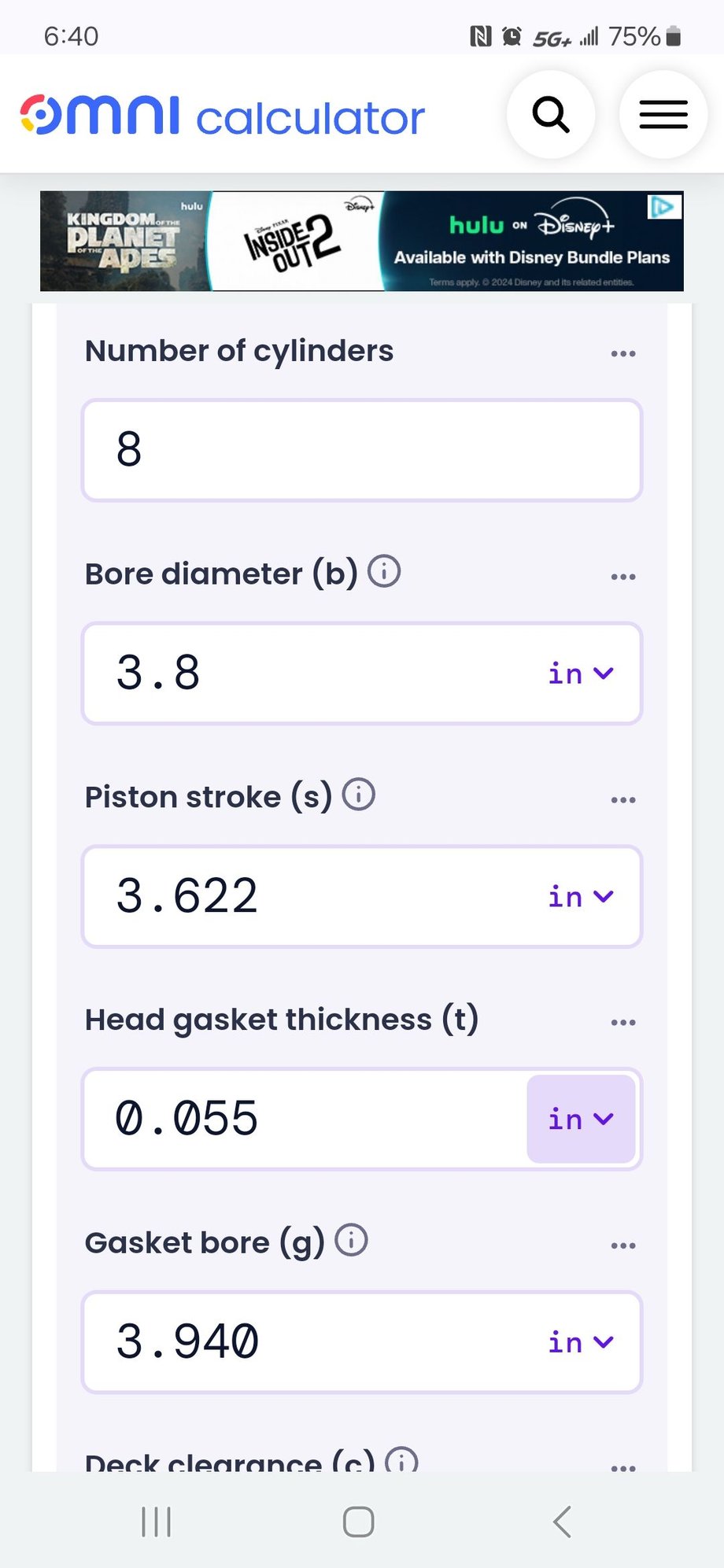

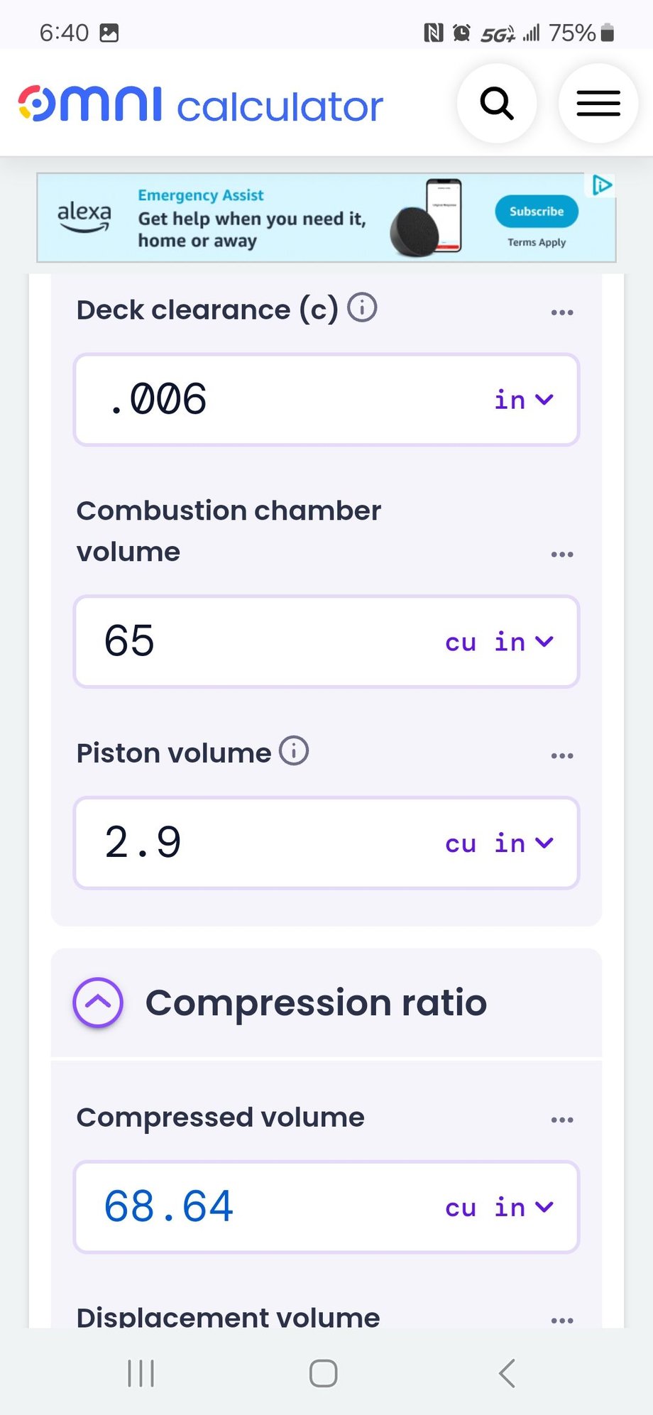

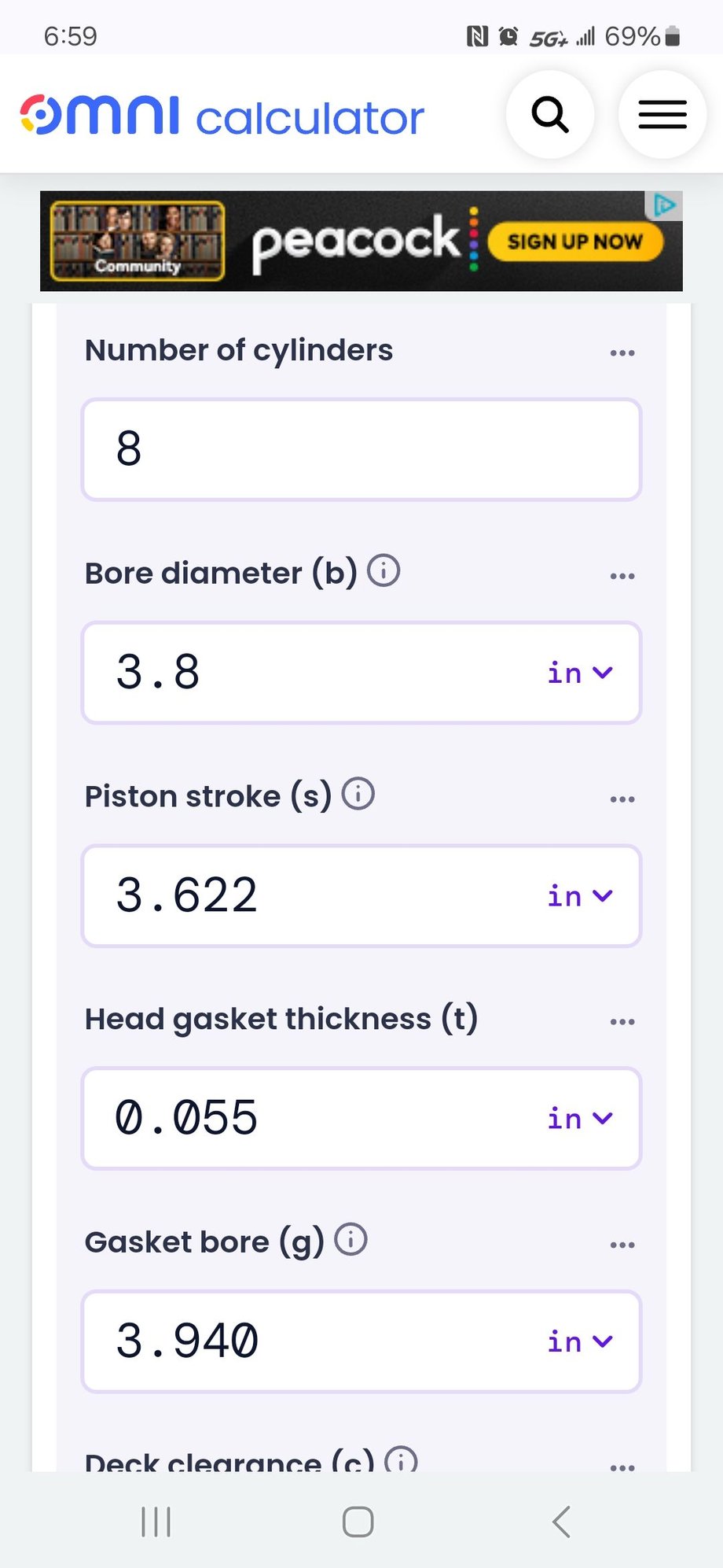

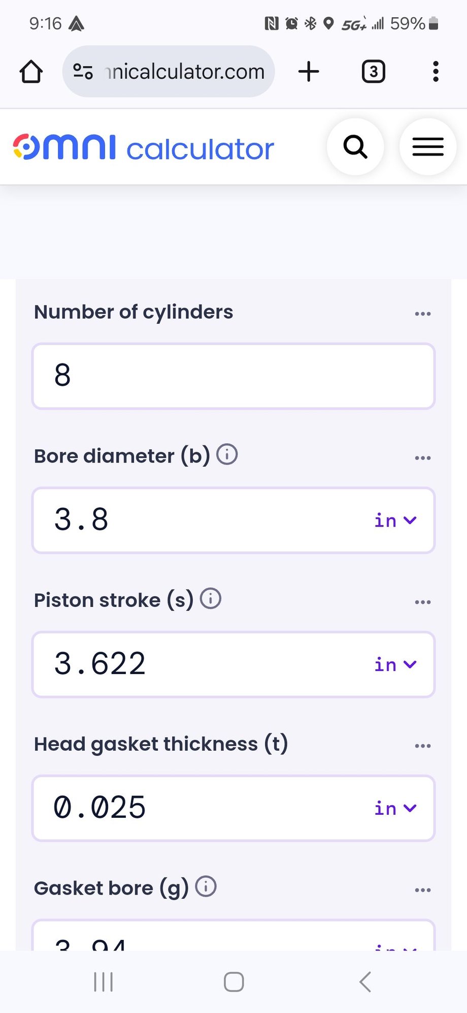

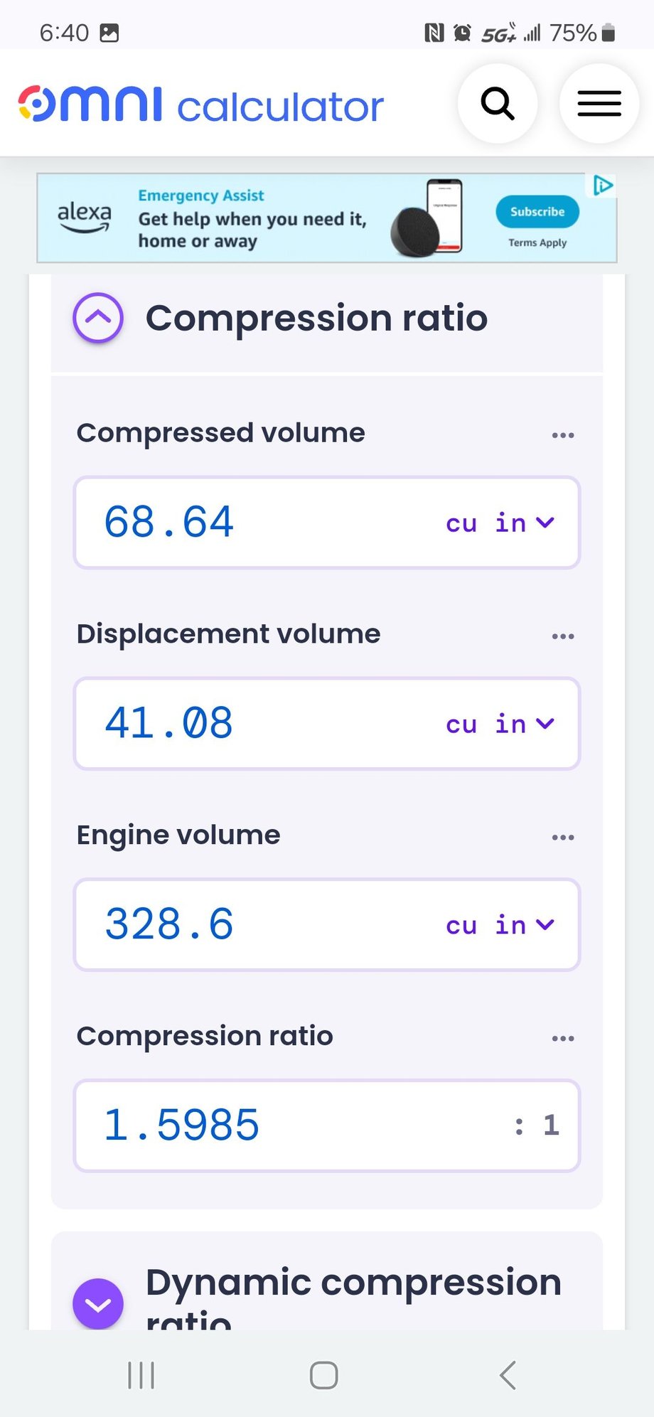

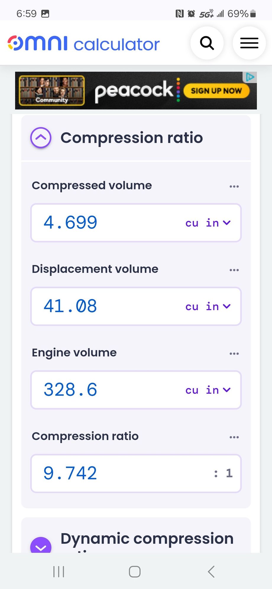

What am I doing wrong?

Don't know, but I put your # into the wallaceracing.com calculator and get 9.41 : 1 ratio

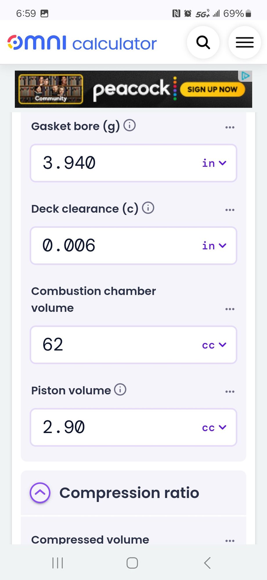

Alright I think i got it now, I didn't have it cc on the ones that needed to be cc and I changed the combustion chamber to 62cc because the heads are ported

yeh I figured it out and that's what I got, but I changed the 65cc to 62cc because the heads are ported. There also milled .040 so how would I calculate that? Could I just subtract that from the head gasket number and put it at .015?
porting isn't going to reduce chamber volume, if any unshrouding has been done that would increase it , unless there has been some welding/ reshaping done - unlikely . Someone must know the number of thou per cc for milling these heads . Subtracting from the gasket thickness will be fairly close but not entirely accurate as the chamber is not round and the size of the gasket. Maybe put in .025 for gasket and you'll be real close, probably 9.6 - 9.7 .

I get 9.66 doing that

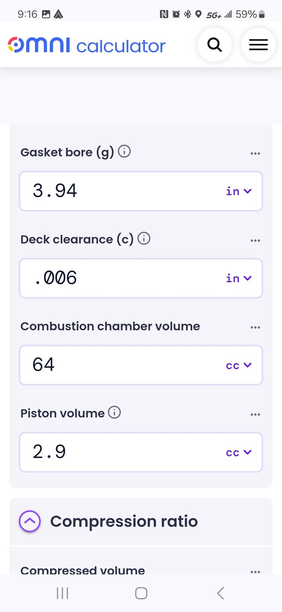

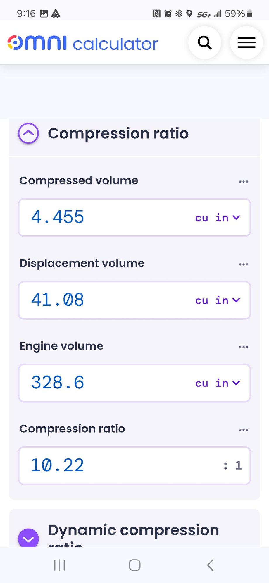

understood, I put it 64cc because that's what it says 243 are factory and I changed the gasket to .025.

10.22 is what I get on the wallace calculator also. Should be safe and work well with E85

I was just gonna say you should be a little over 10:1 which is perfect on those 5.3’s let alone any performance street motor…..congrats, its gonna be a BLAST…..just make sure your cam and convertor jive together……3000 stall is always fun on the street and not too rowdy but not lame either!!!

hell yeh thats good then, it was definitely fun before so im hoping its that much better this go around.

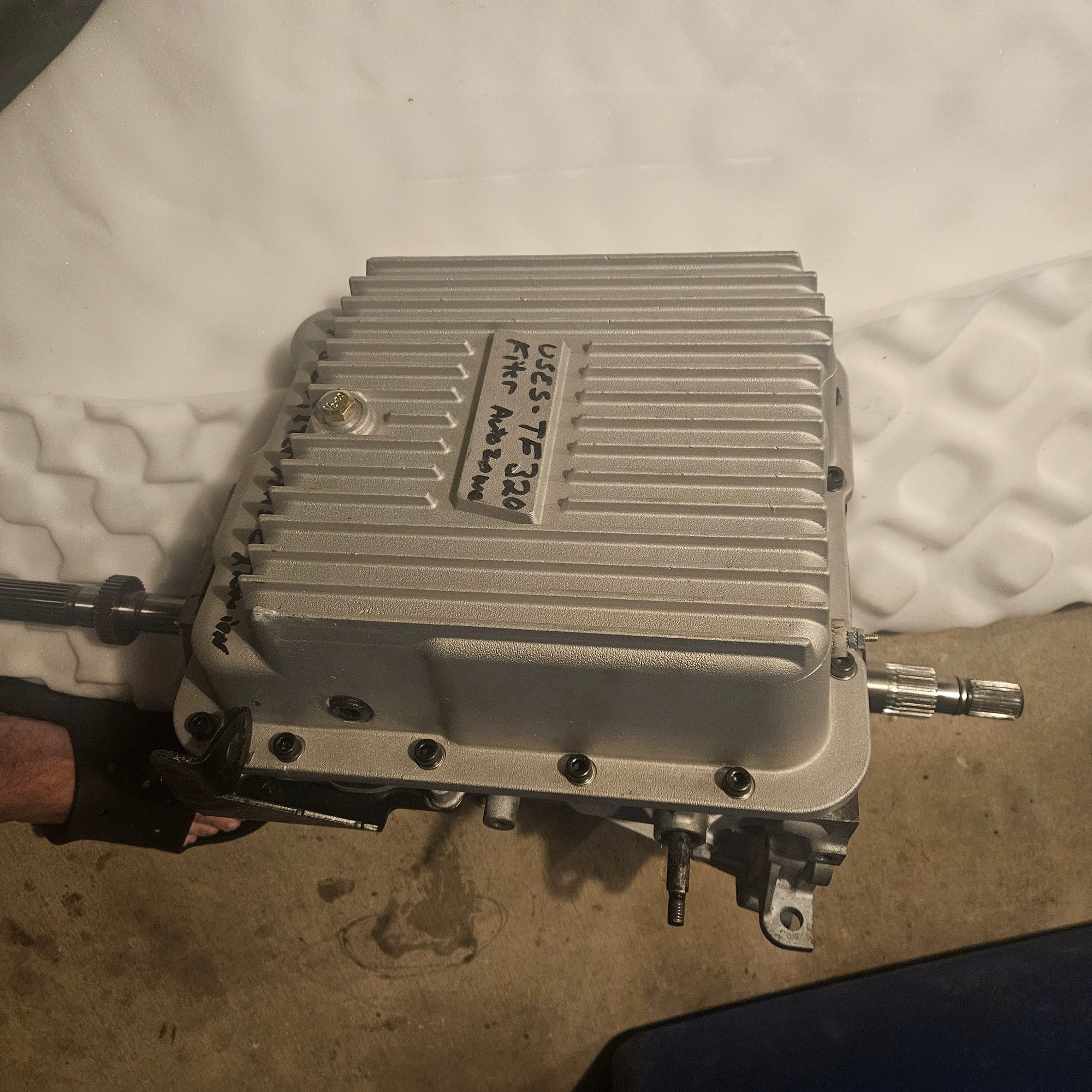

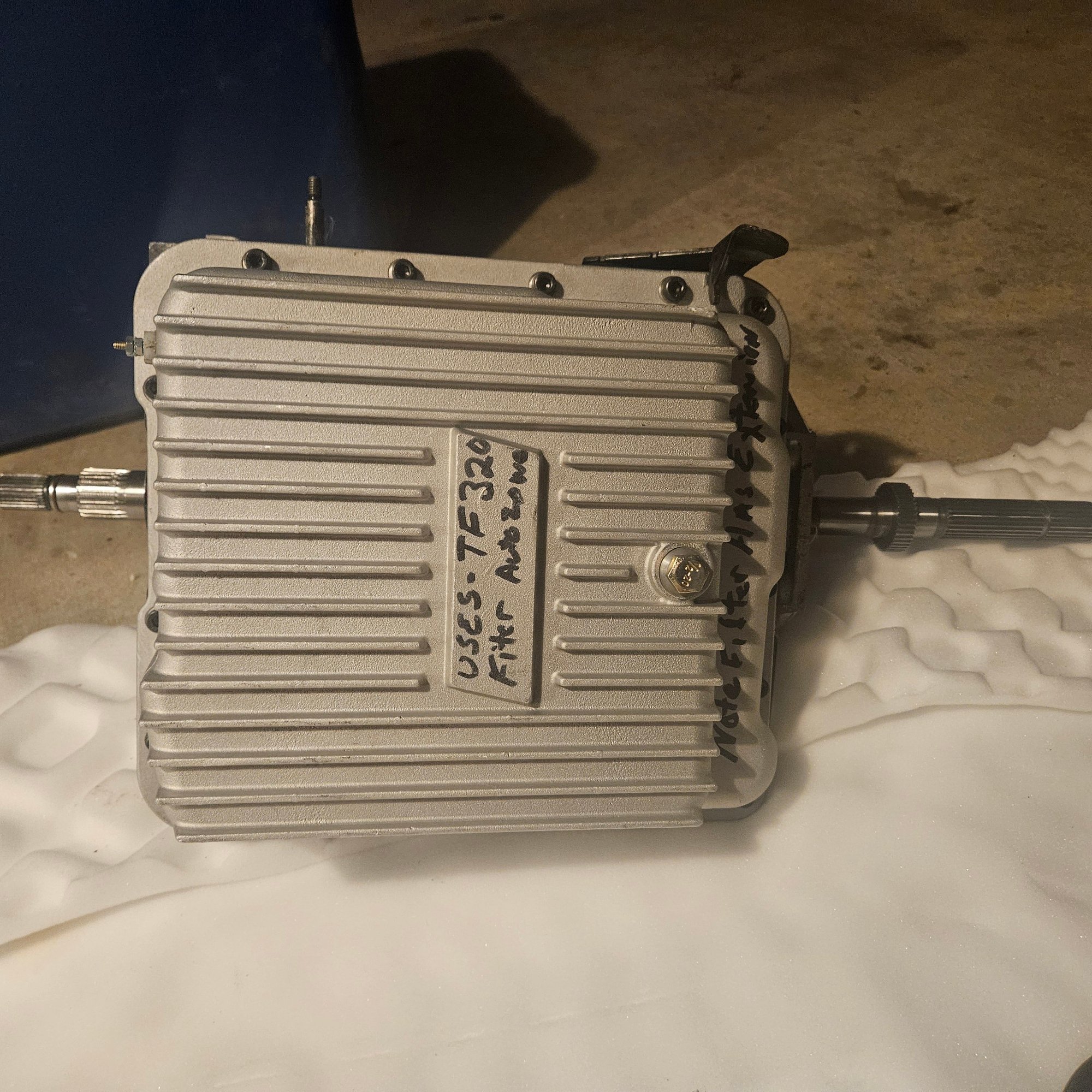

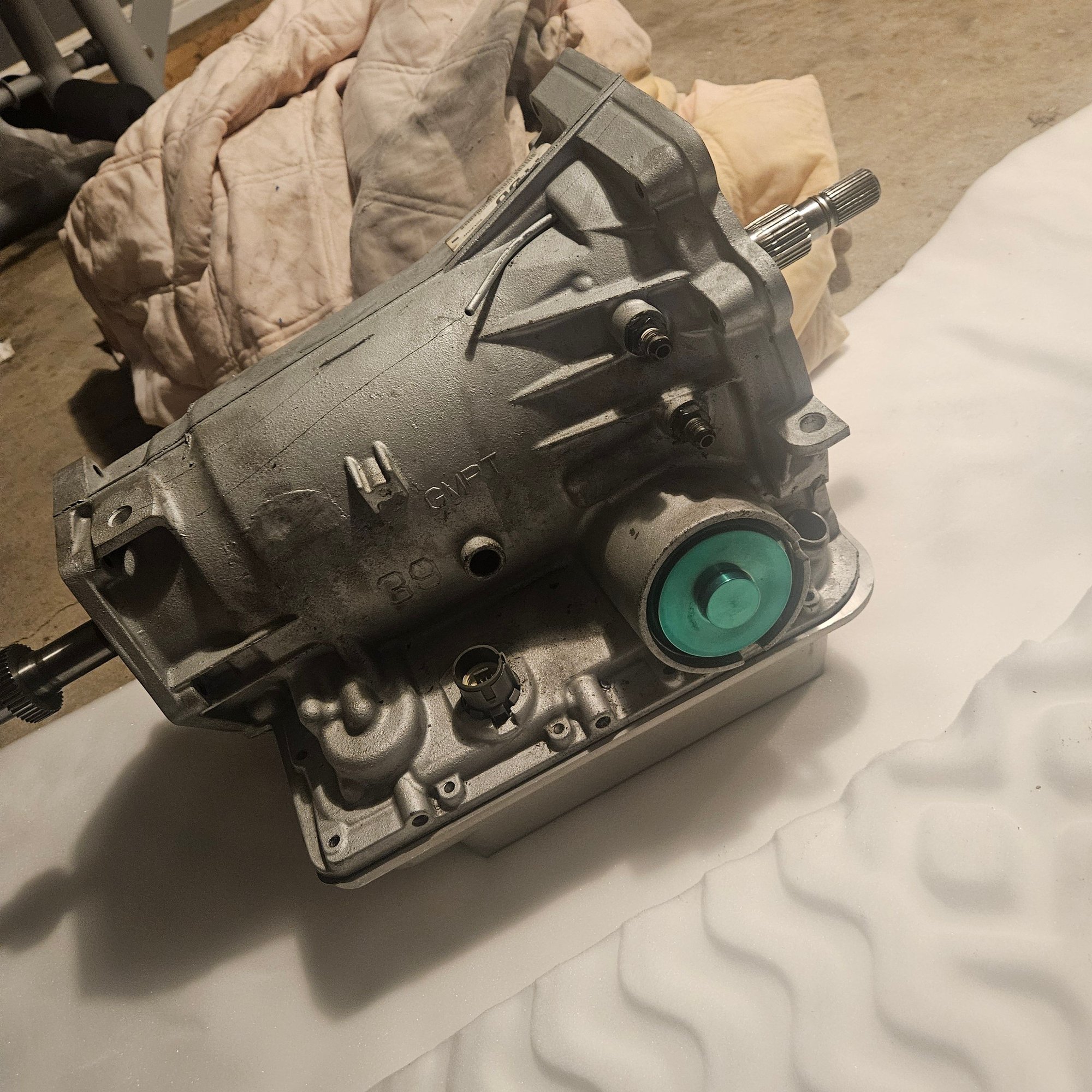

got the transmission back from Frank yesterday, still waiting on the machine shop to finish with the shortblock. Hopefully get it back soon. Dont want to rush them to much
