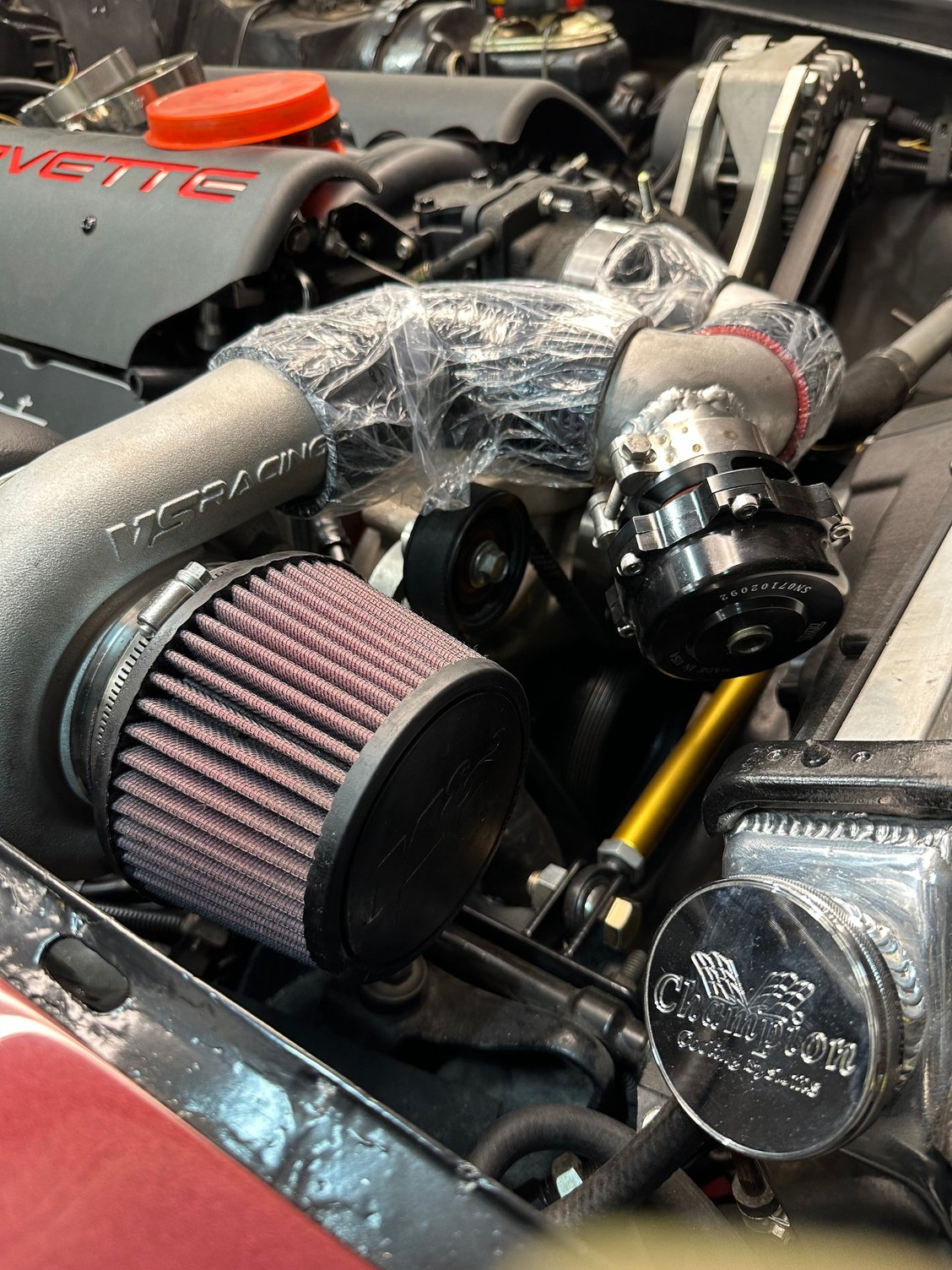

Originally Posted by customblackbird
Cheap fuel makes the car easier to drive. I've heard that pre spray into the turbo will eat the impeller blades. Car would see 100 or so miles a week just driving to work, would love to take it on some longer trips 2hrs+.
interesting... I got a brand new 300psi snow pump for $80 off FB market place. I'm reusing old snow nozzles I had from another kit that I'm not using on my firebird. basically the pump is the only cost and a $25 devils own tank bulkhead adapter which I converted the stock wiper tank with. I was actually planning to run a relay and have the pump controlled by the Holley Term X. I can setup and output pretty easily. Currently using only one as PWM for brushless cooling fan. Are you saying that a 2PGH pump from snow on the 300psi pump will really put out 4GPH? It looks like snow rates them at Boost Cooler Hyper-Sonic Injector, 125ml/min@100psi or 2GPH, this is for size 2. I think the nozzle has the built in check valve as well as I tested it with an air gun. https://www.snowperformance.eu/en/wa...zzle-sno-n0200
I was thinking of tapping the cast elbow right after the BOV for the nozzle, that way it has 18-24" till it reaches the IAT sensor in the intake. I also thought that I would get some wiper fluid spraying out the BOV when it opens and the same if it was in the turbo filter head. Putting it in the filter means the turbo blades could get eaten up but then I would have it definitely coming out the BOV when its open.
this is the setup for the cold side.
Blade erosion is mostly band wagon BS from people with little or no experience. The only way you are hurting the blades is with giant water droplets IE no nozzle at all. Combined w tiny turbos spinning at 100k+ over long periods. Something similar to a small diesel engine. Your 70mm won’t spin fast enough to cause an issue and the nozzles used these days do a plenty good job, even at relatively low pressures. Nothing wrong with using a good pump if ya got it cheap. Its just overkill for 6lbs. And if you spray washer fluid (even at 4gph) at 6lbs it will likely hurt power and response.
Also totally pointless to buy that new fancy sensor if you are going to mist water on it. Water will not evaporate in your charge pipe at your temps. So the sensor will spit back completely useless bunk info. Good for nothing but letting you know the kit is “on”.
Pre turbo increases the eff. of the turbo itself. No other location can do that. No reason not to if you don’t run an intercooler. You also don't need to fight manifold pressure pre turbo. So you will atomize better. Turbo helps atomize as well. You don’t need to worry about the kit siphoning back into your intake/charge pipe if you place it on the filter flat directly in front of the turbo centered on the compressor nut.
I ran this setup for years on a tiny 16g DSM turbo I’d spike over 35lbs that likely spun 2x as fast as anything you’ll ever use on a v8. Never had any blade damage. Plenty of atomization. Don’t buy into the kit hype. The prices are ridiculous for something that mists water in your engine. I’ve had a pre turbo setups on a ton of v8 setups. Never saw any sort of blade erosion.

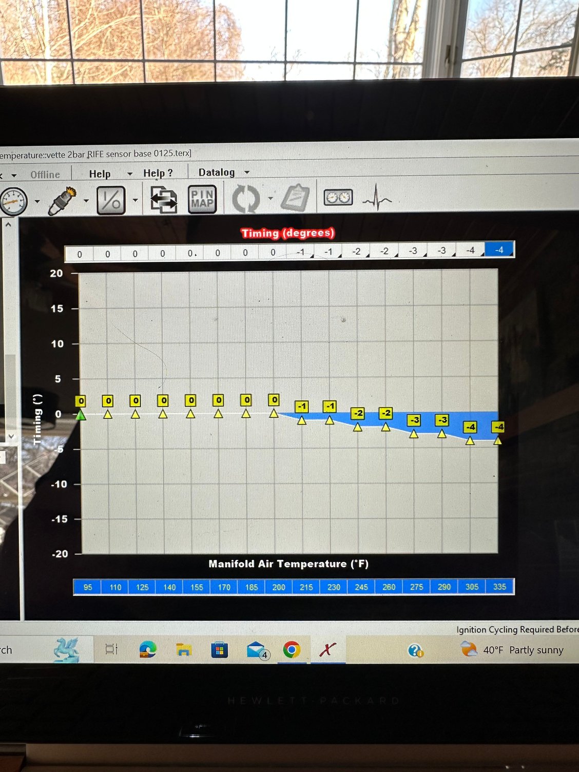

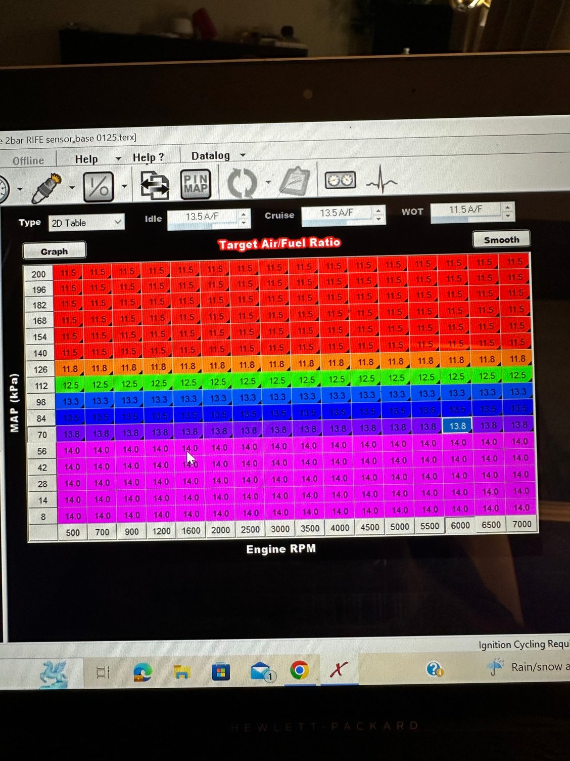

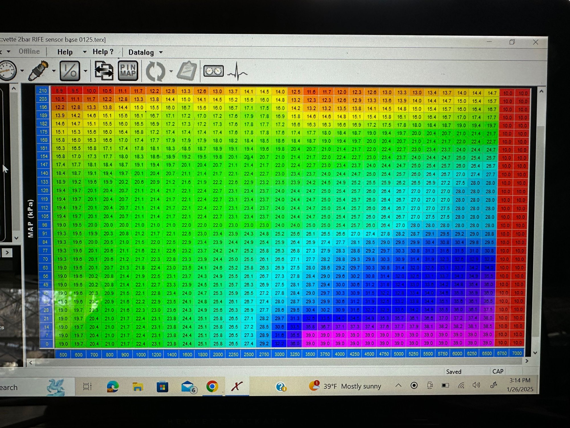

Anyone want to share a 2 bar timing table and a MAT vs timing retard table (Holley if possible) I’m currently
creating a base tube as the car is real close to starting. These are some real rough timing, MAT and AFR tables. I have a 4.6psi spring installed in the WG and I would hope max of 6psi boost. I was trying to keep timing NA up to 4ish psi and then slowly ramp down to 6psi and then drop after that. Non intercooled I would assume 200*F IATs especially with the filter right next to the radiator.
Old Jan 27, 2025 | 04:22 PM
Full Power's Avatar
Joined: Jul 2022
Posts: 1,037
Likes: 390
From: Alaska
Just a real quick glance gives me a data (point) to critique: Looking across your 175kPa row, I see 18 degrees spark at 4000 rpm. That's a little hot for me.
My stock compression 5.3 has to drop down to 6 degrees for 175kPa in the 4000 - 4400 rpm range-- depending on your camshaft events vs compression ratio, your area of peak torque is VERY likely to need much less timing .

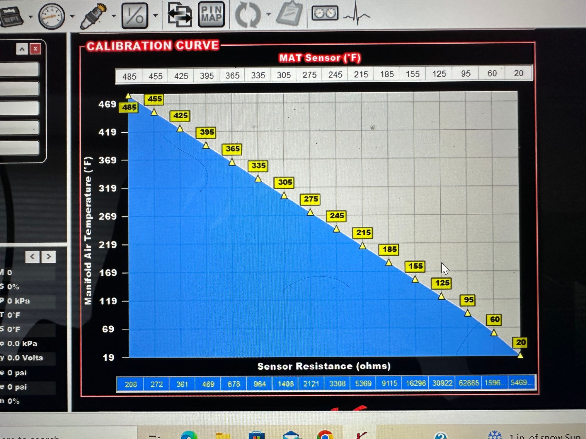

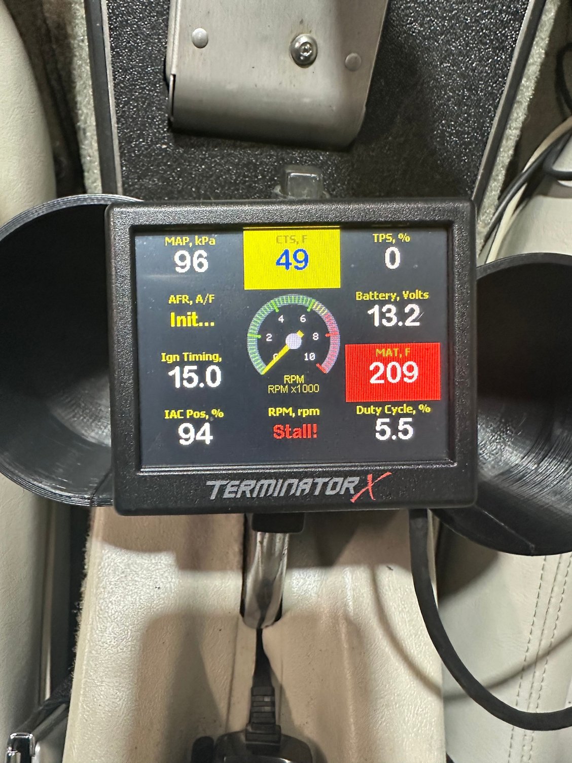

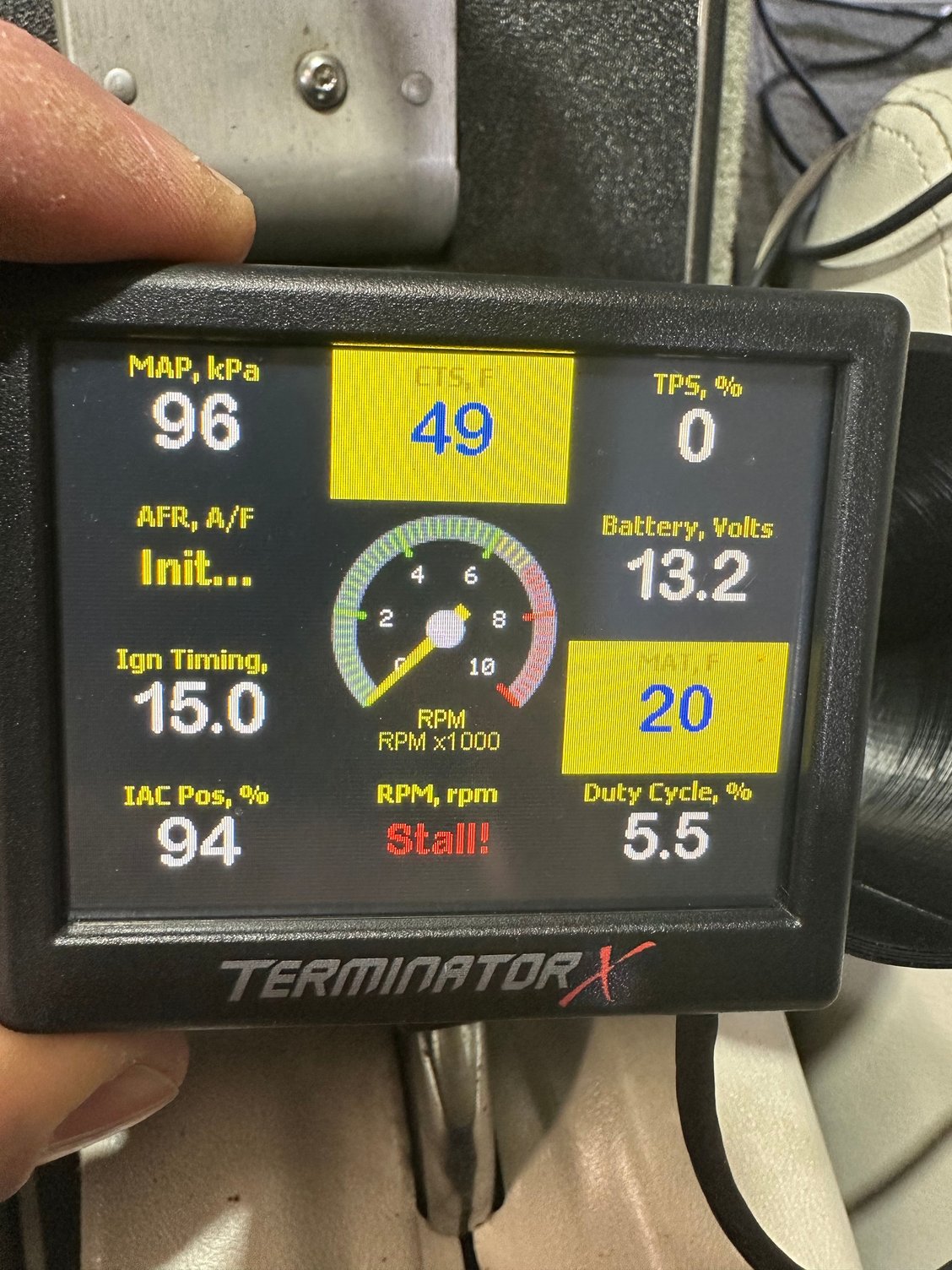

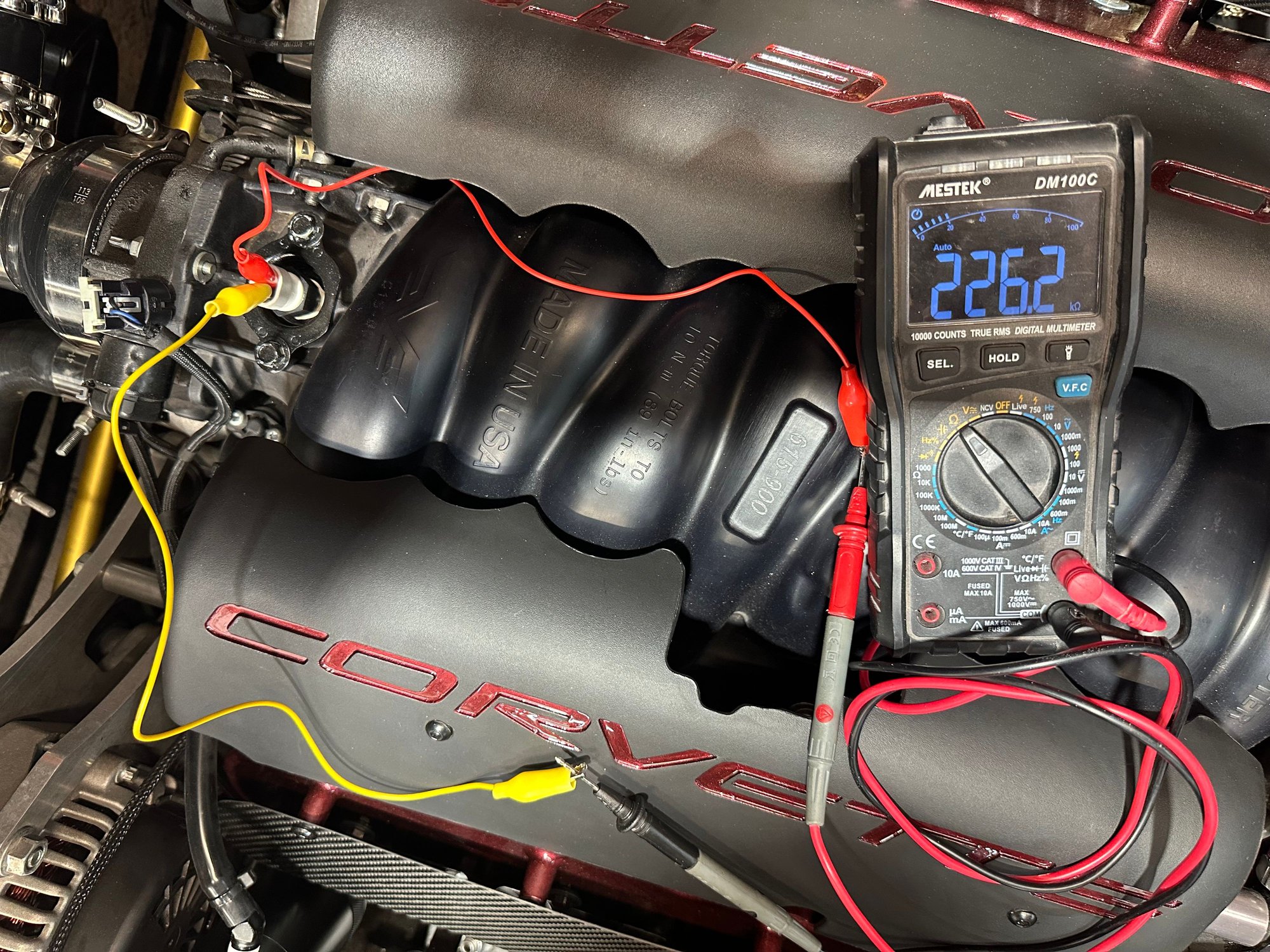

So I got the car running and on the ground. Now I'm working through the small things. I'm having issues with the Hi IAT RIFE Sensor... ugh. I set the table up how they want, input the correct custom IAT table data points and turned the key on. Engine temps in 45-50*F ambient are 49*F from coolant temp reading. IAT was reading 20*F. I started up and engine temp was 70*F after 20-30s and IAT is reading 26*F. I highly doubt the air temp in the motor is 30+*F less than engine temp and ambient.
I've been talking with motion raceworks and I measured the sensor resistance at 226,100 ohms at 49*F engine temp. This should read about 50*F on the sensor according to the chart which is correct. However it's not showing on the handheld or Laptop that way. They suggested that since the sensor is correct its gotta be the ECU, Wiring or calibration and they asked me to flip the calibration chart from how they show it to be reversed. So its high temp to low temp (left to right) and they want me to do it low temp to high temp (left to right). When I pull the sensor plug with the key on the handheld goes from 20*F to 485*F which is the low and max sensor readings on the calibration chart. I then for $hits and giggles plugged in a stock GM screw in IAT sensor and it jumped to 200*F. This makes me think the wiring is fine as its reading resistance. Unless in the wiring its adding resistance to the sensor causing a lower reading. My ECU update is so old that It doesn't have the RIFE sensor drop downs so I have to custom calibrate the IAT.
I'm going to post pics in a sec from my phone.
Hi IAT rife sensor calibration chart
Rife hi IAT sensor calibration.
49*F coolant temp rife sensor resistance.
Key on hi IAT ride sensor installed
Rife sensor tune but stock GM IAT sensor
Rife sensor tune but removed rife sensor.

Does Terminator X not have the hi iat rife sensor in the drop down menu?? I'm the HP/Dominator software there's one for low and hi

I spoke with Dalton over at Motion raceworks and he said he doesn't recommend using the drop down on the new updates for the RIFE sensor. He said they don't trust them as they have had issues and recommends everyone do the custom IAT table to be sure. He looked over my table and my sensor readings and said the sensor is in the correct resistance and the table is setup correctly but could be a wiring or ECM issue. He doesn't think that updating to the V3 will resolve it.
Old Apr 8, 2025 | 02:33 PM
