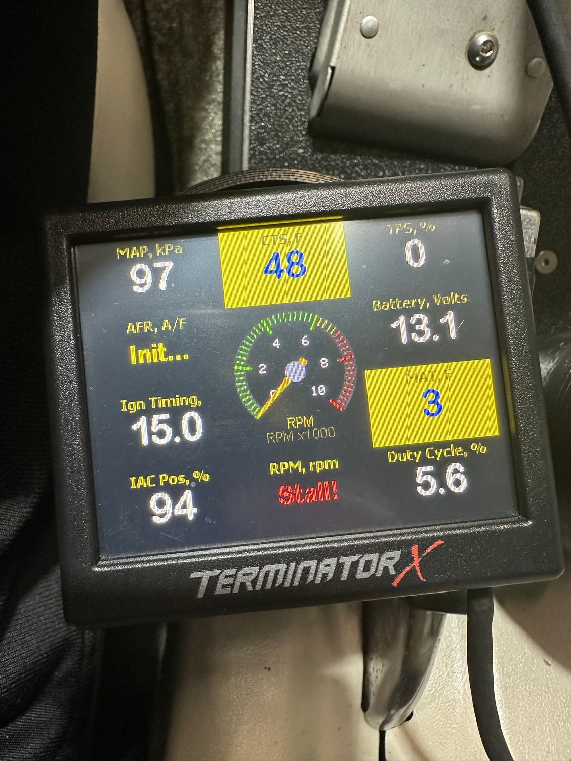

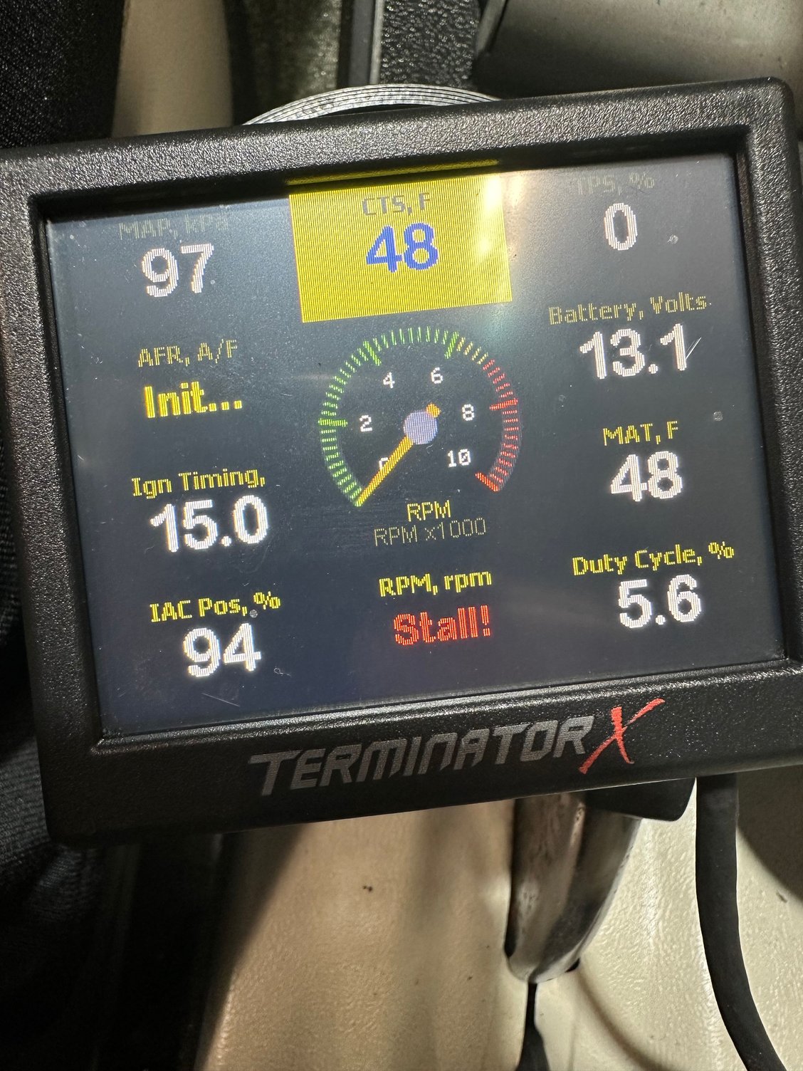

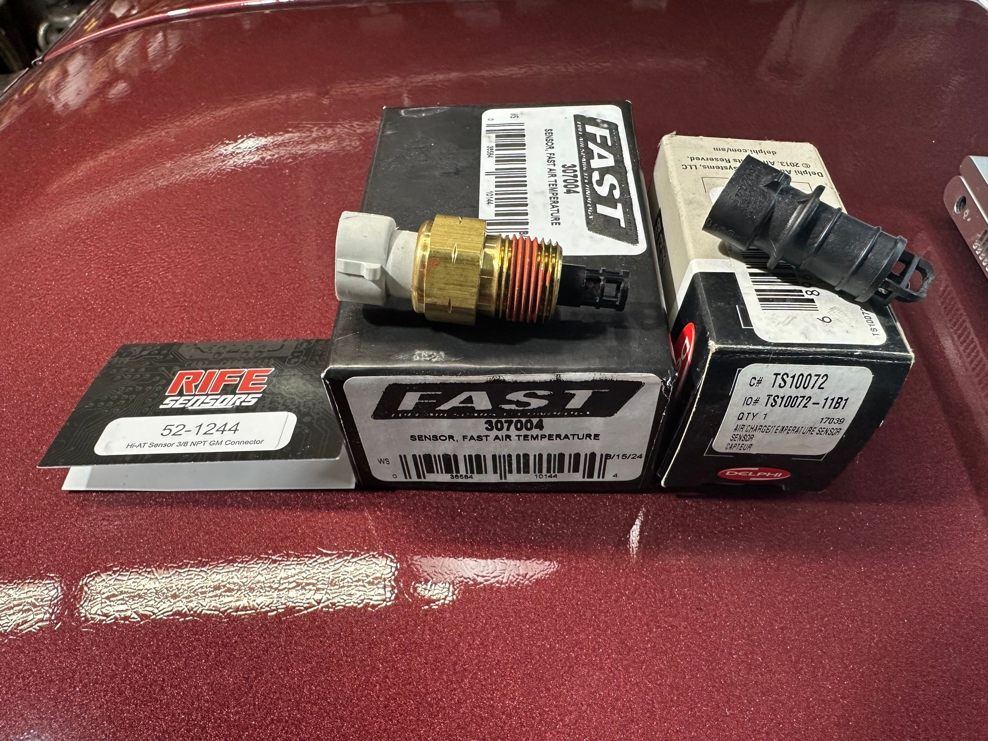

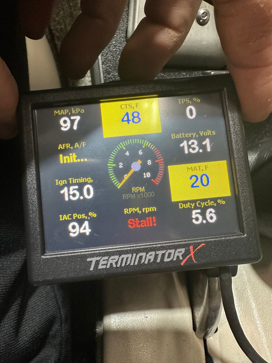

I pulled the J1 connector and got the IAT sensor and sensor ground wires and confirmed 219kohm resistance the same at the HiAT sensor plug. This means the wiring up to the ECM are correct and not affecting the readings. so I tested with the GM IAT sensor and preset GM on Holley v1 and the temps read perfect. Laptop software would not let me custom tune the IAT table backwards so I said screw it.

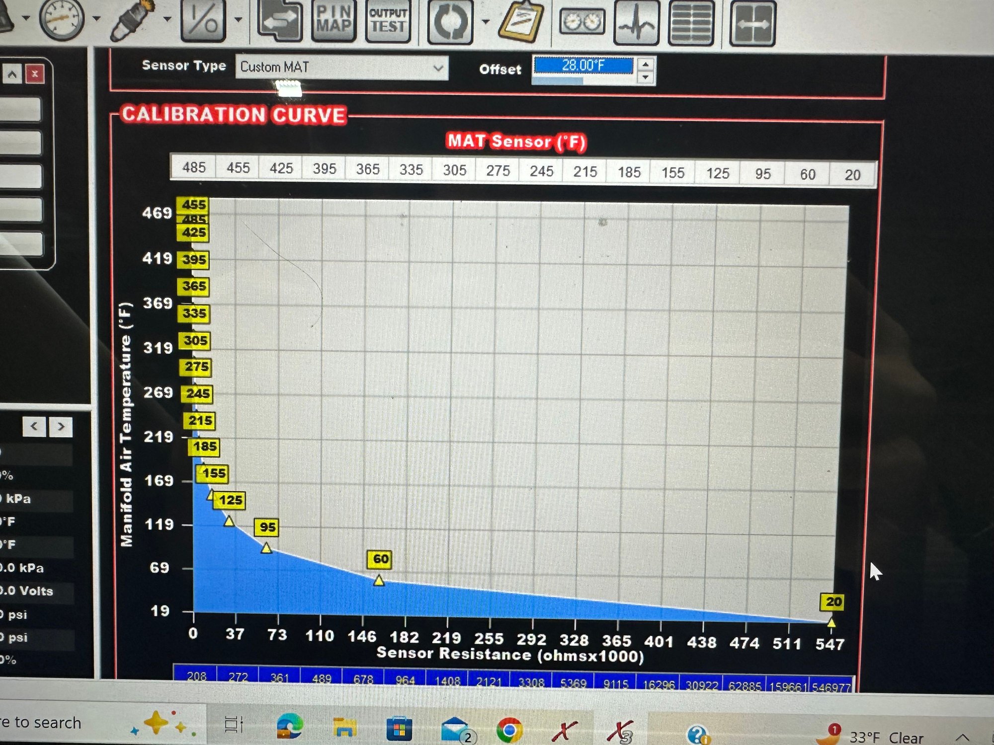

I updated to V3 and did all the tests again and got weird results.
- v3 preset HiAT sensor netted 3*F temp when coolant was at 48*F.
- v3 custom IAT table netted the same 20*F temp as before on v1.
- v3 GM sensor GM preset read perfect 48*.
- v3 custom IAT and 28* temp offset showed 48*F
no matter what I do I can’t get the HiAT to read correctly and it reads worse with the preset table… a whole 45*F cooler which is nuts. Offsetting temp brings it up correctly but what does that do for the whole
sensor range? These are suppose to be more accurate and im not seeing that. Also when I plug the custom table with the HiAT values the chart looks way different than the charts on the V1 and on the motion website.
Sensors I’m testing
Sensors I’m testing

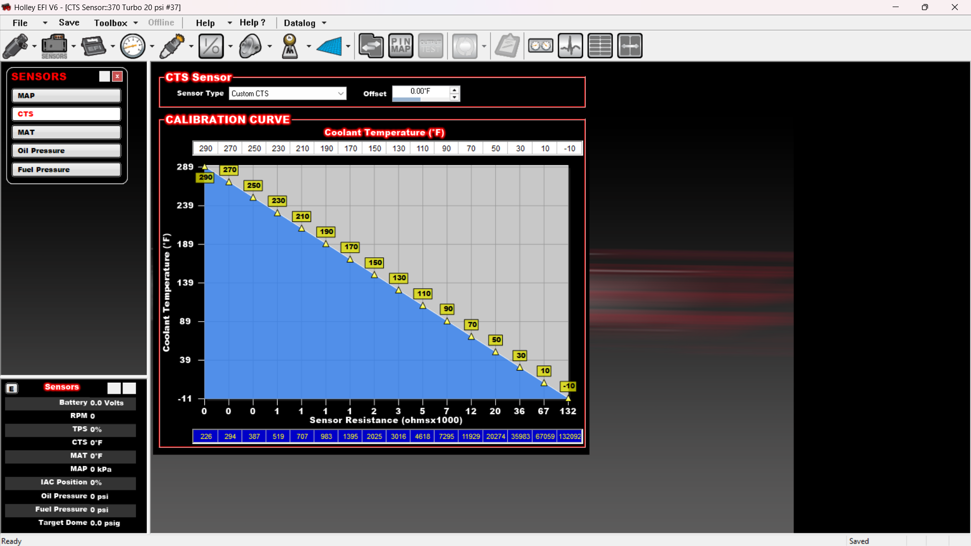

V3 custom table with HiAT values
GM sensors and the HIAT custom table with 28* offset in above pic
V3 hiAT preset drop down no offset
V3 HiAT custom table no offset.
Old Apr 8, 2025 | 10:59 PM

Hmm that's interesting how that table turned out. I think I had that same issue before with the weird looking table. So after you mentioned how Motion preferred everyone use the custom table so their IAT and CTS I went ahead and got their tables setup in mine they way they have it on the website. One other thing I noticed was that using the "dropdown" sensor calibrations was that the Holley didn't scale them to their advertised ranges -10-335 IAT and -10-290 CTS they just stay at the GM ranges which totally defeats the purpose of using them
Coolant sensor scaled properly
IAT scaled properly both sensors using the advertised ranges. Haven't tested yet but will in the morning

Hmm I'm wondering if it's a Terminator X thing why that table looks out to lunch?? I just put that into my software and it looks just fine

did you test a GM sensor? Wat was your MAT before the changes vs ECT vs the custom table? Are they trading similar or near ECT?
also how did you get the table to look like that? Yours looks like the low temp IAT but still couldn’t get mine to look like that under v3.
Well as I've just discovered that using the dropdown sensor calibration it was just the GM scaling the entire time so that's fun knowing it's been wrong the whole time I've been using them both! I do remember that the GM MAT sensor read higher and took longer to register any change in air temps. Yes I am using the Lo temp Rife IAT sensor. I had the same issue with the odd looking table like you're having and I'm pretty sure that's why I just used the dropdown. I'm not even sure what the fix was.
Well now that I've got the proper sensor calibration in the software I'll get it all tested to see what the difference is and compare a couple datalogs
Also after you get everything calibrated in those tables you'll shimmy over to system parameters icf and sensor scaling/warnings and scale those sensors in there. Then you'll need to go into Air temp enrichment and adjust that table for the scaling and basically all AE tables adjusted for the new scalings as well

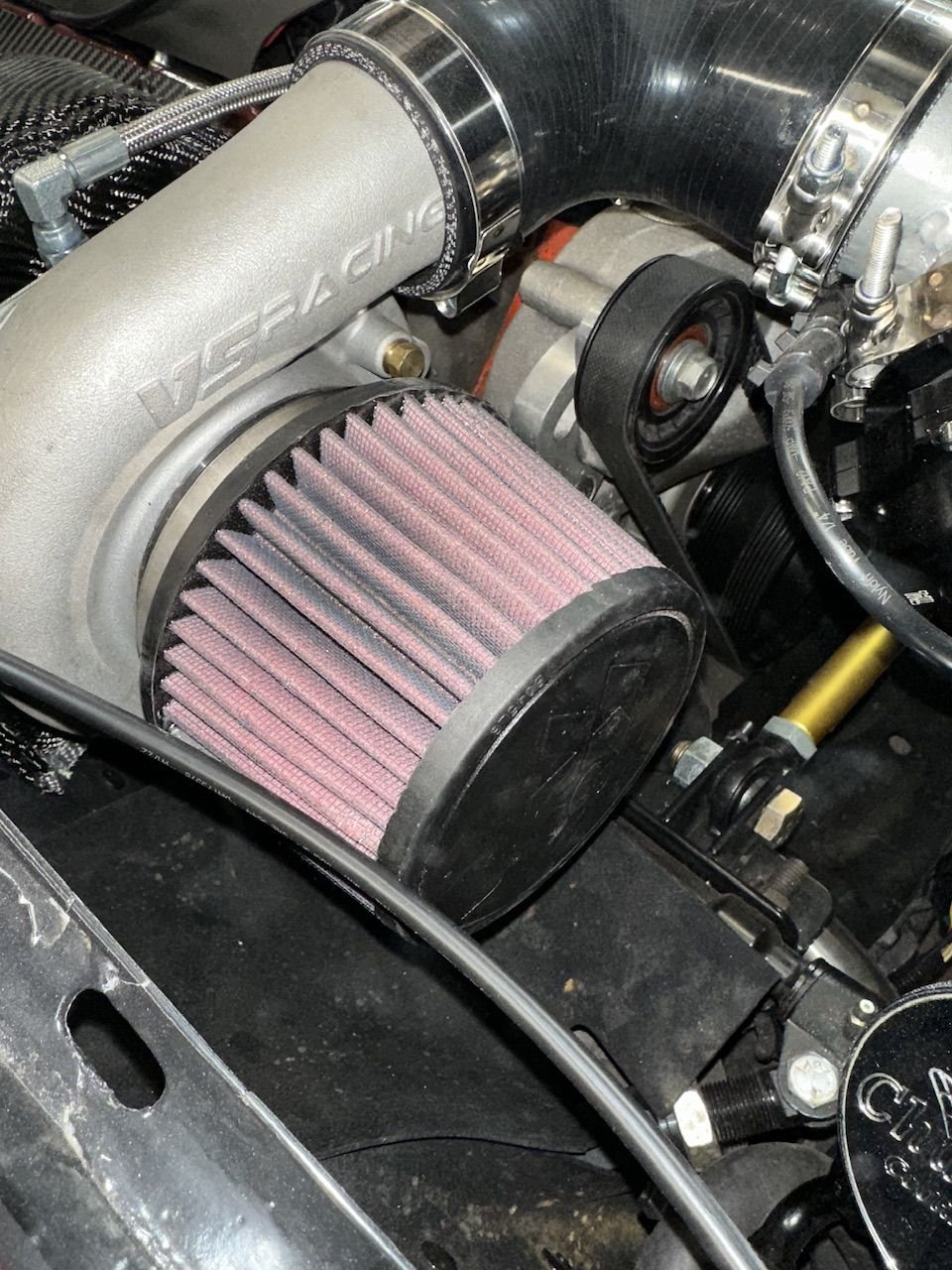

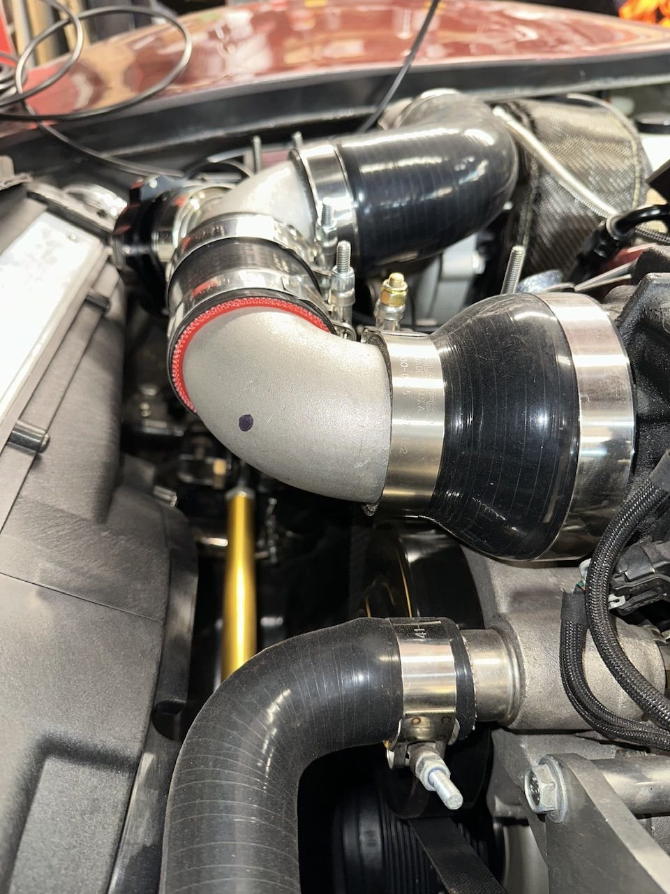

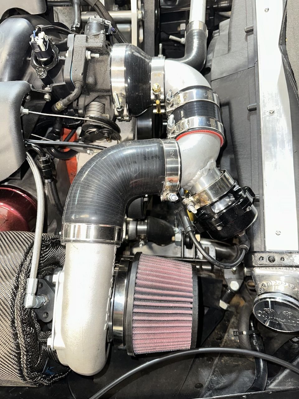

I’ve started plumbing the water meth system. I’m looking at two locations.
  1. in the top of the short k&N which is 3” deep. Thinking of running 2gph with 300psi pump and wiper fluid mostly for lowering IATs. My concern here is that the pattern could soak the filter media and when I let out of boost the wiper fluid will come out of the BOV and get everywhere. See pic
  2. in the 90 right before the TB. The issue here is that it will soak the IAT sensor. see black dot in pic
I know the turbo inlet will allow the most cooling and right before the TB will offer more detonation protection. Not that it really be an issue on 93. Not a ton of room and these are really the only spots.
I think in the 90 before the TB is the only option there's not a whole lot of piping and before the BOV would just create a mess
What about putting the nozzle in the end of the filter as mentioned and put a fuzzy wrist band around the BOV that will catch the mist and keep it from spraying everywhere?
Remember back in the day guys would put the fuzzy wrist bands around the valve cover breathers to keep the mist from getting everywhere?
With the temps under hood, it would evaporate and dry almost instantly.
I've done that with a green foam filter media to help with BOV noise when I was running a supercharger. It's an option I guess... just don't know if spraying that soon is worth it. I've also read a small nozzle like 1GPH is needed pre turbo and you can't spray alot, the smallest I have is a 2GPH. I wired it up last night and put fluid in the tank and now the tank is leaking by a mounting tab... not idea why but the tank is the original so maybe it just decided to crack dunno. I had to order a new tank which are expensive for what they are.

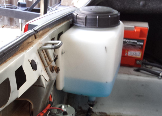

Not sure where you heard you can’t spray much volume pre turbo, but that’s total nonsense. If you run an intercooler, then you limit the amount sprayed pre turbo so it doesn’t condense in the IC and puddle. Otherwise, there is zero reason to run AUX inj anywhere else. Spraying pre-turbo is the only way to up the eff. of the turbo itself. No other location gives you that. So if you don’t run an intercooler, no other location makes sense. You can spray 200gph++ pre turbo no problem, there is no “limit”.
Personally, I’d ditch the blow off valve completely. Its not needed. Turbo “surge” doesn’t hurt the turbo one bit. At least not enough to effect our applications. Maybe if you ran a semi 1 million miles the BOV would help the turbo live a bit longer. I had 180k original miles on my grand national… much smaller turbo spinning much faster than the units we work with these days. No BOV from the factory… But I know a lot of people like them for the sound. Wrapping it would be fine IMO.
You can run any poly tank and it will be compatible with methanol. Mower fuel tanks etc. I prefer the agricultural ones with 4-5” lids. Makes it easy to clean and add fluid. Def don’t need the BS alky tanks they sell with the controllers. Way overpriced.
