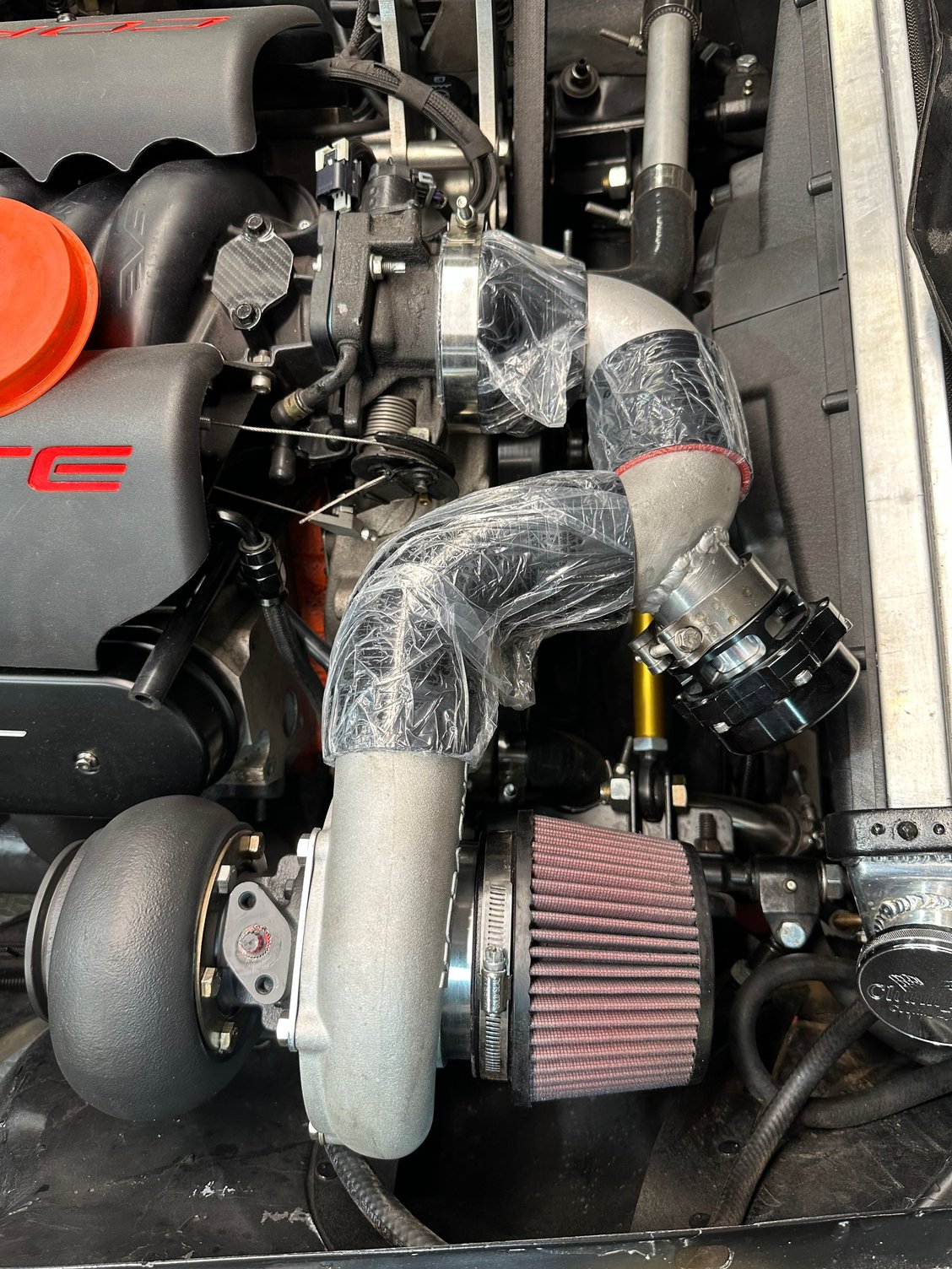

Cheap fuel makes the car easier to drive. I've heard that pre spray into the turbo will eat the impeller blades. Car would see 100 or so miles a week just driving to work, would love to take it on some longer trips 2hrs+.
interesting... I got a brand new 300psi snow pump for $80 off FB market place. I'm reusing old snow nozzles I had from another kit that I'm not using on my firebird. basically the pump is the only cost and a $25 devils own tank bulkhead adapter which I converted the stock wiper tank with. I was actually planning to run a relay and have the pump controlled by the Holley Term X. I can setup and output pretty easily. Currently using only one as PWM for brushless cooling fan. Are you saying that a 2PGH pump from snow on the 300psi pump will really put out 4GPH? It looks like snow rates them at Boost Cooler Hyper-Sonic Injector, 125ml/min@100psi or 2GPH, this is for size 2. I think the nozzle has the built in check valve as well as I tested it with an air gun. https://www.snowperformance.eu/en/wa...zzle-sno-n0200
I was thinking of tapping the cast elbow right after the BOV for the nozzle, that way it has 18-24" till it reaches the IAT sensor in the intake. I also thought that I would get some wiper fluid spraying out the BOV when it opens and the same if it was in the turbo filter head. Putting it in the filter means the turbo blades could get eaten up but then I would have it definitely coming out the BOV when its open.
this is the setup for the cold side.

I've never had an issue spraying into the turbo inlet causing problems with the blades, but it depends on how you're spraying it.
