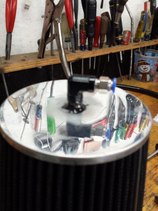

I’d say it matters. If you are going to bother with aux inj, why not put it where it will do the most good? Similar to plumbing your turbo inlet in the bay or behind the radiator sucking hot air. It will still make power. Its just not ideal.
Spraying tiny amounts isn’t going to give you any massive seat of the pants gain or drop much off your charge temps. It will pull heat form the CC chamber, and if sprayed pre turbo it bumps the turbo eff a tiny amount due to “wet compression” and cooling the compression process.
Also if you plumb it at the air filter, you have the added benefit of not worrying about the kit draining into your engine when its setting, or if the pump sticks in the “on” position. You also don’t fight the boost pressure like you would spraying in the charge piping. So you get more pressure and better atomization.
Pre turbo inj. Won’t damage anything if done correctly with decent atomization. I’ve been spraying pre-turbo since 2006 in every turbo application ive ever owned and I have never seen any damage. So don’t worry about the turbo.
Using the factory washer tank is always a great idea. Low level light is a life saver too. In my simple setups I use 1gal of -20 washer fluid and 2 bottles of the yellow Heet additive (which is basically 100% meth) This gives around a 50% mixture.
I’d setup some sort of mount centered on the filter, yes.
Got it. My nozzles have the check valve so I don't have to worry about boost pressure or sucking fluid in. Really like you said its just the pump staying on. How much should I spray? I think I have a 5GPH nozzle as well as the 2GPH I have now. I'll have to check but I Have some AEM nozzles but no holder for those. I also have a shorter non check valve nozzle (snow nozzle) but I assume there will be some kind of vacuum at the filter so better to have that to limit drainage.

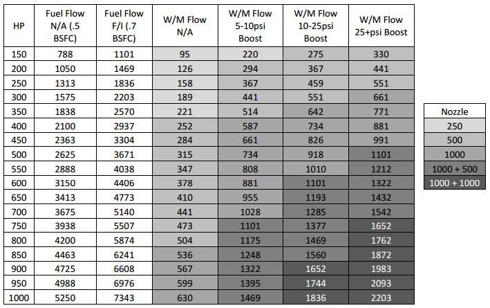

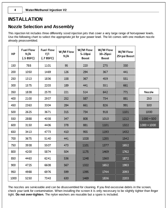

you both might be way off. I took snow or AEM's word for it on the meth flow. But there are some differences you should be aware of. Apparently pumps are putting out different pressures. For instance the Snow 300psi pumps don't put out 300psi when you get them, they are detuned to 200psi ish. They are capable of higher pressure but what is the actual pressure? Also what pressures are the nozzles rated at and what version are you dealing with? V1, V2 or V3 they flow differently and at different pressures.
  • What nozzle are you running and is the flow actually match? I have V1 nozzles for snow and AEM V2 nozzles. I remember testing my snow nozzle on my firebird with the AEM Water meth flow gauge and I was in the 700-750ml flow with my nozzle which I need to check what number it is. I checked my nozzles the other day and I think I'm running the 500cc/min AEM and the snow 300psi which Puts me in the 700/750cc/min flow rate. Word on the street is that the V1 nozzles flow more at the lower size than the V2 probably due to atomization which reduces flow.
  • What pressure if your pump actually doing? If you have a V2 snow nozzle that is flowed at 100psi what is it doing at 200psi?
  • If you have a 200psi pump the pressure is probably closer to 100psi operating, a 300psi pump is really 200psi. You can adjust the pressure but it increases the amp draw and can affect the pump operation.
I haven't had a chance to watch this video fully and watch it again to make sure I retain the info but he is basically saying the nozzle flow doesn't match the pump and they don't tell you want the preset pump pressures are and how that affects nozzle output. Also the differences in V1 vs v2 and V3 nozzle design and flow. We might be way off on what we think we are flowing since it sounds like we are based flow rates at different pressures and different versions.

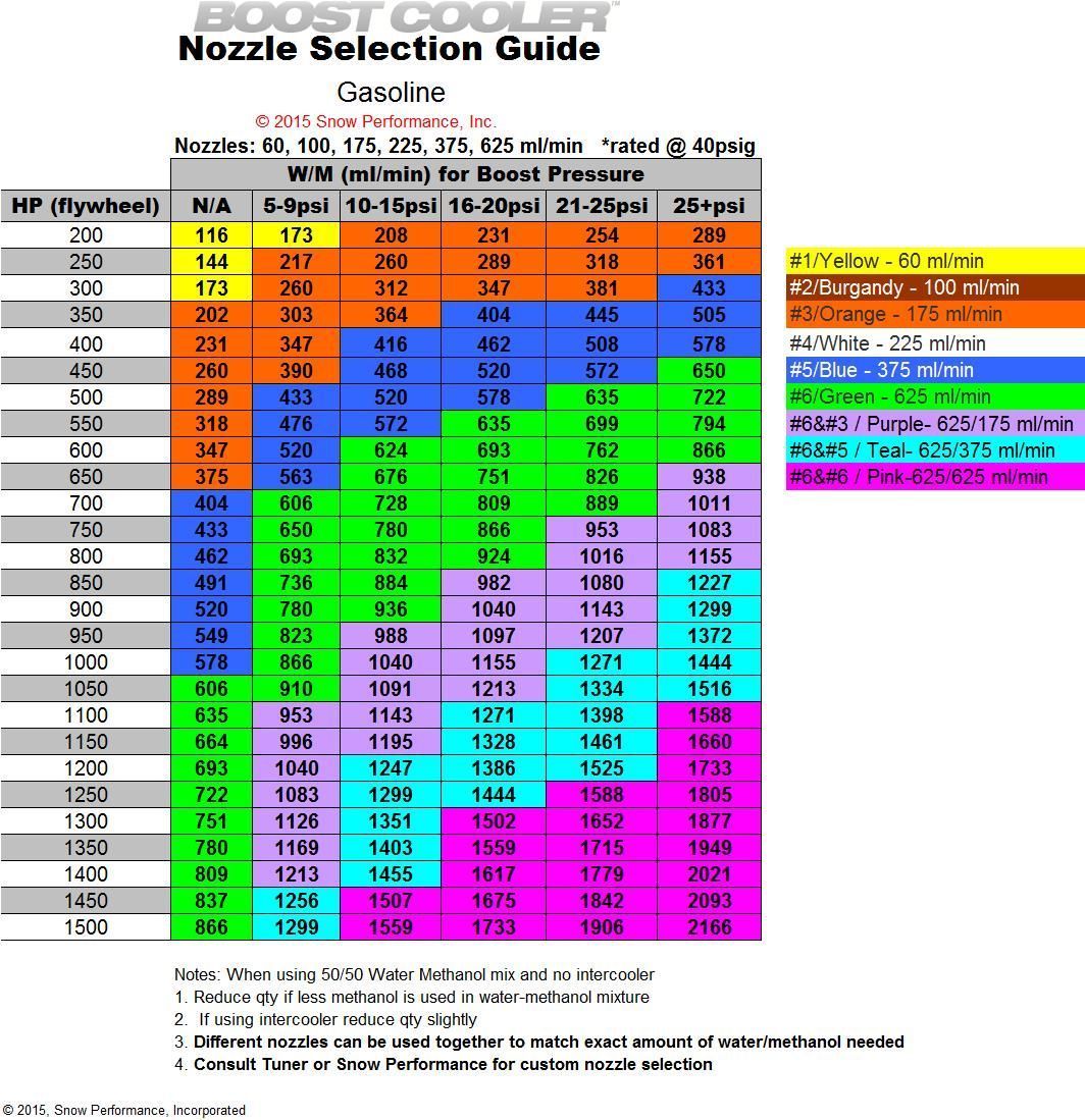

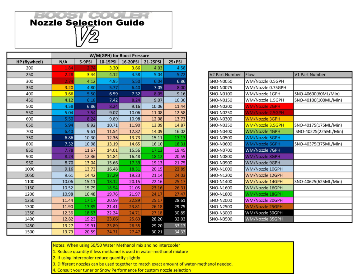

Big differences if flow tho vs pressure. So if you seeing 180psi and the nozzle is rated at 175cc at 40psi what is that nozzle actually flowing?
This is the interesting chart as they slow the v1 nozzles and the comparison of flow.
These say they are rated at 40psi… these pumps don’t put out less than 100psi so why even post this info.
I run Snow v2 nozzles #14 and #16 and they rate them 14 and 16 gph @ 100 psi. That's right off their website. So using the formula that was posted earlier I figured flow for 150 psi and 180 psi for the two nozzles I'm running
Snow 16 gph nozzle @ 186 psi = 21.82 gph @ 150 psi = 19.59 gph
Snow 14 gph nozzle @ 186 psi = 19.09 gph @ 150 psi = 17.15 gph
Then I'd have to factor in how much boost it's gonna be up against in the charge pipe. I did try using just a single nozzle as per the Snow chart but it clearly wasn't enough as I could watch my IAT temps climb during a pull. With both I see the temps actually drop but it's not a true temp reading more of just a "Yes the system is spraying" kinda thing
