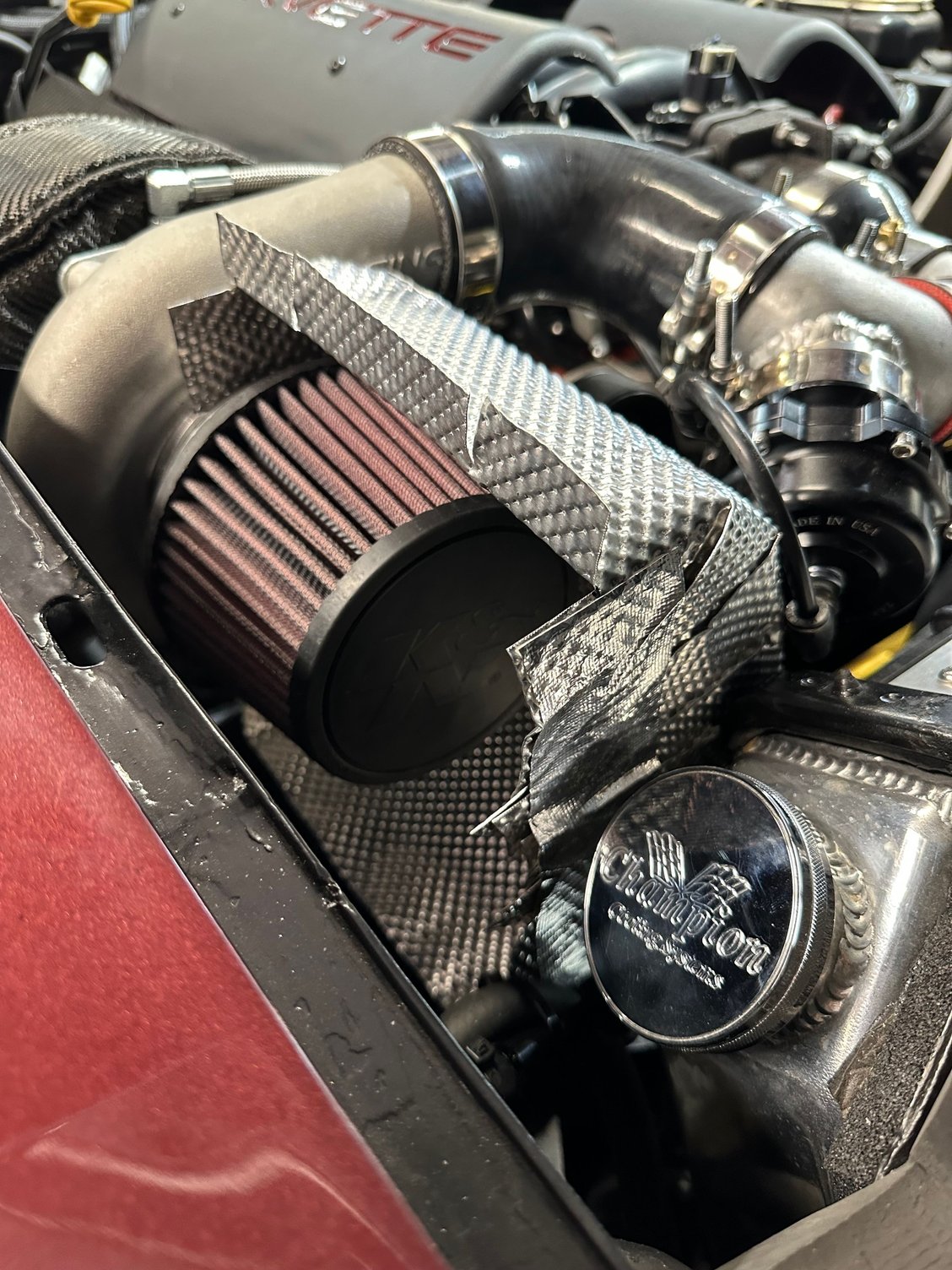

I was seeing 150ish IAT cruising and got to thinking about how I can get cool air to the turbo to help. I came up with this quickly but haven’t tested. The top would seal to the hood and the Aarm is open there for the wheel well.

I think you'd be fine with the smaller intake piping since the turbo is so close to the engine.
The larger stuff would probably be more beneficial with higher horsepower, higher flowing applications.
It'd be cool to fab an air duct from under the car to the turbo, kinda like a cooling duct for the brakes.
