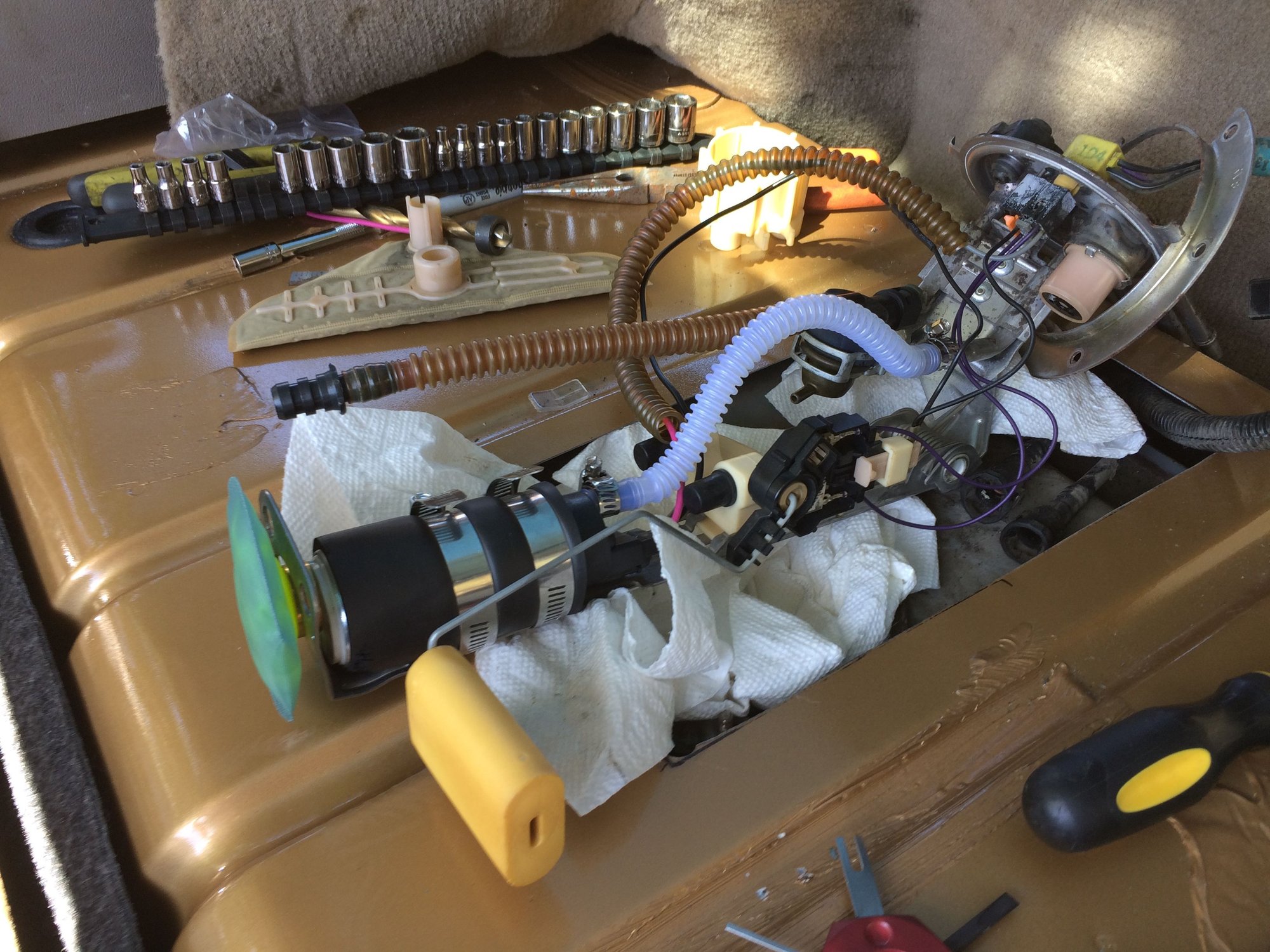

Old Jan 28, 2018 | 10:04 AM
ChopperDoc's Avatar
Joined: Oct 2014
Posts: 1,220
Likes: 179
From: Virginia
Here's a picture of a walbro mounted on a stock f-body fuel pump arm.
