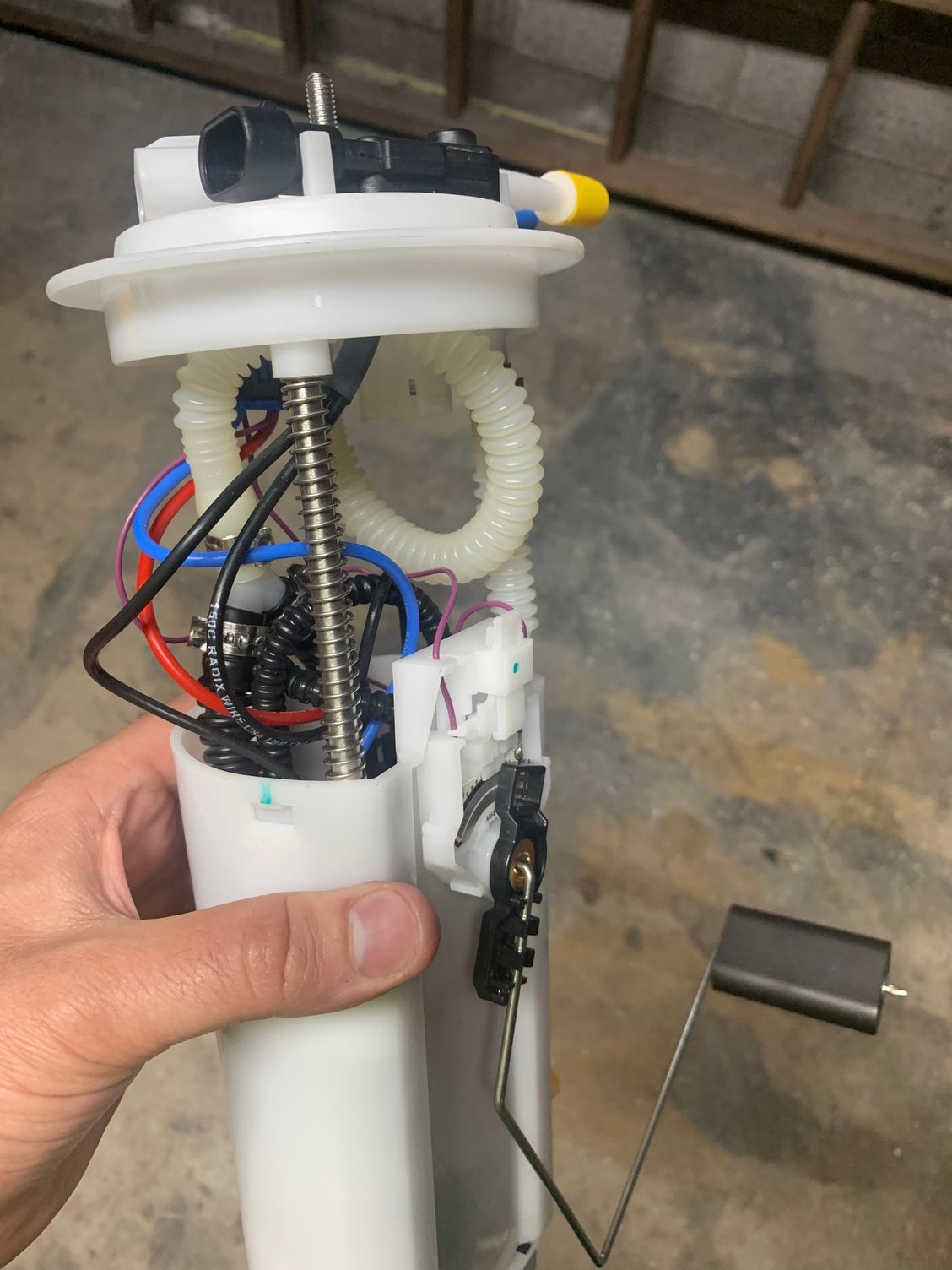

I replaced the fuel pumps with new racetronix’s dual 340 pumps, I bought the hole sending unit and pumps assembly from ws6 store , put it in , now I have no fuel pressure at all, I do have power going to the pumps , should I try sticking an stock fuel pump in to see if it would start?

And your fuel pressure is zero or low? Have you tried putting the pump in a bucket and provide power to see flow?
1st time I cranked it , it was low than 0 , I did pull the feed on the top of the fuel hat , off and ran an hose to an empty bucket it pushed fuel , but I don’t think it was enough pressure

Not enough voltage or a poor ground can cause those problems.
Assemble everything just the way you had it. Push a straight pin into the positive wire to the fuel pump, at that connector. Use the straight pin to measure voltage. Should be 12'ish volts with engine off. And then rise to 13.5'ish volts with engine rpm's. If it doesn't do that, then it's an electrical problem before the pump.
Push a straight pin into the negative wire. Measure resistance to ground; should be nearly zero.
With the pump and bucket removed measure resistance between the connectors on the fuel hat and the connectors on the pump. Should be pretty close to zero.
Put the fuel bucket in a bucket of water, with about 6" of water. Hot wire it directly to a 12v battery. If it still doesn't pump like it should, then the pump is bad.
