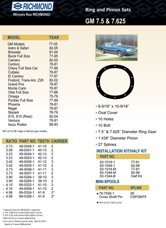

When I go to the Richmond Gear catalog, it shows this.

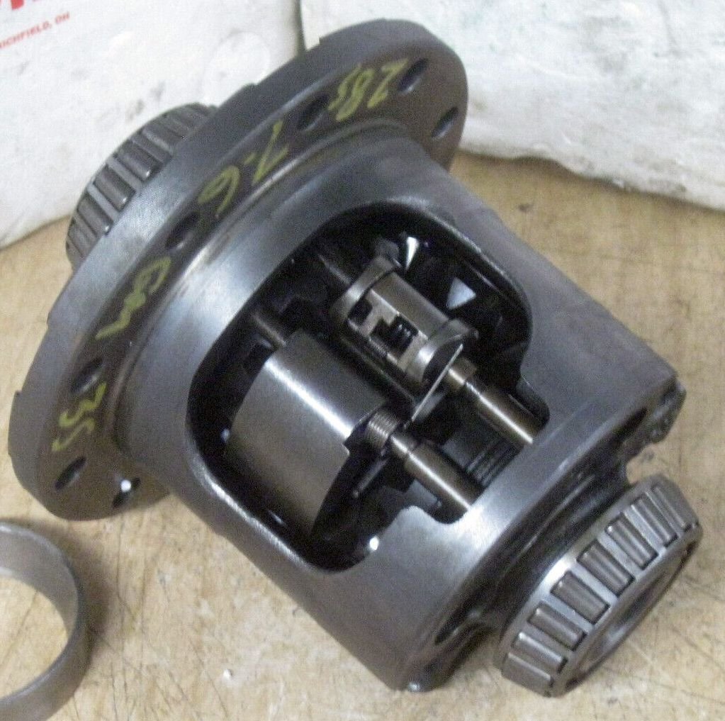

quick performance has a 9in rear for 2150 bucks with many upgrades to choose from more $ of coarse. but its way better than putting money in that 7.5. with that said the cheapest way (other than welding the spider gears) is going to be a lock right installed in that open carrier.
Old Jun 21, 2023 | 06:46 AM
Tommy42088's Avatar
Joined: Oct 2022
Posts: 1,776
Likes: 627
From: Louisiana
that looks to be a fairly simple upgrade just for the time being. I'll let him know and see if that's the route he wants to go. Thanks
