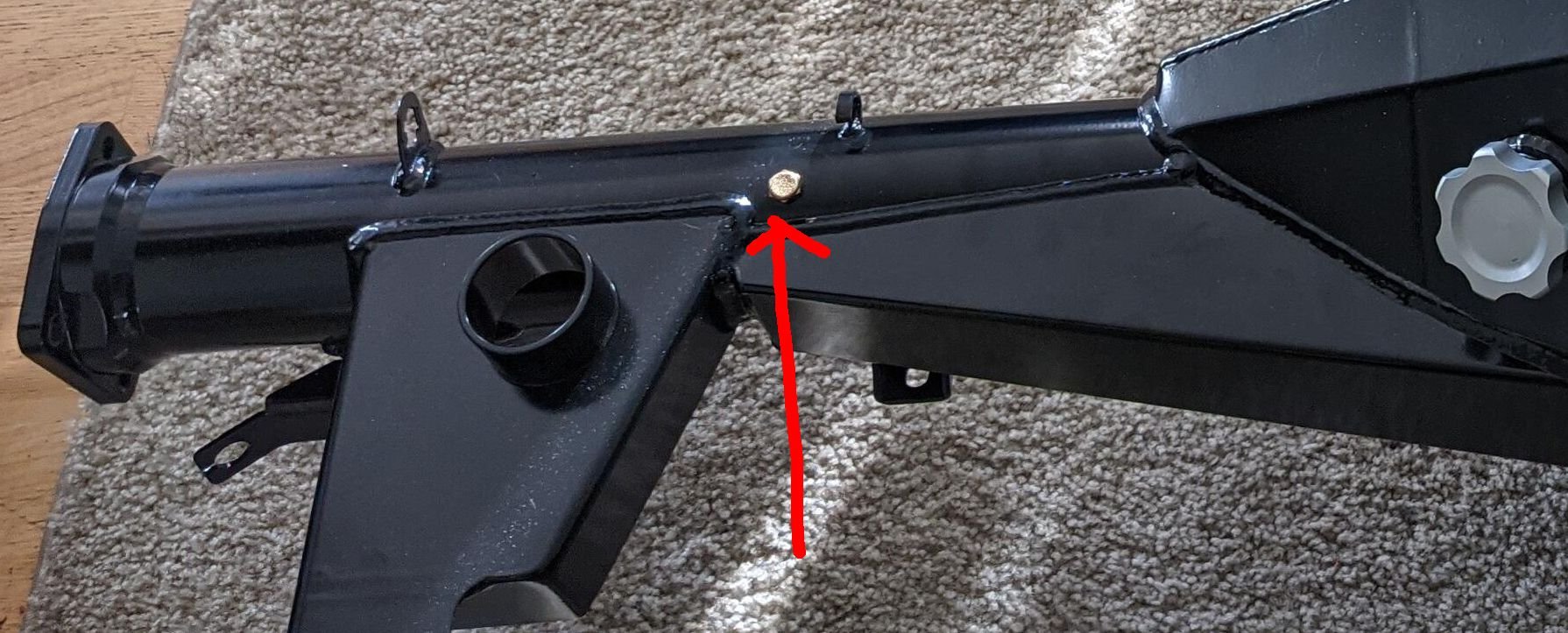

Just a question but also wanting a solution. My MWC fab 9 is leaking gear oil out the vent? that is mounted on the top of the tube on the drivers side.
Is this normal? It is NOT overfilled as its just over 3 qts in the system.
Driving me nuts! Are there any fixes? Thanks in advance?

Think it could be aersol coming out as it drives? might could put a vent filter on it if thats the case?
Got any pics? may need to route the tube differently also?

Install -6 adapter to -6 pushlock and a 3/8” mini breather. This is on my 12 bolt but you get the idea.

I have 3qts in mine and so far so good but it's also not coming out of the allen plug yet. From what I've been told you're supposed to fill it until it just starts to drain out from there.
Im talking about the "breather" its right by the spring perch area on the DRIVERS side

I will see if maybe MWC chimes in as well... otherwise I will do as you did. Its splattering on muffler and getting slimy everywhere lol

Mine does the exact same thing. I don't think it's actually gear oil coming out but most likely just fumes venting and coming down the housing backside. Doesn't bother me tho

100% getting sticky gear oil coming out.... its coating my muffler and accumlating under the rear as well on the brackets below.

Oh boy that's crazy. That little filter fitting might just be clogged. On mine is just residual oil

Just replace the little filter thing with a nipple and run a piece of hose up high. Shouldn't be a problem after that

its funny you posted asking about this , this year after 5 yrs of mine doing the same thing i threaded a barb into it and clamped a hose to it and ran it to the upper panhard bar . no more mess on the rear end and by the shock mount . This is the only gripe with my mwc fab 9 but for a few bucks you can fix it .
