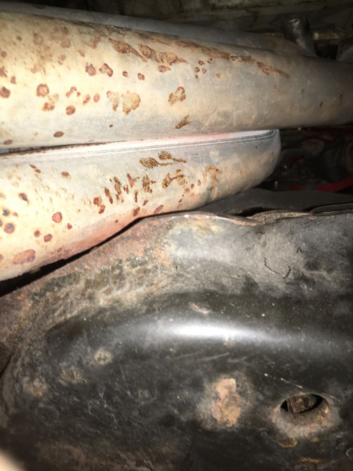

Update numero two for the night. Got home jacked the damn thing up, wanted to check the header clearance over the k member. At first I thought I figured it out.
Looks super close less than a 1/4 " clearance. You can see where it's rubbed itself down. So I had the neighbor come over and rev it to vibration, but didn't look to touch at all. At this point I just don't know. Still going to unbolt the TC this weekend and see if it goes away or not to rule that out. Flex plate maybe? What would a bad flex plate feel like?
