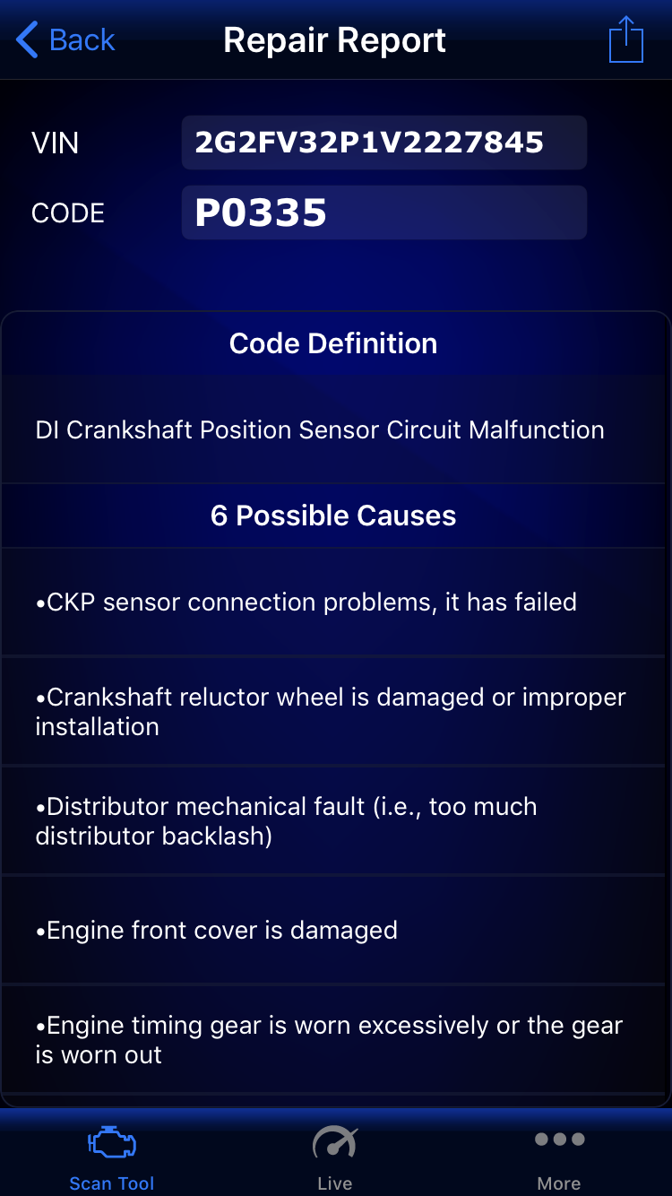

That code is Crank Shaft Position sensor......they are the same in what they do for both the LT1 and LS1......
You could have bad (NEW) sensor....its happen ed dozens of times. But you'll need to check the rest of those items associated with the CSP sensor code.
