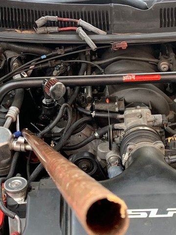

Just a few points, I have an elite catch can and a fixed orifice PCV. I also have a check valve at the fresh air port on the intake and a breather filter at the oil cap.
The oil dip stick doesn't pop out of it's tube. I can't actually see it smoke while driving it but it does pour out the smoke if I hammer the throttle.
The engine has used oil since day one of the build. I probably have 8,000 miles on it since then and I've gotten tired of seeing that low oil light. It uses around a quart per week or 250 miles.
I'm about to start troubleshooting and may go ahead and shut it down until I resolve this - thoughts are appreciated.

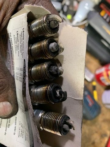

Jamie, pull all 8 plugs and report. Maybe you’ve actually got a headgasket issue and it’s passing coolant. The steam produced, if it’s weak enough, could be confused with smoke. I say this because your car was very low on coolant in a different post. Spark plugs will tell all.

I'll pull the plugs this weekend. I have another set to put in. The thing about the coolant is that I typically check it once a month or so, and it's always been full and orange - although I've not tested it. If I have a blown head gasket, then I would think this would be a very recent issue.

OK ... it's not coming from the PCV system as the hoses and intake are clean. The oil that I dumped out of the catch can was fairly normal. It was what I figure would have hit the intake before the build and no catch can. If it's blow by ... that's another story. Next is to check the plugs, compression check while I'm at it and bore scope. Ongoing .....

I started on replacing my spark plugs and I only bore scoped and checked the compression on #2. I had 210 psi and it went up to 220 with a tea spoon of oil. Cylinder still had crosshatch. Side note - whoever installed the spark plugs torqued the living hell out of them (probably when the engine was not in the car - that is if the engine was ever out of the car. I was so worn out from fighting with them, I only got 5/8 of the job done. Plus .... I was fairly perturbed to say the lease. I had to use a long copper pipe to break them loose on a couple of them. Anyhow ... I was surprised that the plugs weren't wetter with oil. I had number one out many months ago and it was wet with oil. I guess the rings were still sealing?
