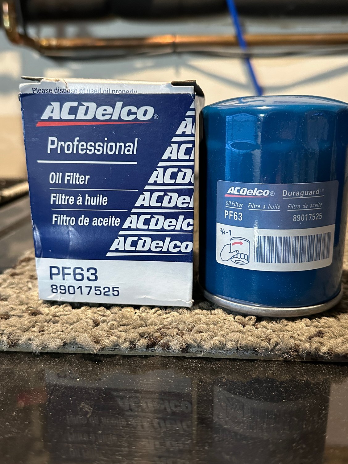

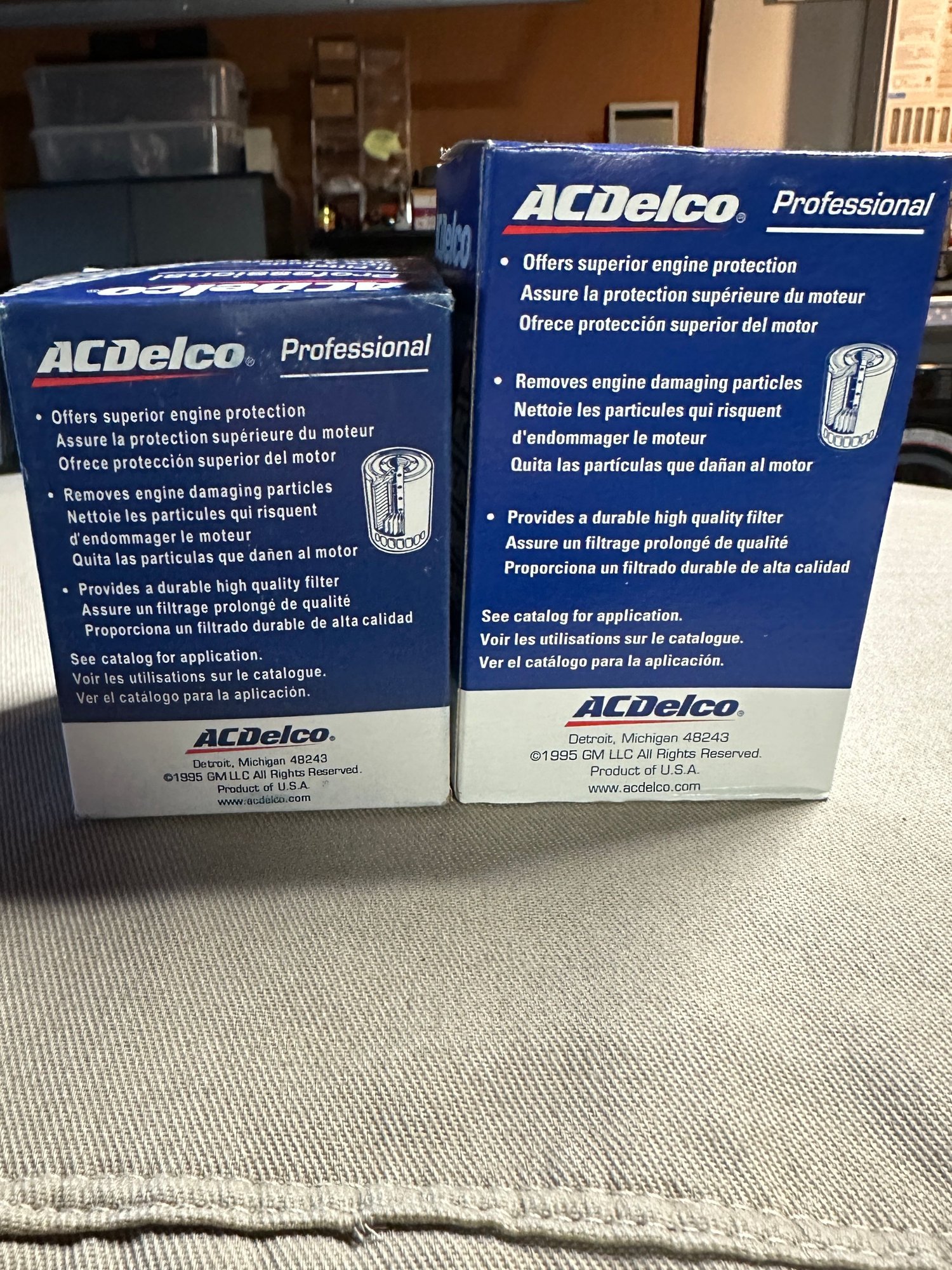

Hello all, I would like your opinion on this PF63 filter that I purchased from a verified vendor on ebay, it was listed as NOS, and the packaging seems correct, however it is a bit smaller than the new one I purchased a few months back. Any comments would be greatly appriciated.
filter purchased from ebay NOS
left ebay NOS, right new walmart
left ebay, right new

looks like a good fake to me, been seeing alot of this lately. ac delco spark plugs from amazon same thing very close looking and packaging that is off color and slightly off . id return it.

Its a fake. I worked at a GM dealer for years. the silver ring is the giveaway. OE filters are all blue.
If you see one on a car with a red label, it s the "factory" filter and has never been changed.

thank you so much for your reply. Based on this sir, I contacted the seller on eBay and he immediately refunded me my $70 and apologized saying he did not know they were fake. He does not want the product back because he cannot sell them, he asked me to dispose of the filters which I am going to do

Did a little more research and found that the authentic filters have a stamp on the bottom with a date code, filter number and "MADE IN USA". None of the eBay filters had this.
