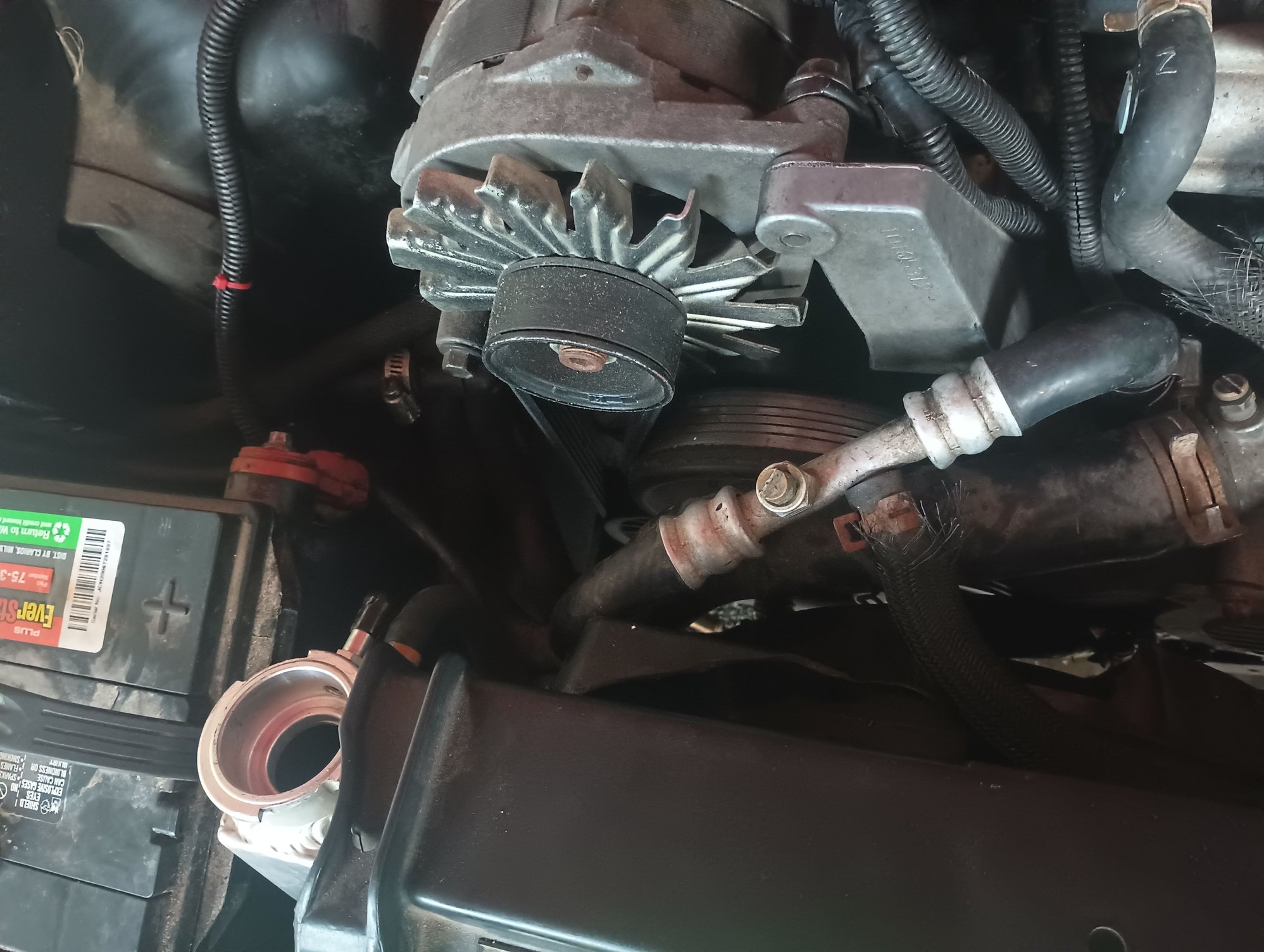

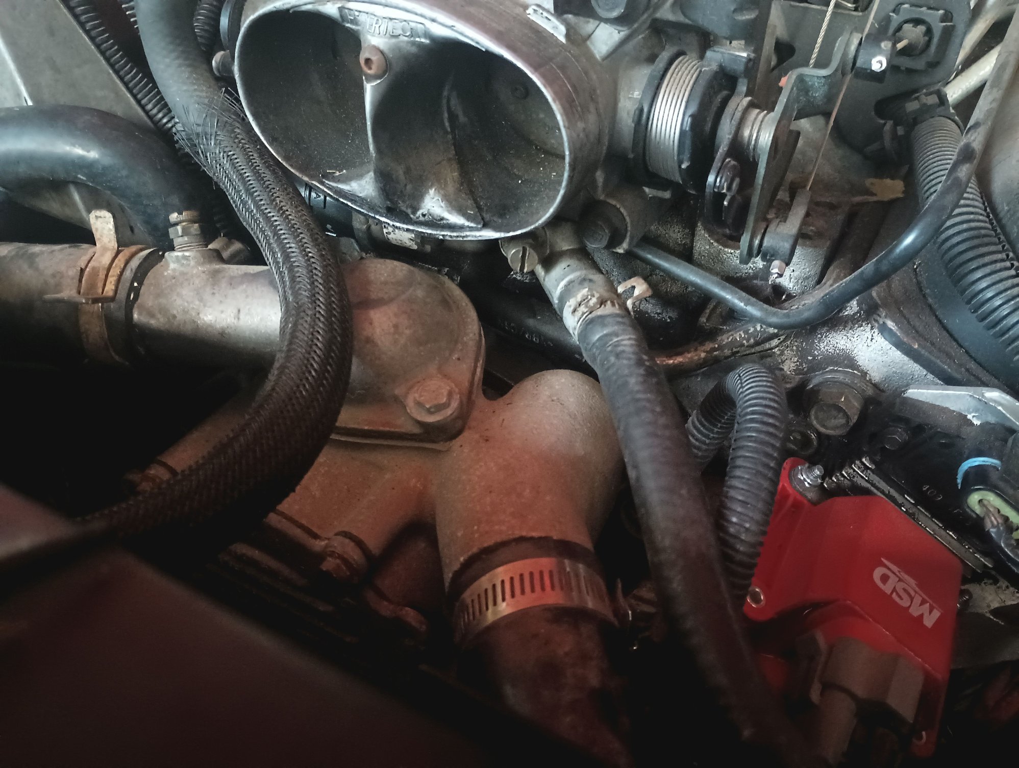

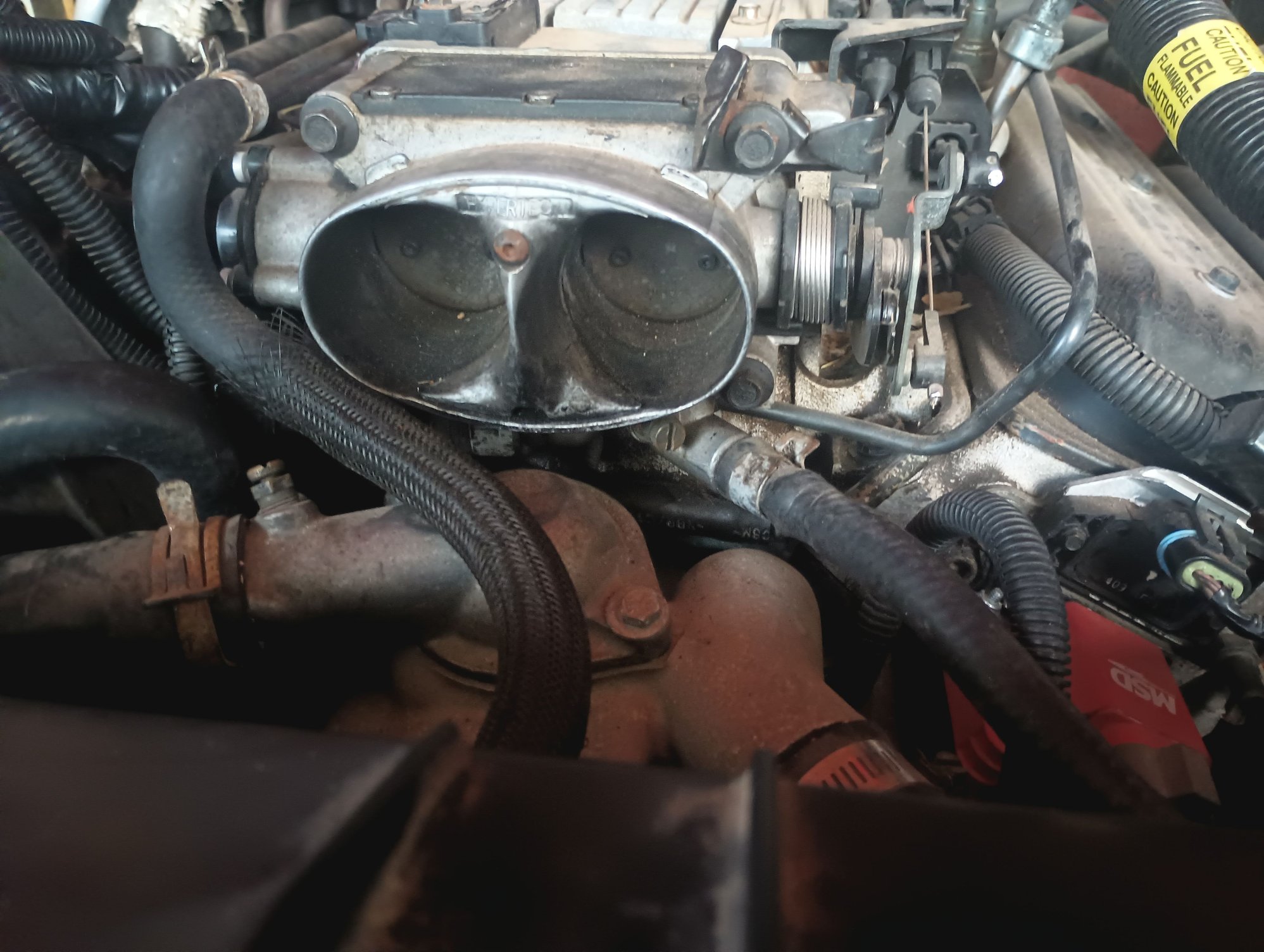

Which hose you talking about on driver side I have huge hose ?

And the engine you showed is an LT-1, previous posters are talking about the LS based platform...
