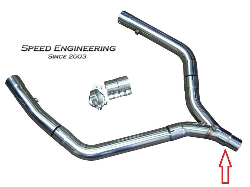

I have a question folks:
The Speed engineering stainless off road Y-pipe has what looks to be a stepped outlet. What size is this outlet? Can it be cut at the step if the larger size is wanted? What is this larger size?
Old Nov 22, 2014 | 12:32 PM
  #708
Fry_'s Avatar
Joined: Aug 2011
Posts: 1,324
From: Marengo, Ia
I would expect its 3.5 inches just like TSP's is. I'd like to build a custom 3.5 inch "PowerFlow DynoMouth" exhaust someday with a 3.5 inch bullet in the I pipe and a 3 inch mini bullet before each exhaust tip.

So uncut it's 3 inches, cut it's 3-1/2 inches?
Are the clamps that come with it (pictured with the Y-pipe) also stainless?
Old Nov 22, 2014 | 01:08 PM
  #710
Fry_'s Avatar
Joined: Aug 2011
Posts: 1,324
From: Marengo, Ia
Come on MISTER MODERATOR don't make us spoon feed you like some noob.
We are proud to announce our new product line of Headers & Y-Pipes. Speed Engineering now offers a full-length polished stainless steel Header & Off-Road Y-Pipe at an affordable price.
Off-Road Y-Pipe Fits: Speed Engineering, Texas Speed, PaceSetter, and Hooker Headers.
Features include:
Mandrel Bent Tubing
3" Tubing
Polished Stainless Steel
Polished Stainless Steel Band Clamps
Manufacturer:
Speed Engineering
SKU: 25-1002
Also it's probably 2.75 uncut. Most y pipes and catbacks are so they're compatible with stock parts.

Thank you for pointing that out (and yes, us moderators have thousands of threads to keep tabs on as well as our own personal little endeavors). Now, do you know about the two outlet sizes or should we just wait until one of the good people from Speed Engineering see this and step in with the answer?

You are correct, the TSP and SE Y-pipes are no doubt the identical item from the same maker. They also don't mention the two outlet sizes.
I actually need a catted Y-pipe and the TSP version caught my eye. BUT the cats don't look much larger than the pipe itself so I'd imagine the Magnaflow spun cats you suggested are waaayyy better.
Plus the ORY and the two cats total the same cost as the TSP version with the*whatever* cats.
And the four more joints in the piping will allow me to precisely tweak the piping to where I want it on the vehicle.

Paul Bell: Yes, our Y-Pipes are 3", and then merge down to 2 3/4" in order to connect to the factory Cat-Back. I am not sure of the exact size of the collection point. I will measure on Monday for you.
I am 99% sure the TSP catted Y-Pipe will work just fine. Probably be the cleanest, and most affordable way to go.

Measurements at the end of the Y-Pipe are:
Stepped connection to factory Cat-Back: 2.700"
Tubing size prior to the step-down: 3.150"
The further you go up the Y-Pipe the bigger the dia. but there is about a 2" section of pipe that all measures 3.150"
Thanks
Sean
