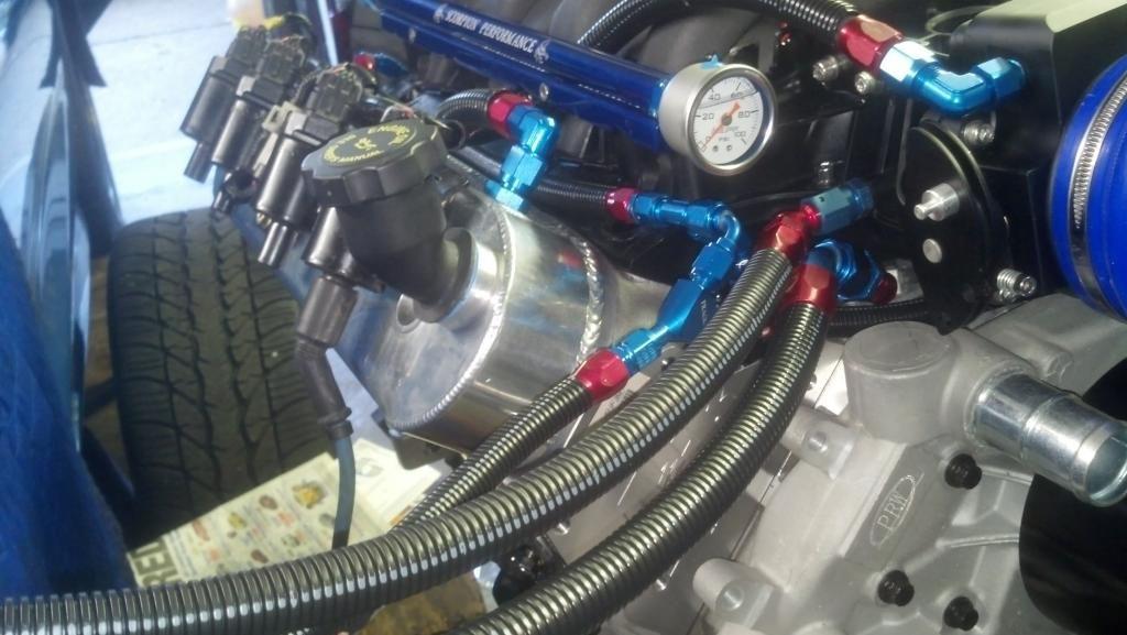

I don't care to see that big block sitting on the manifold and lines criss-crossing all over.
I 90'd off the rears, passed under the injectors, tee'd through the fronts and brought left & right together in a Y-block. All in -4 stuff.

That is a cleaner look Paul.
I will update to black lines when I get a chance.
Kurt use to sell the individual parts so you could make your own lines and route them where you want. For me, up here we are so limited on anything AN I was better off using the kit.
