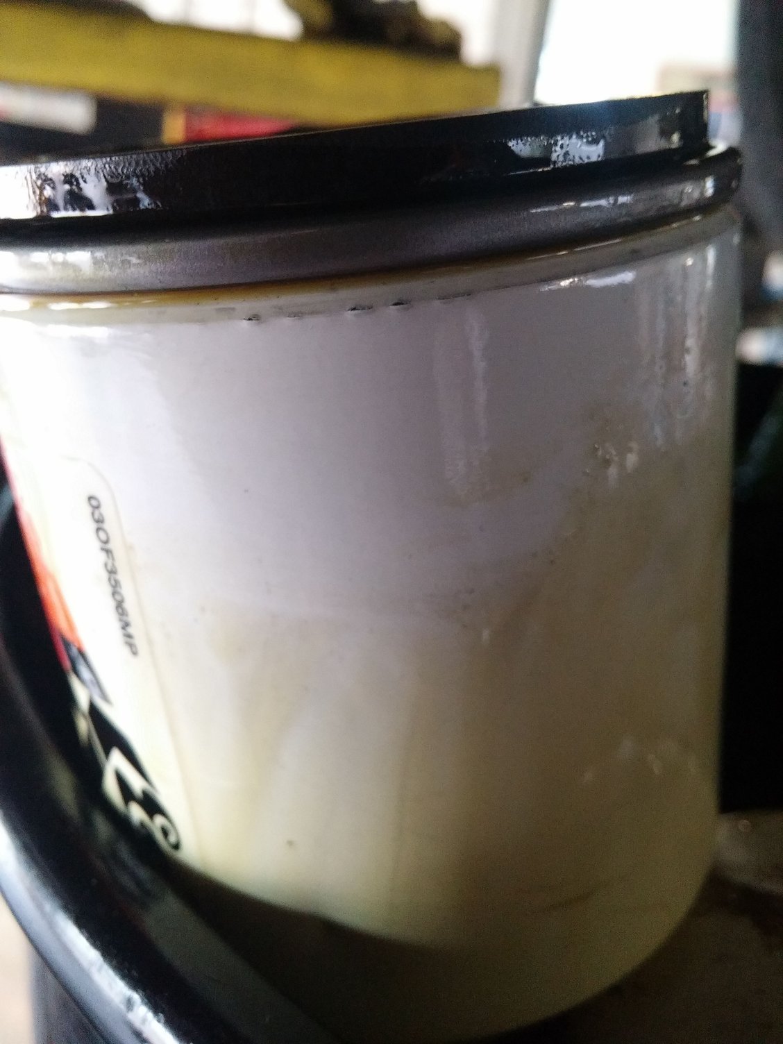

Originally Posted by spawne32
that nut is cast into the housing, i dont see how that could have leaked, can you post some pictures?
Negative. The filter can is drawn into shape from a flat disc of sheet metal. The "nut" is stamped from sheet metal. In this picture, you can see the small spot welds around the nut stamping that attaches it to the can.

Working on an 03 Tahoe with a 5.3.
Customer says they had their oil changed recently at another shop.
It was leaving large puddles of oil in their driveway.
So they bring it into my work, I get on a lift, and the filter is covered in oil.
Its a KN obviously, by that pic.

It was on very tight when I checked....I had it towed to a shop thinking it was the RMS (170K); there was oil everywhere underneath the car. The mechanic says the filter failed internally; there's a tiny "safety wire attachment" hole drilled into that 1" nut at the bottom of the filter....that is where oil was pissing out like no tomorrow.
Here's yet another thread from some subuaru guy about this known issue with their shoddy spot welds inside the filters causing huge leaks from the 1" nut .
http://www.iwsti.com/forums/2-5-lite...il-filter.html

I'm wondering if it wasn't tightened by using that nut, and pulled the spot welds loose then,
I would imagine the "nut" on the bottom is used for removing only.
