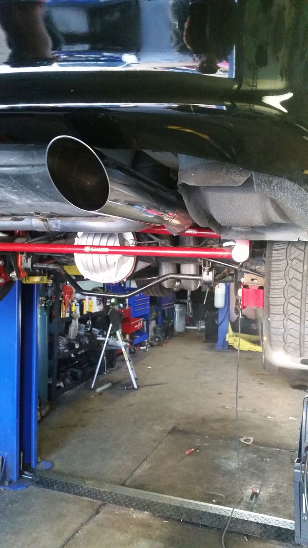

I just had dual exhaust installed on my Camaro. Speed engineering headers, x pipe, and 2 flowmaster 10 series mufflers. Love the sound at idle and when I get on it, my concerns are the slight drone at cruising and how damn loud it is. Anything i can add to it to quiet it down and get rid of some of the drone? Or is there no way and I need to replace the mufflers?

Old Mar 13, 2016 | 08:12 AM
brewcrew011's Avatar
Joined: Jan 2015
Posts: 69
From: West Allis WI
1st pic is headers and flowmasters, second pic is farther down from the first pic with the x pipe then over the axle, third pic is after the axle to the tips. So it goes headers, flowmasters, then x pipe, then out

The mufflers would be far more effective at attenuating drone if they were at the back of the car and were absorption style mufflers. Their current location also has a negative effect on your ground clearance, which you are going to realize at some point while driving the car.

Muffler placement is not ideal imo. I would put resonators in place of the mufflers to gain some space up front, and try to put those mufflers after the axle... This might quiet it down and kill some drone.

The 10's didnt fit after the axle, seemed like the only place to put them were up there. Ground clearence actually is very good, headers are the lowest part of all of it. What brand of resonator would be good for this? And would it quiet it down or just clean up the drone?

Don't use the 10s get rid of them , bad placement . Second it appears the intermediate pipes coming off your mufflers are double 90* this does not help either . I would recommend redoing those also. I have to commend you for going the custom route, but you need a plan . Come up with a design for the complete exhaust system. If you go to the TDs exhaust sticky here there are probably a hundred pics of TDs . or just take a look at Kooks TDs is great designed system, not that should try and copy it but if yours is radically different , rethink what your doing.
