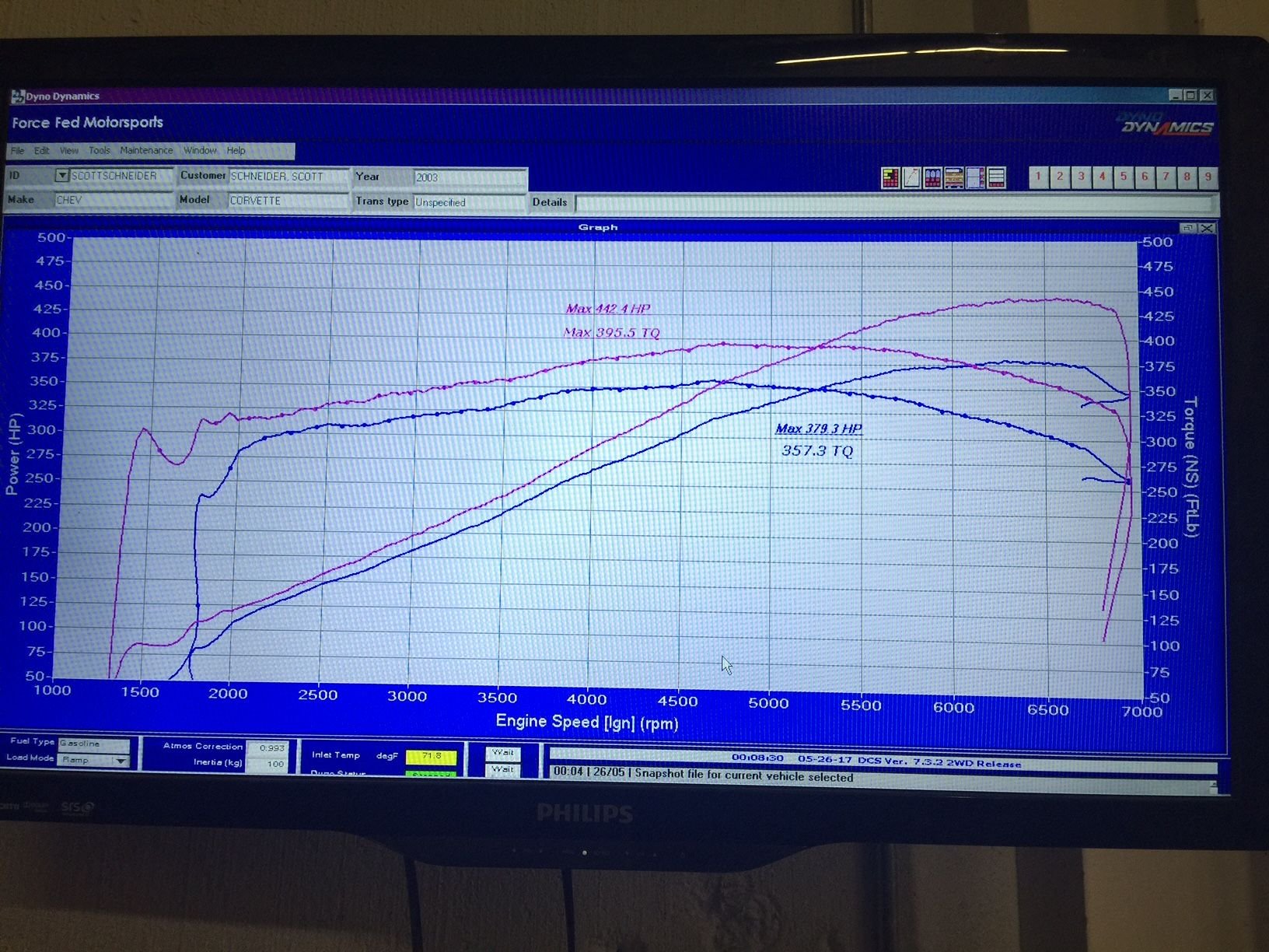

Check out what I put down on my 2003 Z06 with bolt ons. A ported FAST 102 will really help carry out the power where you want it. Didn't lose TQ like people claim.
Link to build
