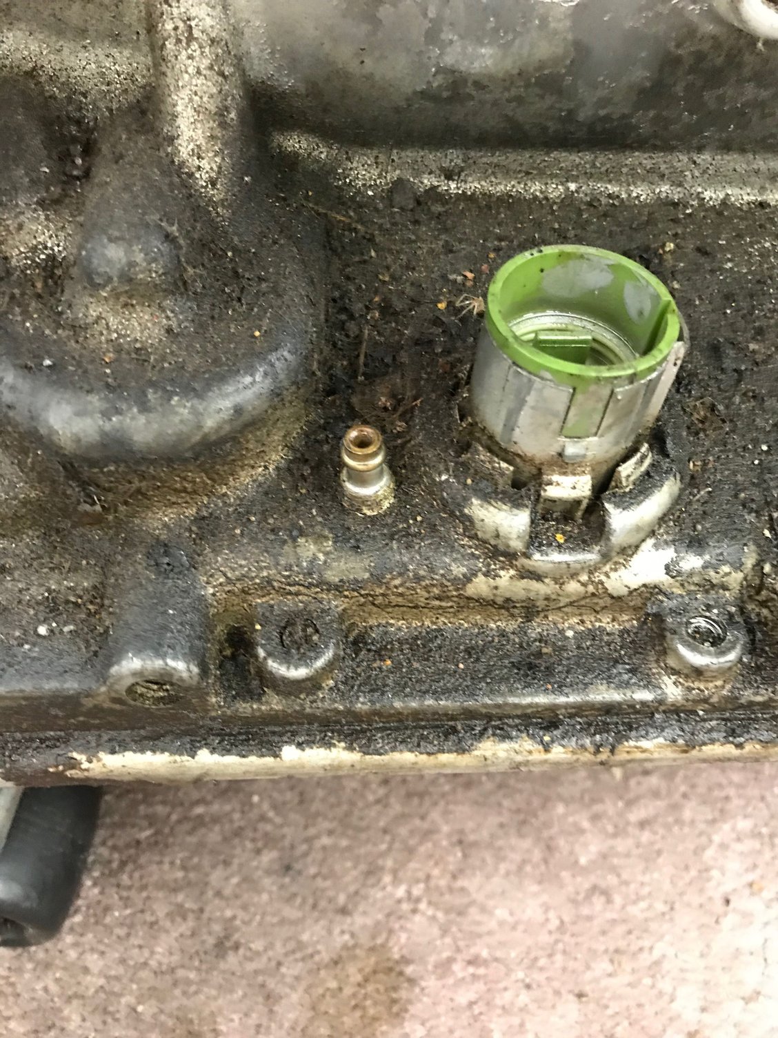

I couldn't believe some of the stuff he had wired up all crazy, and then I saw that. I'm gonna try to attach a picture.
Old Mar 9, 2018 | 03:03 PM
Jamesyyyy's Avatar
Joined: Feb 2016
Posts: 16
From: Birmingham, AL
Connected here on the tranny

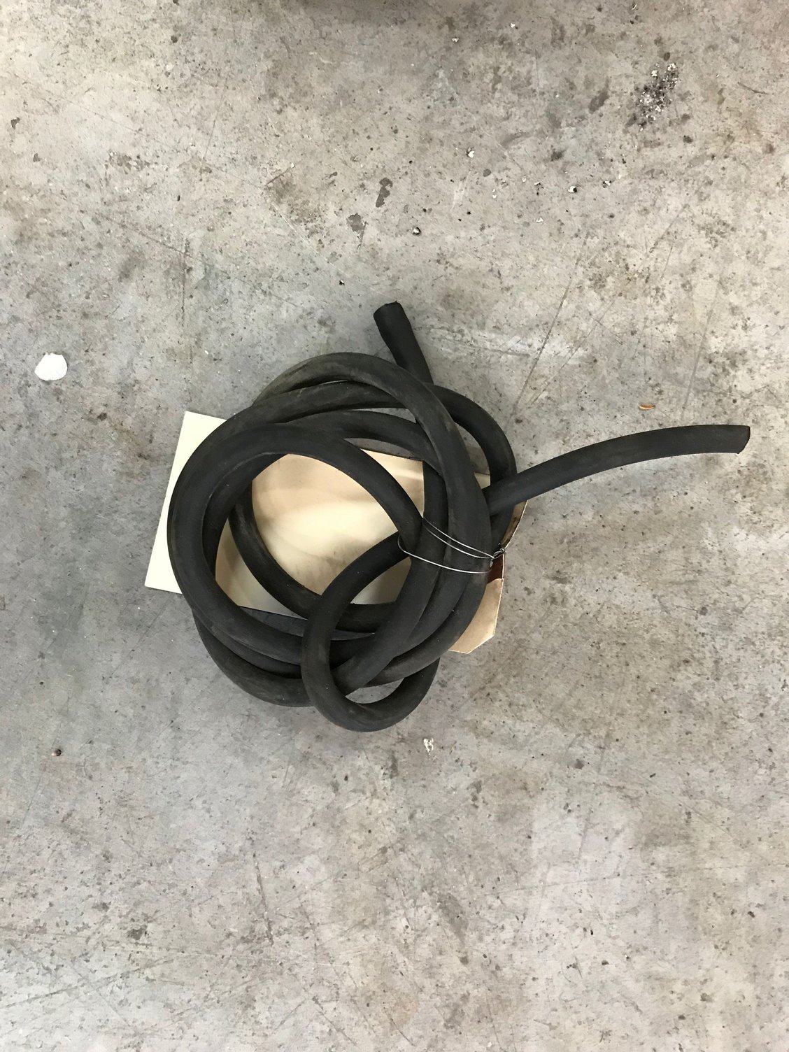

And this was the hose running from the T on the vacuum line to the brake booster

That would be correct for the TransGo 4L60E-A shift kit.
